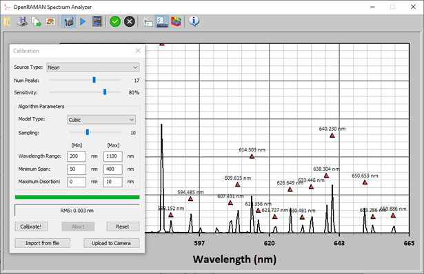

The software, which was initially modest, has grown into a fully functional program suite that covers most of the features traditionally implemented in commercial spectroscopy software. It includes single and live acquisition of spectra, loading/saving and export to clipboard, filtering, baseline removal and an automated calibration algorithm that I specially designed for the occasion. A screenshot of the software performing a calibration is shown in Figure 1.
Figure 1 – Spectrum Analyzer software screenshot

As explained above, the software also features an automated calibration procedure. You simply measured the spectra of a Neon or Argon-Mercury lamp, give the number of peaks that appears on screen and click on the “calibrate!” button. The algorithm is extremely robust to missing peaks and converge to a solution within a few seconds (4 seconds on my super-old laptop). By default, the algorithm will look on a very broad range of parameters, which basically cover the whole visible region of the spectrum, but advanced user can also tune the settings when necessary.
