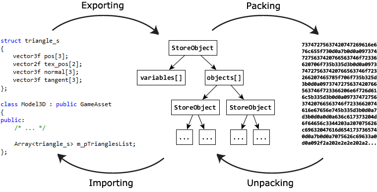

The global mechanism is represented on Figure 1.
Class instances (objects) have dependencies in both the vertical (is-a) and horizontal (has-a) domains. We call the former inheritance, or parent-child relations, and the latter are variables. Variables can be elementary types (such as integers, floating point values, characters…) but they can also be other class instances which have their own dependencies. Here, I will call elementary types dependencies variables and class instances dependencies objects. The difference is more than semantic because variables and objects do not implement the same storing mechanism.
Still on Figure 1, exporting and importing class instances refers to transforming the objects data to a generic structure that I call a store object. Store objects is a copy of the internal content of a class instance data but it does not care about what the class is trying to achieve. You can see them as abstract data.
Store object contains two lists: one for all its variables and one for all its objects. Because object dependencies are ultimately store objects themselves, we end up with a tree structure.
The advantage of copying each object data into a generic structure is that we can handle the data in an easier way to prepare it for packing and unpacking operations. Packing converts store objects to a stream of bytes and unpacking convert a stream of bytes to store objects. Once you have a stream of bytes you can save them to disk or send them to your networking applications. Here, I have focused on storing the data on disk.
We will now focus on each of these steps individually and then discuss how the various processes can be automated before moving to some examples.

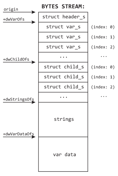

The idea behind data packing/unpacking is that you collect all the memory and push it to a bytes stream. I like to organize my packed data as distinct bins which can be accessed by known offsets such as represented on Figure 2.
The various structures hold the information as indices and byte offsets. For example, to write a string, we first insert the string data into the “strings” bin and then refer to it as an offset from the origin. The major advantage of organizing the bytes streams that way is that it makes unpacking very straightforward:
struct header_s { dword dwIdent; word wChecksum; dword dwSize; word wNumVars; word wNumChildren; dword dwTypeNameIndex; dword dwClassNameIndex; dword dwVarNameIndex; dword dwVarOfs; dword dwChildOfs; dword dwStringsOfs; dword dwVarDataOfs; static const dword IDENT_VERSION = 'ST00'; }; struct var_s { dword dwTypeNameIndex; dword dwClassNameIndex; dword dwVarNameIndex; dword dwDataIndex; dword dwDataSize; }; struct child_s { dword dwDataIndex; dword dwDataSize; }; size_t StoreObject :: unpack(byte *pStream, size_t nSize) { if(nSize < sizeof(struct header_s) || pStream == null) return 0; struct header_s *pHeader = (struct header_s*)pStream; if(pHeader->dwIdent != header_s :: IDENT_VERSION) return 1; if(pHeader->dwSize > nSize) return 0; word wOldChecksum = pHeader->wChecksum; pHeader->wChecksum = 0; if(checksum(pStream, pHeader->dwSize) != wOldChecksum) return 1; struct var_s *pVars = (struct var_s*)(pStream + pHeader->dwVarsOffset); struct child_s *pChildren = (struct child_s*)(pStream + pHeader->dwChildrenOffset); char *pStrings = (char*)(pStream + pHeader->dwStringOffset); byte *pData = (byte*)(pStream + pHeader->dwDataOffset); this->m_sVarName = String(pStrings + pHeader->dwVarNameIndex); this->m_sTypeName = String(pStrings + pHeader->dwTypeNameIndex); this->m_sClassName = String(pStrings + pHeader->dwClassNameIndex); for(word wI=0;wI<pHeader->wNumVars;wI++) { struct var_s *pVariable = pVars + wI; addVariable(pData + pVariable->dwDataIndex, pVariable->dwDataSize, pStrings + pVariable->dwTypeNameIndex, pStrings + pVariable->dwClassNameIndex, pStrings + pVariable->dwVarNameIndex); } for(word wI=0;wI<pHeader->wNumChildren;wI++) { struct child_s *pChild = pChildren + wI; StoreObject *pObject = new StoreObject(); if(pObject == null) continue; if(pObject->unpack(pData + pChild->dwDataIndex, pChild->dwDataSize) != 0) this->m_pChildren.add(pObject); else delete pObject; } return pHeader->dwSize; }
The header keeps important information such as where does the bins begin in the bytes stream but it also contains an identification field and a checksum field. The role of these is to guarantee that we are importing genuine data. You can use the following checksum function which is adapted from the TCP/IP protocols and can therefore be trusted as a good but fast checksum procedure:
word checksum(byte *pStream, size_t nSize) { word wRet = 0; word *pWords = (word*)(pStream); while(nSize > 1) { wRet += ~*(pWords++); pStream += 2; nSize -= 2; } if(nSize == 1) wRet += ~(((word)*pStream) << 8); return ~wRet; }
Once we have validated the data, we locate the bins and start reading all the variables and children objects to restore them as StoreObject objects.
