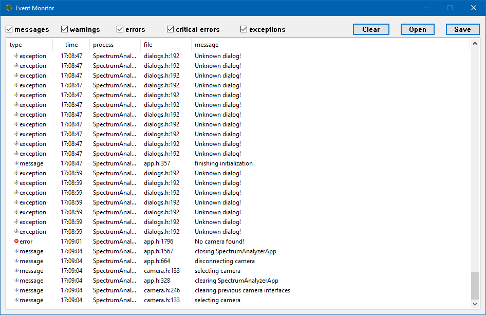

Briefly explained, compatible software that you develop will use a mechanism to send messages to the EVEMON.EXE program which will then show them in a list format that you may then export for later analysis. When someone is experiencing troubles running your software, just ask them to create a report using the EVEMON.EXE program so that you can track what went wrong. A screenshot of the program running is given in Figure 1 where you can see it monitoring the SpectrumAnalyzer.exe program of OpenRAMAN.
Figure 1 – EVEMON.EXE running
The program will discriminate between several types of messages including debug messages, warnings, errors, critical errors and exceptions. The debug message shall be used to give an overview of the major steps the application is performing like when it starts up, save a file, connect to a camera… The warnings, errors and critical errors message will inform of potential troubles happening in the program. Finally, the exceptions type will show you all exceptions that were thrown in your program.
