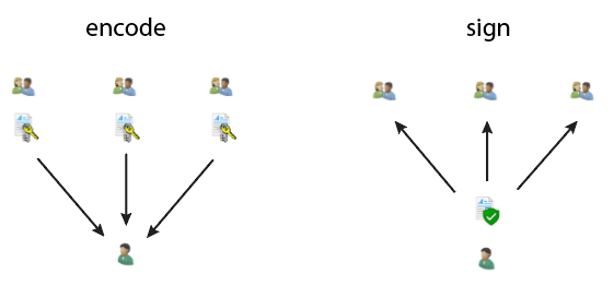

Cryptographic systems are known to be useful to cipher information so that no one else than you and your friends can read the message. A less known application to cryptography is the ability to sign a file, proving that you generated that particular file and that it was not modified by a third party. RSA was the first cryptosystem designed to accomplish both of these operations. The two mode of operations are briefly represented in Figure 1. On the left hand-side, users send a secret message to you and on the right hand-side, you send a message to people that contains a proof that you did write that message and it was not crafted by a third party.
Figure 1 – Cipher and Signature operation of RSA cryptosystem (icons from Microsoft Windows)
In RSA cryptography, you generate two keys: a secret private key that you keep for yourself and a public key that you broadcast to the world. Using your public key, people can send you encoded message that only you can read using your private key. And using your private key, you can encode message that only your public key can decode. The public key cannot be used to decipher a text that was encrypted using the public key which makes the system safe. One big advantage of this private/public key mode of operation is that you don’t have to worry anymore on the exchange process of the key because the public key cannot decode messages that other people will send you.

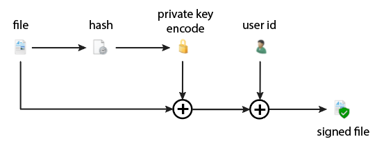

In practice, since encoding using the private key takes time and that in our system everybody has access to the public key, it is not necessary to encode the full data using the private key. Instead, a hash digest of the data is generated and that hash is encoded using the private key. That encoded message digest is sent along with the data such that anybody receiving the message can decode the digest, recompute a hash and verify that the two corresponds. If the two hash differs, it means that the data has been modified by a third party in-between and should not be trusted. The signature of a file is illustrated in Figure 2.
Figure 2 – Signature of a file using a hash function (icons from Microsoft Windows)
In theory any checksum function can be used to produce the digest but best practice is to use what is known as a secure hash function. These message digest functions were specially crafted to avoid attacks that would aim at generating a fraudulent message that would have the same hash as an original, safe, message and substitute the safe data with the crafted packet, leading the recipient of the message believe that the data is authentic. Here, I implemented the SHA-256 algorithm from the step-by-step description available on Wikipedia.

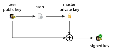

So far, any user can create a key and associate whatever name he wants. It is not because the public key says that the user name is Barack Obama that the file was truly made by the ex-president of the US. All you know is that you have some file sent by a user who pretends he is Barack Obama.
This is where the concept of certificate comes into play.
Imagine you have a few users (at least one) who the software trusts. Their public key is made available to the public by their Internet website and are hardcoded into the software. These are known are certificate authorities and their key are called master keys. The role of the certificate authority is to sign user’s public key with their own private master key. To do so, users must register to the certificate authority by presenting an ID or any other document that proves they are who they pretend to be.
Once you, the final user, receive a signed file you can then check if the accompanying public key was signed by one of the known certificate authorities using their master public key. If it does, then you know that the user XYZ is who he pretends to be. If not, you just know that you are talking to some dude who pretends to be user XYZ. If the file is not signed at all, you have no information about its author.
The overall process of certificate authorities is represented in Figure 3. It is actually nothing more than signing a key file using a special private key owned by a third party (the certificate authority).
