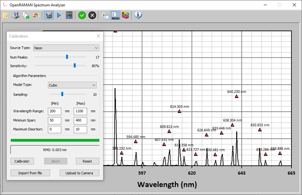

Figure 1 shows a screenshot of the program performing a calibration on a Neon spectrum.
Figure 1 – Screenshot of the program performing a calibration on a Neon spectrum
