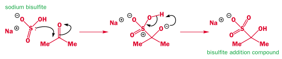

The reaction mechanism is shown in Figure 1. The reaction is reversible using dilute acid which makes it very handy for purification purposes.
Figure 1 – Sodium bisulfite addition to acetone. From “Organic Chemistry” by Clayden, Warren, Greeves and Wothers (ISBN 978-0199270293).
With Raman spectroscopy, you actually look at the geometrical structure of the various groups and bonds of the molecule. So you can see the carbonyl with its planar sp² structure connecting a carbon to an oxygen, the ending tetrahedral methyl groups or, after reaction, the new tetrahedral structure containing both a C-S bond and a C-OH bond. When you have a reaction like the one of Figure 1, you can therefore compare the spectra of the reactants (acetone and sodium bisulfite in Figure 1) with the spectrum of the product and you should be able to see the changing groups/bonds.

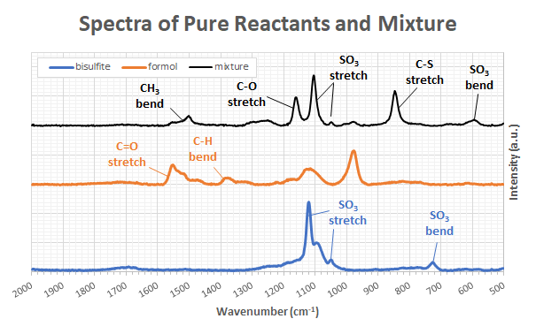

This is exactly what I did using formaldehyde and sodium bisulfite. I first recorded the spectra of the separate (pure) compounds and then the spectra of the mixture for comparison. The results are shown in Figure 2. I also tried to label the various peak to my best but please note that I don’t have a lot of experience in peak labelling and that the exercise is extremely difficult so don’t take it for granted! The labelling was done using previously annotated spectra of similar compounds (from Peter Larkin book on IR spectroscopy). Labelling is a dangerous exercise as you may be tempted to confirm you’re a priori expectations and miss the correct explanation… So please big care if you copy this to your own work/master thesis etc. I cannot stress it even more :)
Figure 2 – Experimental results for a bisulfite/formaldehyde addition
Several things can be noticed in Figure 2. First the carbonyl peak of the formaldehyde completely disappeared from the mixture. Second, C-O and C-S stretch peaks clearly appeared in the mixture as suggested by the theory. Among the weak peaks, we can notice the disappearance of the -CH2 aldehyde bend in profit to a CH3 bend which is also in agreement with the expectations and we also notice a displacement of the SO3 bend probably due to the proximity of the carbon centre. I was not able to explain the two unlabelled peaks from the formaldehyde despite my best efforts.
Retrospectively, choosing formaldehyde might not have been the smartest choice. I initially chose it because it would have very few peaks (it is a very simple molecule) which would ease my comparison since I don’t care about the peaks that do not change. On the other hand, formaldehyde is pretty reactive as it tends to decompose or react with itself in the presence of minute traces of impurities and my bottle was pretty old (although there should be a small bit of methanol into it to stabilize the solution).
Nonetheless, there is no doubt that a reaction took place since the spectra from the reactants differs so much from the spectrum of the mixture. And since most of the spectrum of formaldehyde is given by its carbonyl (recall that formaldehyde is basically just a carbonyl with two hydrogens), it means that the carbonyl disappeared in the mixture. Furthermore, the labelling seems to confirm the theory of the addition as represented in Figure 1. Even if the labelling was imprecise here, there is obviously no reason to doubt the reaction mechanism of Figure 1 as it a well-known reaction in organic chemistry. The aim of this post was of course not to prove any chemistry here but simply to illustrate how OpenRAMAN can help for these kind of tasks.
