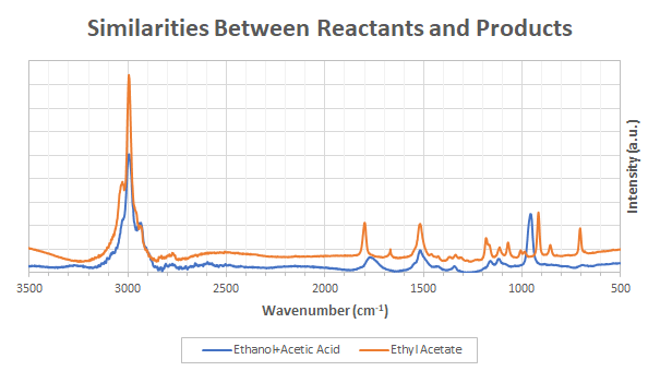

One of the challenges of resolving the various compounds in the esterification process is that the ester (the product) does not differ a lot from the reactants (mixture of acetic acid and ethanol) as most of the chemical bonding are conserved. The few bonding that changes are the -OH in the reactants and the C-O-R’ formed by the ester. In Raman spectroscopy, -OH are almost invisibles and we therefore expect very few changes in terms of number of peaks. On the other hand, the positions of the peaks are expected to shift slightly due to the modified structure of the molecule but this is a second order effect.
Experimentally, the spectra of pure ethyl acetate, ethanol and acetic acid were measured. The difference between the product and reactants spectra are shown in Figure 2. As expected, the two spectra are very similar.

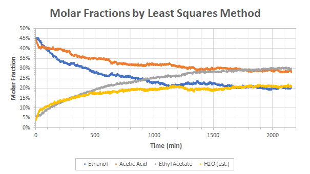

The raw data obtained from the least square method plus the heuristic for the water is given in Figure 3. The trends observed are the expected ones: ethyl acetate and water increase over time while acetic acid and ethanol decreases. All the values reach a non-null steady state that is bound by the equilibrium constant of the reaction.

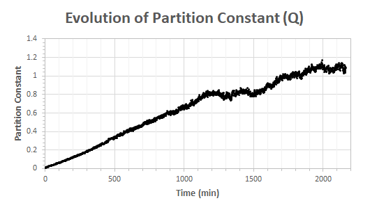

Plotting the partition constant vs. time for the data of Figure 3 gives the results of Figure 4. If we assume that the compounds have reached equilibrium after 2000 minutes, Keq would be about 1.05 for this reaction.

The results of Figure 4 are a bit off from the literature which lists a value of 3.92. It is nonetheless not so bad approximation knowing that chemical reactions have equilibrium on scales larger than 1010! Two hypotheses can be made to explain this difference:
(1) The reaction may have not achieved pure steady state. This is possible looking at Figure 4 but we are probably not so far from equilibrium when we look at Figure 3.
(2) The molar fractions of Figure 3 are not correct. This is more than likely because we expect that the same number of moles of ethyl acetate and water should be produced and that the same amount of ethanol and acetic acid should be consumed but this is not the case in Figure 3. Both the production and consumption of ethyl acetate and acetic acid seems to be under-estimated compared to water and ethanol contents. I don’t think this could be explained by a discrimination issue between acetic acid and ethyl acetate but rather by the fact that the data returned by the least-squares methods are not molar fractions but a different numeral that is more or less related to but not strictly equal to molar fractions. I still have to investigate on this.

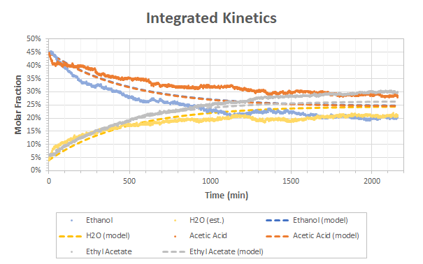

Knowing that there is some discrepancy between the observed fractions and the reality, I performed a fit of the kinetic model on the data of Figure 3 to find the value of k’1 (since k’2 can be found from Keq). I obtained the value 0.0021 min-1 and 0.0019 min-1 respectively. With an initial number of moles n0 of 0.312 mol and a volume of 14 ml, the kinetics constants are found to be k1=7.8×10-4 M-1s-1 and k2=7.1×10-4 M-1s-1. I don’t have figures from the literature to compare these values unfortunately.
The fits are shown in Figure 5.
Figure 5 – Integrated kinetics using the presented model
Although the fit is not perfect, the trend is relatively good and the order of magnitude of the reaction rates k1 and k2 are certainly correct.
