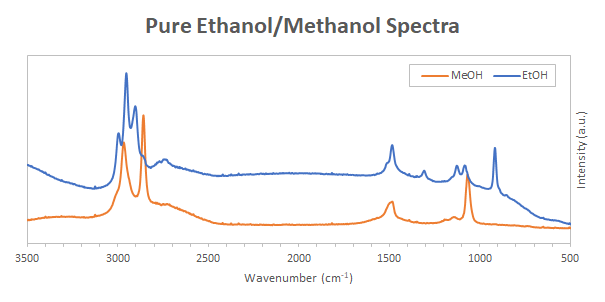

Although the chemical behaviour of the two molecules are nearly identical, they have different vibrational modes due to the presence (or absence) of the -CH2- group. This difference in vibrational modes are accessible in Raman spectroscopy and the Raman spectra of the two molecules are shown in Figure 2.
Figure 2 – Raman spectra of Methanol (MeOH) and Ethanol (EtOH)
The two Raman spectra differs enough to attempt an experiment! This is precisely what I have done here.

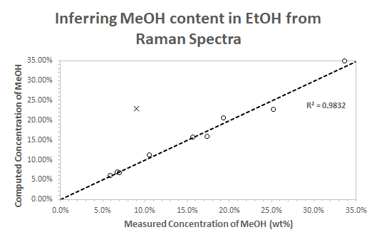

In the experiment, I have measured the spectra of pure ethanol and pure methanol as well as the spectra of 10 mixtures for which I knew the mix ratio in weight% using a precision scale. The idea is to plot the value of α against the known weight% and to check the trend and error.
The value of α can be computed using a least-square approach from the experimental mixture spectrum smix,exp(λ):

When performing the experiment, I however ran into a problem with fluorescence. If you look at Figure 2 you can see that the two spectra have different backgrounds (which are supposed to due to fluorescence). Interestingly, I noticed that mixture of methanol and ethanol exhibited even more fluorescence! The presence of this odd background ruined the theoretical model of the mixture, making the parameter α unmeaningful. To solve this issue, I tested several methods including bspline background removal, bandpass filtering and gradients fit. The best results were obtained by a bandpass filtering of 3-15 px (6-28 cm-1) of all the spectra.
The experimental results are shown in Figure 3 along with the y=x line. One of the experimental points had to be removed (marked with a cross). It is unclear what went wrong with that point.
Figure 3 – Experimental results
From the experimental results, a simple y=x model gave 0.6% median error while a best-line fit using the leave-1-out method gave a 0.8% median error. The trend is clearly linear and we can therefore make the conclusion that α correlates extremely well with the weight% of methanol. Concerning the 0.6% error, it corresponds to the precision at which I performed the dilution. Although my scale has a 5 mg accuracy (which would already give a 0.4% error in this experiment), I noticed that I did not always emptied the vial fully and from experiments to experiments and I had to re-zero my balance with weight differences on the order of 15-20 mg. This gives an estimated dilution error of about 1-1.5% which is on the order of what we observe on Figure 3.
The results are therefore extremely encouraging as we have proven that our DIY Raman setup is able to quantify amounts down to 1% or less of methanol in ethanol reliably. The method is probably more precise than that and our conclusions are limited here by the accuracy at which I performed the dilutions. Nonetheless, this is extremely good results!
