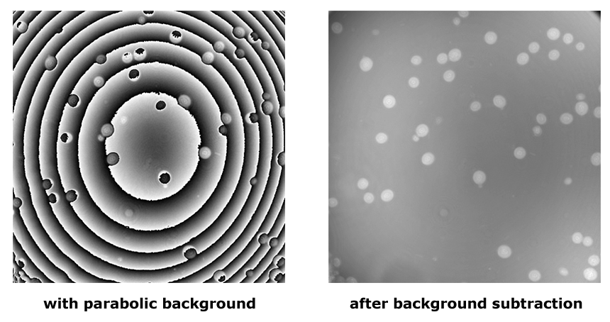

Imagine you have some data with N points representing something of value. It can be 1-dimensionnal, like in a spectrum with wavelength-vs-intensity (y=f(x)) data, 2-dimensionnal like an image (z=f(x,y)) or n-dimensionnal to generalize (y=f(x0,…,xi)). The dimensionality of the problem is not an issue and you can always think about your data set as ‘N’ individual points. You would now like to fit a model on this data set because you know that it adequately represents your data. For instance, during my PhD thesis I was working a lot on holograms that had a parabolic phase offset due to an off-axis configuration. That offset had to be removed to leave only the phase of the sample being studied. Figure 1 shows an image taken during my PhD with yeasts cells with (left) and without (right) the parabolic background. The corrected image allows an effortless observation of the cell details.
Figure 1 - Parabolic background subtraction in holograms

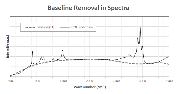

Before we end, I would like to cover one special case which is the background removal of Raman spectra as presented on Figure 2.
Figure 2 - Experimental spectrum and fitted background
The basis I have used here are 3rd order b-splines with 6 knots producing a total of 6 functions with 6 parameters to fit. The internal details of b-splines functions are not important but you can see them as local polynoms that merges successively. Advantage of b-splines over a a6x6+a5x5+… model is that it is more robust and changes of a parameter value only has local effect on the generated function.
Basically, you can fit b-splines using the same technique as described previously but you will get unsatisfactory results with baselines that will have a tendency to pass through the peaks of your spectrum rather than supporting it. This is particularly evident when you have many intense peaks as they will “lift” the fit from the actual baseline. The solution is to define a curve that sticks to the data from below without ever getting above the experimental spectrum.
One way to achieve this behaviour is by using a custom cost functions such as the asymmetric quadratic function that I used to compute the baseline of Figure 2. The equation of the cost function is
where si is the actual spectrum data, ^ the fitted baseline and σ and the noise floor in the spectrum.
So the idea is to add to the cost function only the points that are below 3 times the noise floor. This will drive the curve to fit the data “from below”.
Unfortunately, we cannot use the previous algebraic procedure to solve such problems. There are different ways to do so but here I used a simplex algorithm (fminsearch in Matlab) to optimize the 6 coefficients. Just be aware that there are other ways to solve the problem.
One last remark concerns the value of σ. You can either use a fixed value that represent the noise of the spectrum (a priori known from previous experiments) or you can guess it from the data. The approach I used here was to initially fit the b-splines using the algebraic procedure, then remove peaks or abnormal regions using Tukey’s fence outliers detection and finally taking the standard deviation from the regions where the fit was more or less correct (the region between 1500 and 2500 cm-1 in Figure 2). This approach has the advantage of also leaving you with an initial guess of the model parameters which will speed up the simplex algorithm.
Spectrum background corrections does not always yield the desired results and you will need to play around with the parameters (number of knots, degree of the bspline etc.) and so I do not recommend it for automated processing of many spectra.
