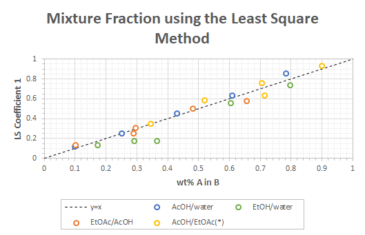

It was therefore logical to study how mixtures of the components involved in the esterification reaction would correlate to the least square coefficients by looking at the weight fraction first. The results are presented in Figure 1. Note that the data of AcOH/EtOAc were taken from the same dilution experiment as the data of EtOAc/AcOH (it is therefore the second coefficient returned by the least square method).
Figure 1 – Correlation between the weight fraction and least square coefficients. (*) From the same experiment as EtOAc/AcOH.
Apart from two points in the ethanol/water dilution, all the points line up relatively well to a direct y=x relationship with a probable error of 3.7% when including all points or 3.5% when excluding the two points of ethanol/water that are a bit off near 30-40%.
Again, a part of the error is due to the laboratory scale I used to perform the dilution. I experienced some weird drift during the dilutions as everytime I emptied the vials to refill them, the zero shifted by -20 mg (so the emptied vial was each time 20 mg lighter than in the previous run – which make absolutely no sense). I don’t know what was causing the effect but I would not be surprised that about 1% of the error obtained was due to that factor.
Also, this time the molecules are very different in terms of scales/weights so there is no reason that they should follow a strict linear trend. My understanding of the phenomenon is that the least square coefficients are proportional to the probability of the laser hitting a specific molecule which would therefore correlates to the volume fraction of each component. However, as we study simple organic molecules, the volume occupied by each molecule is more or less correlated to the molar masses and hence the least square coefficients appear to be correlated to the weight fraction of the components. I would not be surprised if the correlation fails with strange molecules with more heteroatoms than carbon atoms or with heavy atoms like brome. I unfortunately don’t have such chemicals available at the moment for testing.
Nonetheless, translating the least square coefficients to weight fractions seems to be a reasonable approximation unless a detailed calibration is performed.

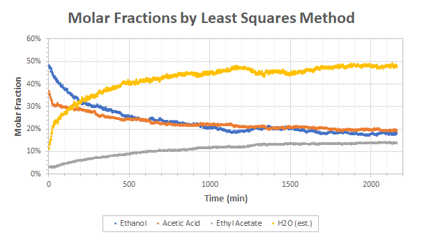

I therefore decided to re-run the esterification analysis using a conversion from the assumed returned weight fraction to a molar fraction. I obtained the results of Figure 2.
Figure 2 – Ethyl Acetate reaction re-analysed using weight to molar fraction conversion
The results were unfortunately not as stunning as I would have expected. The equilibrium constant became a bit better with Keq=2 instead of 3.9 (previous value was 1 so it is already better). Also, this time the production of ethyl acetate matched the consumption of acetic acid and ethanol. Slightly more ethanol was consumed in the reaction (especially at the beginning) but that can probably be explained by partial evaporation of the ethanol as it is the most volatile compound in the mixture and that the reaction lasted for 36 hours. However, the production of water is completely off which makes the kinetic analysis (and to some extend the equilibrium constant) go crazy.
