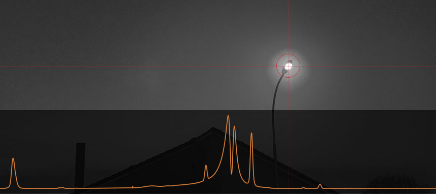

In confocal spectroscopy you image a scene on a camera an analyse the spectrum of a small localized region in that scene. This is represented in Figure 1 where we image a street light and analyse the spectrum at the centre of the image, where the light bulb is. Here, an analysis of the spectrum reveals that the street light is actually a high-pressure sodium lamp.

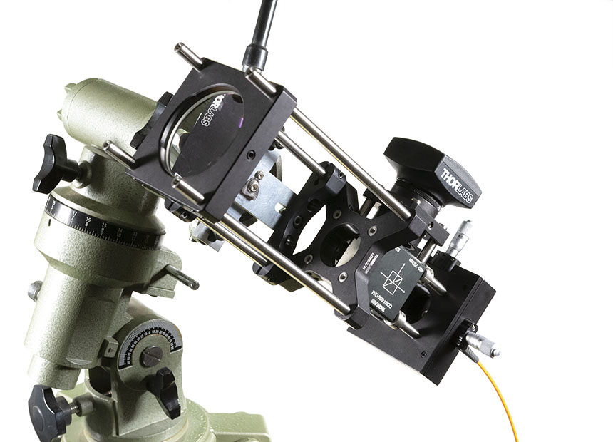

A photography of the setup is given in Figure 2. It is made from Thorlabs cage elements with an imaging lens, a cube beam-splitter, a camera and a fiber port. The image is sampled at the exact centre of the camera over a 50 µm area using a 50 µm optical fiber. This fiber is then sent to the spectroscope that I discussed in my previous post. Note that I also made a custom part to hold the setup on a telescope equatorial mount for easiness of use.

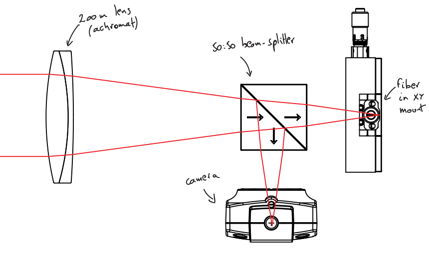

The concept is relatively straightforward once you already know how to build an autocollimator and is detailed in Figure 3.
Figure 3 - Schematics of the confocal spectrometer
The system uses a lens to image the rays coming from infinity (see note below) and splits the signal into two parts using a cube beamsplitter, just like in an autocollimator. Both the camera and the fiber port are placed at the focal position of the lens such that the scene is imaged on both of these planes. So the fiber will collect a small area of the image that can be sent to the spectrometer. The only tricky part here is to align the fiber port with the camera such that we know which part of the scene we send to the spectrometer. I will now detail the method that I used here for the alignment.

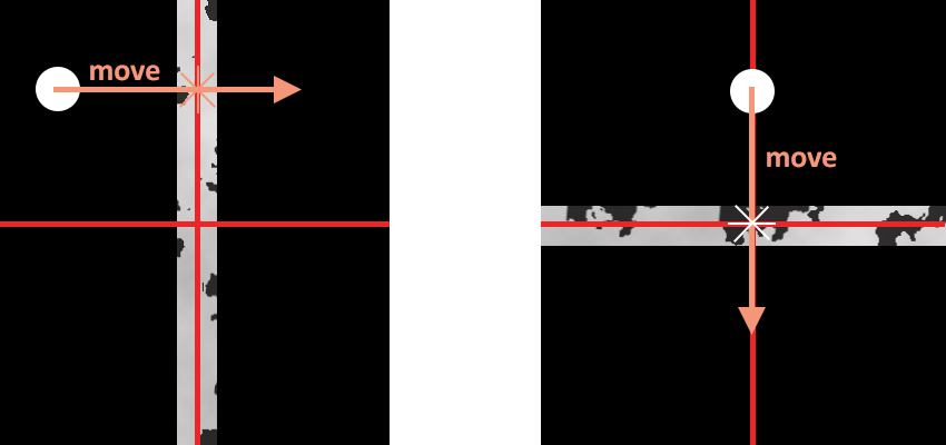

To align the fiber port to the camera I have placed the fiber port on a XY cage-mount-compatible translation stage. I have then imaged (see note below) a 50 µm slit in horizontal position such that it is well centred vertically on the camera. Then, all you have to do is to tune the vertical actuator of the translation stage to maximize the signal in the fiber. You can use a photodetector or your eye, both technique works fine. That way, we know that the fiber port is at the same height as the camera centre. To align the fiber port horizontally now we just turn the slit 90° to align it vertically on the camera. Then, just use the second actuator until you hit the image of the slit. The fiber port should now be perfectly centred relative to the camera. The situation is illustrated in Figure 4.
Figure 4 - Aligning the fiber port with the camera
Please note that when you place a fiber there is no guarantee that the fiber core will be centred perfectly in the fiber port. So, when you place a fiber, it is important to lock it as you do the alignment. If you were to remove the fiber and place it again, there will be no guarantee that the fiber will still sample the camera at the correct position. An improvement might be to use FC/PC fibers because they have an alignment key (to be verified experimentally).
