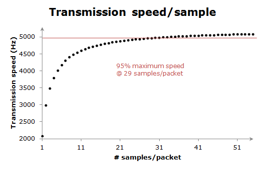

If you look at our basic implementation, you will notice that we make a very bad usage of communication bandwidth in terms of payload data because only 30% of the packet contains the sample data bits (35% when packed). If we could add more samples data into one packet, we could save the identification, checksum and clock field for several samples and increase the information ratio in our packets. For example, if we send two samples in one packet we would have 7-bytes packets containing 22-bits of information (40% when packed); 7-bytes would require 0.67 ms to transfer, about 0.1 ms data conversion (2 samples) and let’s say about 0.015 ms for the checksum which make a total of 0.78 ms for two samples and so an average 2.5 kHz transfer speed per sample! So even without packing, we have increased our theoretical limit speed from 1.8 kHz to 2.5 kHz just by grouping samples into a single packet. The situation gets even better as we keep adding more samples such as represented on Figure 1.
With an infinite number of samples per packet, we reach a limit case where the sizes of the identification, checksum and clock field become meaningless in regards to the samples data. In our case, the limit speed is about 5.2 kHz for 2-bytes data (7.6 kHz when the samples are packed together). It is interesting to note that 95% of that theoretical value is already reached with 29 samples per packet. In practice, we will be limited by the memory of the microcontroller which can be quite small (a few hundred bytes in most cases).

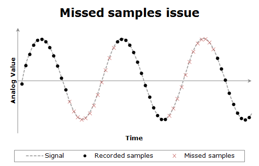

However, this is too beautiful to be that simple because we cannot just acquire N samples and then transmit them since we would have burst of data followed by silences such as represented on Figure 2.
On Figure 2 we can see some signal that is being read by the ADC for 12 samples period which are then send to the computer before the next 12 samples are recorded. During that transfer time, samples are missed. This is clearly something that you want to avoid because it will ruin any Fourier Transform algorithm which requires constant time steps and it is also a rather stupid behaviour for an oscilloscope to miss half of its data!

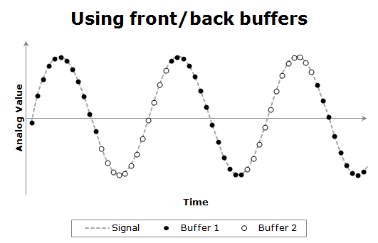

The solution is to use two buffers such that one buffer is filled with data while the second buffer is being sent to the computer. That way, no data are lost. The mechanism is inspired from 3D Graphics technology where awesome 3D scenes are rendered to a front buffer (a copy of your screen display in the RAM) while your screen is actually displaying the content of a back buffer. When the scene has finished displaying into the front buffers, the two buffers are swapped such that the front buffer now becomes the back buffer and vice versa. In 3D displays, this allows prevention of flickering.
I will use here the same terminology, and so a front buffer will be filled with the data being read by the ADC unit while a back buffer loaded with previous samples will be sent to the computer. The only requirement is that the back buffer empties faster than the speed at which the front buffer is being filled (in the other case, we would have a buffer overrun condition). In terms of implementation, we create two buffers (called “Buffer 1” and “Buffer 2”) and two pointers which are the front and back buffer pointers. To swap the front/back buffer, we will then only have to swap the pointers which is much faster than actually swapping all the buffered data. The new acquisition is represented on Figure 3.

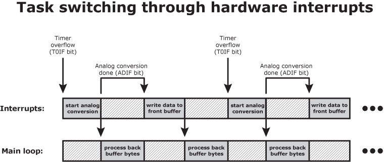

On a computer, we would simply implement this using two threads which would run concurrently in an asynchronous way. However, PIC microcontrollers do not have asynchronous capabilities so we have to use a second trick (which is the core trick of this article by the way). The idea is to use hardware interruptions of the microcontroller to create a task switching pattern.
But let’s first review how interruptions work.
Hardware interruptions (or interrupts) are a mechanism that makes the microcontroller jump to a fixed address when some conditions are met. It’s like when you are making coffee and someone knocks on the door: you stop thinking about your coffee cup and go answer. In the case of the microcontroller, it’s exactly the same but with the microsecond precision. It really jumps to the interruption address at the exact moment the condition occurs, not when it considers that it’s idling or that it is now okay to cooperate.
Microchip has implemented a lot of various interrupt conditions in its microcontrollers such as when data is being received by communication channels, analog conversion is done, the timer overflows, ... Here I will use two of them: timer overflow interruptions and “analog conversion done” interruptions. I will set the Timer 0 to create an interruption every 204.8 µs (1024 cycles at 20 MHz) and launch an analog conversion on that occasion. Then the processor will idle until the analog conversion done interruption is triggered so the data can be filled into the front buffer. The processor will then idle until the next timer overflow occurs. The “idle time” will then be used to send the back buffer to the computer. The mechanism is displayed on Figure 4.
Figure 4
That way, data will be sampled every 1024 clock cycles which makes a 4.88 kHz acquisition speed. Technically speaking it is possible to create a timer overflow interruption at faster rate by setting the Timer 0 to a known value after each overflow (for example to 0x06 to create an interruption every 1000 cycles to achieve a pure 5.00 kHz) but this require a precise control of the instructions time which is difficult to get when using a C compiler. When leaving the Timer 0 as it is, we are guaranteed to have a precisely known clock frequency of 5 MHz / 1024. This is the reason I’ve used a 4.88 kHz and not the 5.00 kHz although the circuit could go that far (which I measured to be true).

Oh, by the way, the signal data from Figure 2 and Figure 3 are actual data got from a 250 Hz sine generator circuit so you can see it’s working pretty fine ;-)
