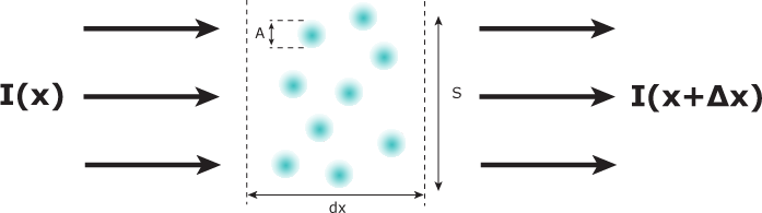

When a light ray hits an atom (or molecule) at the right frequency for a transition to occur, the excited atom (or molecule) has different way to go back to its initial state. Some of them will spontaneously re-emit a photon equivalent to the incoming one, resulting in no overall light loss, and others will decay that excess energy under various forms such as heat. When the incoming photon is not recreated, we say that absorption occurs.
But not all elements have equal probabilities to absorb light. Each absorbing species will present a small absorbing section to the light, A, and a probability, q, that the light entering this volume around the element will be absorbed. Put differently, if we have a light beam of intensity I(x) entering a small sample volume of area S and length dx containing n absorbing species, the amount of absorbed light can be written as the probability that a light ray will enter the sensitive section and that it is also absorbed by the element:
where A/S is the probability that a light ray enters the sensitive area of the element and q the probability that absorption does occur. The situation is depicted on Figure 1.
By generalizing q to make it depend on the wavelength (different wavelength will have different probability of absorption – from 0% to 100%) we have:
Because it is possible to relate the number of element to the concentration times the sample volume (S.dx) we can write:
Grouping the constants A and q(λ) into a new term, ε(λ), called the molar absorption coefficient, we end up with:
This formula simply states that the light loss between the position x and x+∆x is equal to the product of the probability of absorption ε(λ) multiplied by the concentration of elements found in the path length ∆x.

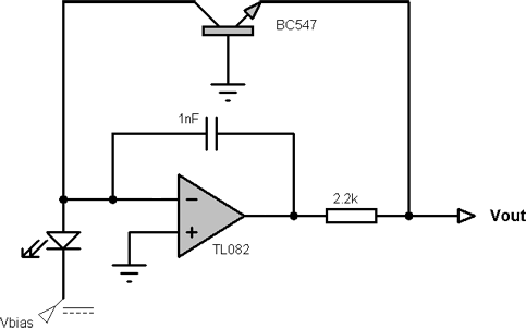

Electronically speaking, there are two ways to get the logarithm of the light falling upon the detector: either we compute it numerically from the linear response of the detector, or we can design an analog circuit that does the conversion before acquisition.
Here, I have decided to use the latter (analog conversion) to avoid the problem with numerical precision using the ADC. The circuit is quite simple and similar to the one used in our previous post on logarithmic amplifier.
A BC547C is used to generate the logarithmic behaviour and the circuit is frequency stabilized by the RC filter (R=2.2kΩ, C=1nF) which has a cut-off of about 7 kHz. This circuit has many disadvantages, such as being sensitive to temperature variation and may have a poor log conformity due to the cheap transistor used (professional log amplifier uses special matched transistors but they are somewhat expensive).
Figure 2 - The log-circuit used in this article.

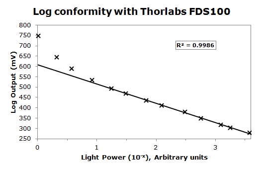

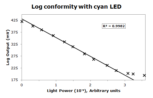

To test the log conformity of the circuit a test was run: a LED is placed in front of the sensor in a dark room and the current in the LED is increased by changing the resistor value connecting it to a battery (battery delivers regulated supplies, unlike transformers which should be stabilized). By using a 1:2 ratio between each successive resistor used, it is possible to cover a large light intensities range.
The results obtained with two different detectors are given on Figure 3 and Figure 4. Figure 3 uses a high quality photodiode from Thorlabs (the FDS100 silicon photodiode) and Figure 4 uses a simple cyan LED from RS Components.
Figure 3 - Thorlabs FDS100 response
Figure 4 - LED response
In both cases the log conformity extends to a bit more than 2.5 decades and can probably be extended to 3 decades or more in the case of Thorlabs FD100. The limiting cases are high light intensities where the log circuit fails due to the transistor emitter-base bias voltage and, at the other range, the very low light intensities that are limited by the dark current of the photodiodes.

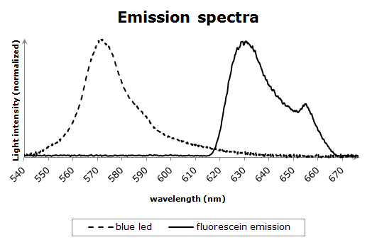

Figure 6 shows the spectrum of a blue LED that is completely absorbed by the fluorescein and the spectrum of re-emitted energy as green-yellow light. By the way, this spectrum was taken using our homemade spectrophotometer.
Figure 6 - Fluorescein and blue LED spectra.
Because fluorescein will convert nearly all the incoming blue light into green light, it is not possible to use the FDS100 photodiode as-is because it will catch the green light that is re-emitted and interpret it as a no-absorption condition. The solution to this problem is generally to place a filter in front of the sensor to remove the fluorescence band but such filters can be expensive. A much neater solution is to use the trick described in this post and to rely on colour LED to perform the photodetection.

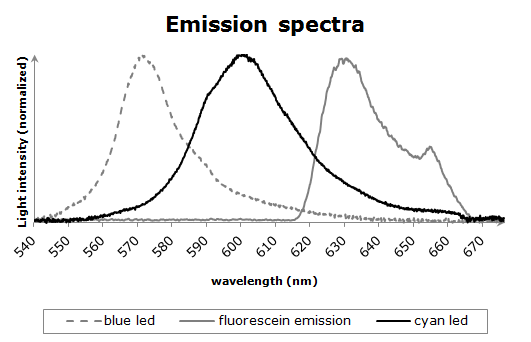

By using a cyan LED of spectrum shown on Figure 7, it is possible to detect only blue light. Indeed, blue light is energetic enough to trigger photoconduction of the cyan LED whereas the green light emitted by the fluorescein will not. That way, we can build a fluorescence sensor from only two conventional LEDs.
Figure 7 - cyan LED spectrum compared to blue LED and fluorescein emission band.

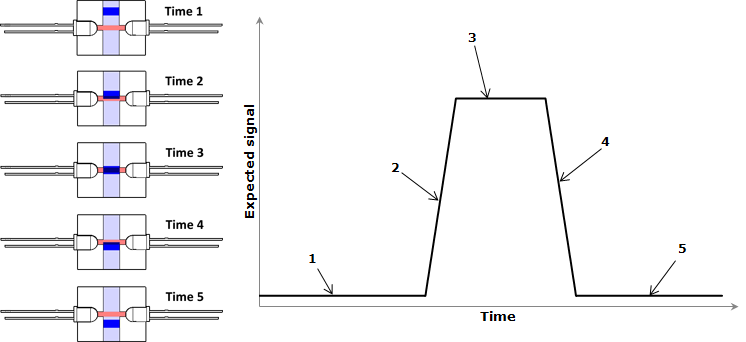

Before testing the sensor it is important to understand what will limit its output range. A mind experiment where a pulse of chemical passes in front of the sensor is shown on Figure 10.
Figure 10 - Mind experiment of a pulse of chemical.
At first, the system records no absorption (time 1). Then, as the pulse enters the light path the signal increase progressively (time 2) until it reaches its final value (time 3). As the pulse exits the light path, the signal decrease progressively (time 4) until the sensor records no more information (time 5).
We can draw two conclusions from Figure 10:
  • Time 2 and 4 introduce a smoothing effect that will be a function of acquisition speed and flow rate.
  • The flow rate vs. acquisition speed should still be fast enough so that we do not miss times 2-3-4.

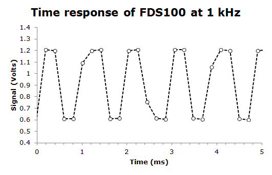

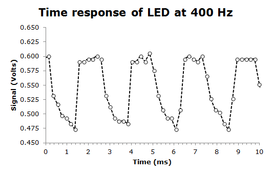

Concerning the system dynamics, the response of the FDS100 and LED with the log circuit was taken using our 5 kHz datalogger and a Protek 9205 square wave generator. The results are presented on Figure 11 and Figure 12 respectively. The FDS100 seems to have a rise/drop time on the order of 0.2-0.3 ms and performs relatively well at 1 kHz. The LED has a larger time response (as could have been expected since we are not using it “the proper way” as it is not intended to be used as a photodiode!) but can still be used at 400 Hz without too much problem.
Figure 11 - Dynamic of FDS100 at 1 kHz.
Figure 12 - Dynamic of LED at 400 Hz.
With these dynamics, and taking N=100 and ∆V=100 µl we find:
Larger flowrates will then require larger pulse volume to keep at least 100 points of data.

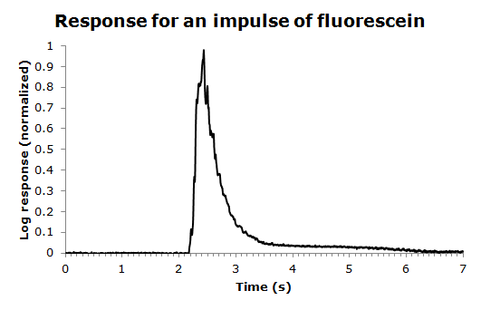

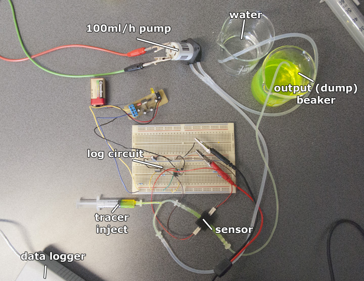

Using these values, a small experiment was set up where a steady flow of water was run at about 100 ml/h through the analysis cell. Then, a small amount (~ 0.2 ml) of concentrated fluorescein solution was injected into the circuit. A photography is shown on Figure 13.
Figure 13 - Experimental setup.
The results of the experiment are presented on Figure 14. This type of curve is characteristic of flows with back-mixing which was indeed observed in the experiment: when the pulse is injected it arrives uniformly at the sensor (with some smoothing) but the end of the tracer pulse start mixing with the liquid flow due to local eddies. Because of that, the concentration of the tracer drops according to a negative exponential, just as it occurs in CSTR reactors (perfectly stirrer reactor). But I will stop writing for now because this will be the content of a forthcoming post :-) So keep updated to know more about chemical reactor and their characterisation!
Figure 14 - Response to an impulse of fluorescein.
