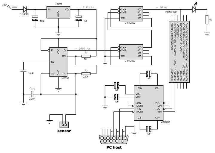

To increase the precision even more, we use an artifice which allows us dividing by 100 the effective period reaching the microcontroller. The idea is to use a 74HC390 counter chip to perform two successive divide-by-ten operations to give a minimum capacitance measurement of 6.5 fF. The complete circuit is given on Figure 1.
Figure 1 - Circuitry schematics.

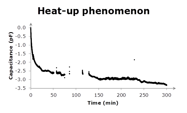

During test, I faced an interesting phenomenon given on Figure 2. It seems that there is a strong modification of the recorded capacitance in the first hour of probe usage which I decided to call capacitance heat-up. It is still not clear why this is happening but it may be due to component reaching a thermal steady-state after some delay. Anyway, as a consequence, I recommend turning the probe up at least one hour before making precise measurements (pF levels) and not trying to measure slight changes (less than 0.5 pF) over extended periods of time as the fluctuation seems to be too high for more precise studies.
