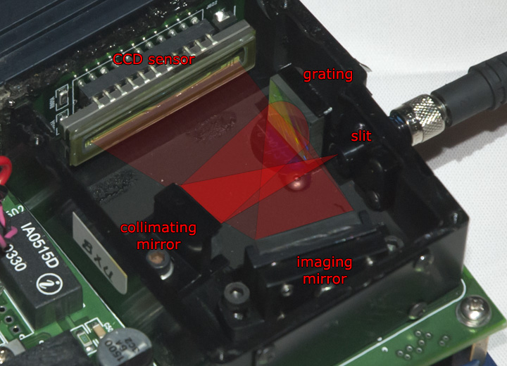

My first trials revealed that the spectrophotometer was blind on a large portion of the spectrum. When opening the unit, I realized that this was due to some plastic scraps stuck on the CCD sensor. After blowing a bit a dry air on it, the whole spectrum range opened to me. The inside of the spectrophotometer (after removing the cover plate) is shown on Figure 1. It is a Czerny-Turner design where the light comes out of the fiber (on the right of the picture) through a SMA-threaded connector. The light passes through a slit (integrated in the SMA connector) and is collimated by a first mirror on a 1800 lines/mm grating element. The light spectrum split by the grating is then imaged on the CCD sensor using a second mirror. All the elements are kept in place by sets of screws that you may loosen to adjust the elements position.
Figure 1 - Photography of the Czerny-Turner implementation
The unit I got was pre-aligned but the 200 nm span was not the one I was looking for (it recorded the blue-green region while my experiments require me to study the green-red region). I then took a few hours to re-align it and play a bit with the Czerny-Turner setup. And believe me, it was a real pain to deal with the alignment procedure even after several hours of practice: the CCD sensor is extremely sensitive and even in a dark room with a piece of clothes on top of my hands I could barely record a non-saturated spectrum. It makes tuning extremely difficult because once the mirrors or the grating are in positions, you have to find the locking screws in the dark hoping that you don’t make any single move on the element you are trying to adjust. And that is the second major trouble with the alignment because any slight variation in the positions of the mirrors will dramatically impair your spectrum. This has probably to do with the fact that the system is not apertured and so very sensitive to focus changes. Finally, don’t even try to change the imaging mirror tilt angle or you will lose your spectrum and spend two hours trying to recover it! The CCD sensor pixels height are extremely small (0.2 mm) and it is very difficult to have an horizontal spectrum that covers the whole sensor area. On that point, the spectrophotometer design I’m using is much easier to align.

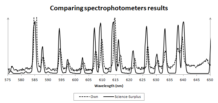

Concerning the spectra, a Neon sample is given on Figure 2 compared to the custom spectrophotometer spectrum region I had on disk. Basically, the two spectra are comparable in terms of resolution apart from a region on the right of the spectrum where the custom version lens begins to introduce aberrations. This is delicate because they are using a 1800 lines/mm grating while my setup used only a 1200 lines/mm grating. In theory the Science-Surplus spectrophotometer should have a better spatial resolution but, in practice, it doesn’t. Even after hours of alignment I did not manage to do any better than this and the fact that Science-Surplus mentions a 1 nm resolution (compared to a <0.4 nm in theory) lead me to think that their setup is working below optimal conditions. Since the alignment does not help and the sensor doesn’t seem to be low-pass coated, I believe that the limiting element might well be the entrance slit.

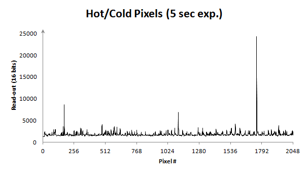

Still concerning the sensor, I have noticed a few hot pixels (see Figure 3) and some disparity between pixel sensitivities. The “noise” you can read on Figure 3 is actually not fluctuating in time but only the difference in sensitivity between the various pixels. I should also mention that the relative peak intensity do not match the result I got from the custom spectrophotometer. Since the sensor seems to have been designed essentially for bar code scanners, you should pay attention to the eventual non-linearity of the response. But since I have already recommended to keep the unit for quantitative analysis, this should not be much of a trouble anyway.
