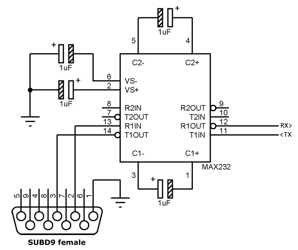

The MAX232 includes a voltage doubler and a voltage inverter to produce levels of about +10V/-10V compatible with the RS232 specifications. Be aware that the chip was not designed to act as a current source and it is then not recommended to use it as negative power supply for other elements such as op-amps. If you need a symmetric power supply, uses a component like the TC962.
If your computer has a real serial port, you will have to use a 9-pin crossed cable also called null-modem cable. These cables invert the RX and TX between their two ends. If you run into problems with data transmission, always check that your cable really is a null-modem one.
