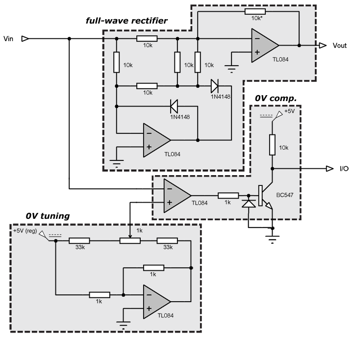

The concept is to use a full-wave rectifier and a voltage comparator to first know if the signal is positive or negative and then get the absolute value of the signal (that is, a -V...+V signal is reflected back to 0...+V). Obviously, this requires using one I/O pin from the microcontroller as input to read the voltage comparator output. The overall concept is shown on Figure 1.

The complete circuit (without the low-pass stages) is given on Figure 2. It is composed of three blocks, namely a full-wave rectifier, a 0V comparator and a 0V tuning unit. The 0V comparator simply uses an op-amp with high gain and a classical NPN transistor to adapt the output voltage for the microcontroller. Because the comparator might have a small dc offset voltage, it is important to be able to tune the 0V position through the 0V tuning circuit which is a simple potentiometer connected to a regulated 5V input with an inverter to create a -5V at the opposite side of the potentiometer. Finally, the full-wave rectifier takes the absolute value of the input voltage to send it to the ADC. All resistors of the rectifier should be matched to a 0.1% to avoid distortion in the output (use an ohm-meter to match resistors from a large batch so you don't have to buy expensive 0.1% resistors). The resistor marked with a * can be changed to set the gain of the circuit. Using a 10 kΩ resistor will set the gain to unity. Apart from the resistor-matching process, it is extremely simple to build and is cheap with its sole TL084 chip.
