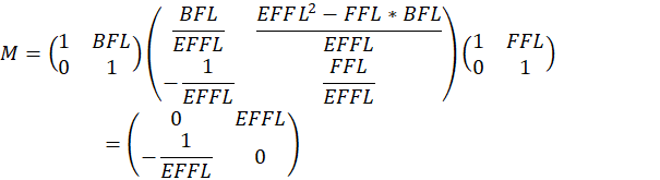

The premises of this post can be found in an earlier article that I posted in 2021. Back then, I showed that optical lenses systems with the object and image planes at the front and back focal length of the system had a very peculiar ABCD matrix. In terms of matrix, this can be written without any loss of generality as
where EFFL is the effective focal length of the system, BFL the back focal length of that system and FFL the front focal length of that same system.

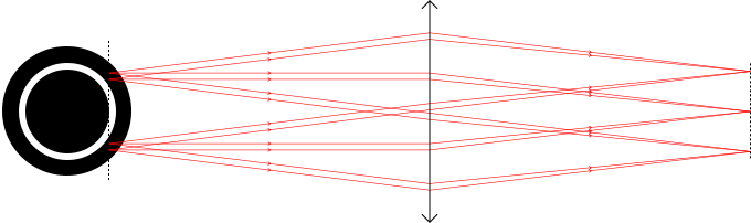

1/ The bright spot aperture, or regular aperture, which is a hole of radius R in a thin sheet of metal. This aperture has the modulation function
The bright spot aperture produces a cone of light with slopes magnitude comprised in the range [0, R/f] as illustrated in Figure 2.
Figure 2 – Bright Spot aperture

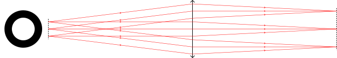

3/ The annular aperture which is a mix of a dark spot aperture of radius R1 and a bright spot aperture of radius R2. Its modulation function is
The annular aperture therefore produces a cone of light in the range [R1/f, R2/f]. This is illustrated in Figure 4.
Figure 4 – Annular aperture

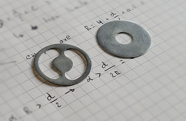

Concerning manufacturing aspects, there are multiple ways to produce apertures but the two main ones I used were (1) machining apertures in sheet metal, and, (2) using chrome on glass targets.
Chrome on glass targets are excellent when you need precise control of the pattern you want to convert to slopes and also allows you to get uniform patterns in the slope space (more on this below) but it can be difficult to achieve high extinction coefficients for the light modulation function and the optical density of the chrome is often limited to OD3 or OD4. This is fine for most applications but needs to be taken into account at system level. Also, producing chrome on glass targets can be relatively expensive for small batches and take several weeks if not months. As an order of magnitude, producing a single 1” target costs somewhere between 1k€ and 3k€ depending on the technology used but the prices can drop rapidly if you group multiple apertures in a single batch.
Machining offers more material choice (steel, gold etc.) and doesn’t suffer from the optical density issue of chrome on glass targets but there are more restrictions on the patterns you can obtain this time. For instance, it is not possible to have free floating features so patterns like the dark spot aperture or the annular aperture will require branches to maintain the central part connected to the rest of the aperture. These branches introduce both weaknesses in the aperture and break the uniformity of the produced slopes. A tradeoff must be found between uniformity of the slopes and strength of the aperture, in particular its response to vibration and shocks.
Nonetheless, a big advantage of machined apertures is that you can easily prototype them using a CNC router provided the features are not too small or too intricate. I even made a web application to generate ISO 6983-compliants NC programs for bright spot apertures and annular apertures. Example apertures made using this program are given in Figure 5.
Figure 5 – Example of prototyped apertures using a CNC router

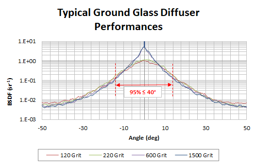

Before we move on to the second part of this post, I need to make a brief comment on the output height of the rays in the system of Figure 1.
Output height is directly related to the input slope at height coordinate r, so, r’=f1u with intensity A(r)*. The illumination extent at the image plane of the system of Figure 1 is therefore limited by how much input slopes we have. Using a diffuser or an integrating sphere, we can generate a relatively homogeneous slope content at each ray position but will be bound anyway to some value. Diffusers are more common but will have Gaussian-like or Lorentzian-like falloffs depending on the grit you choose. Figure 6 lists some typical ground glass performances of Thorlabs diffusers to give an order of magnitude of what can easily be achieved in an optical lab using stock components. About 95% of the emitted energy of the diffusers in Figure 6 occurs within a 40° cone.
Figure 6 – Typical ground glass diffuser performances

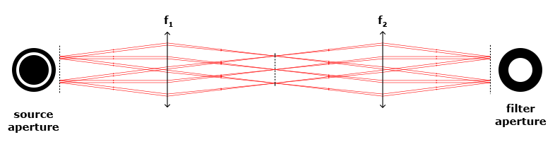

Using the exact same system as the one of Figure 1, we can convert input slopes to output heights. The idea is now to put two systems back-to-back such that we generate slopes using the first system and convert these slopes into height positions using the second system. By introducing another aperture at the end of the second system, we produce a filter. This is illustrated in Figure 7 with an annular aperture as source and a regular aperture as filter.
Figure 7 – Filter using two back-to-back system

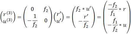

The second system equations can be written as
Looking at the equations above and the schematic in Figure 7, the overall concept might look like we are not doing anything (thinking so would be largely underestimating your guest :)) : starting rays are emitted with modulation A1(r) before being converted into slopes u’=-r/f1 by the first lens, and these slopes are converted back to heights r(3)=f2u’ where they are filtered by the second aperture with modulation function A2(r(3)). Ray starting from position r therefore ends-up at position r(3)=-(f2/f1)r with total modulation A1(r)A2(r(3)). For equal focal lengths (f1=f2), the total modulation is then A1(r)A2(r), the product of the two apertures. For binary modulations (apertures can be only “0” or “1”), this corresponds to the AND combination of the two apertures: the light passes only when both apertures are open. In the system of Figure 7, this never occurs because we chose an annular aperture and a bright spot aperture that mutually excludes each other.
You will insist to know what’s the point in the system of Figure 7. This becomes clearer as we insert in the mid-plane separating the two lenses f1 and f2 a non-refracting object with a small defect as some position h that will refract light according to a function
where the terms u’+α on the right can be thought of as a Taylor expansion of the refraction law and the Dirac function δ(r-h) reminds us that the defect only occurs at height h.
If we insert this equation between the two lenses we get:
and therefore

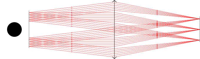

Since we theoretically generate any input slopes u, there will be a specific f1u value that will end up at height h of the defect. Position r(3) is therefore offset by value f2α. The consequence is that some light might pass depending on the aperture’s dimensions and the value of α.

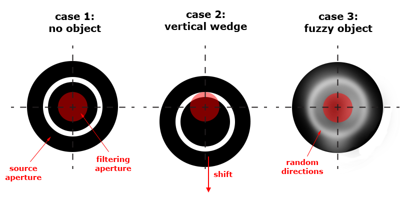

If the highly mathematical aspects of these equations trouble you, consider that the two apertures are in conjugated planes. In the absence of perturbating elements, the first aperture is imaged onto the second one. If they are mutually exclusive (e.g. a dark spot larger than its corresponding regular aperture), no light passes through. However, as you introduce a thin prism in the mid-plane between the two lenses, rays are deviated and the image of the first aperture on the second one becomes shifted. If the shift is strong enough, there will be an overlap between the two apertures that will let some of the light pass. Any elements that depart from a perfect wedge will have the same effect but with a distorted aperture image. This is illustrated in Figure 8.
Figure 8 – Illustration of the effect of different objects on imaging
Figure 8 shows the importance of keeping a tolerance margin in the system such that it stays sensitive to defects in the object but not as sensitive as it would let misalignments of elements or lenses aberrations let light pass through.

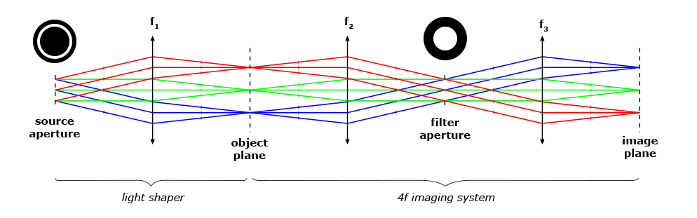

Last but not least, if you look at the system of Figure 7, you realize that it is making an image of the source aperture which is not very helpful on its own. By adding a third lens f3 to the system, we can produce an image of the object at the (final) image plane with magnification ratio f3/f2. This system is built as a 4f system such that we benefit from its metrological properties (bi-telecentricity as discussed here). This might look like a lot of effort to make a 4f system but recall that lens f1 acts as an angular source and that the sub-system composed of f1 and f2 acts as an angular filter. The overall system therefore has more properties than a traditional 4f system.
This last system is shown in Figure 9 and is known as a dark-field imaging setup. It is made such that no light passes through in the absence of scattering objects but is kept sensitive enough such that any defects (scratches, bacteria, lensplates etc.) will let some light pass. The resulting images therefore has an overall dark background, and all the defects pops up brightly on the image – hence the name “dark-field” in opposition to traditional “bright-field” microscopy where the background is illuminated.
Figure 9 – Dark-field setup

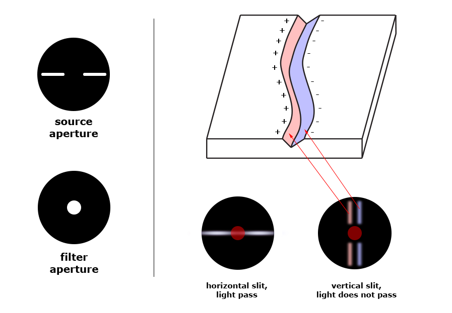

Dark field imaging is only one of the many arrangements of the generic principle illustrated in Figure 9. Up to now, I limited myself to apertures that could be described by radial modulation functions A(r). The principles developed here can however be generalized to any aperture’s shapes.
Let’s illustrate this with the apertures set of Figure 10. Here, light is emitted by an aperture made of two decentered slits and collected by a round aperture. The decentered slit will produce light rays with slopes along one axis only at many different slopes’ magnitudes (positive and negative), controlled by the length of the slit. The condition to capture light is that the object under analysis should refract light rays along the slit direction only. Light refracted to a different direction will not pass through the filtering aperture and won’t yield an image. Depending on the aperture orientation relative to the object, different features will become visible. By mounting this target on a rotation mount, or by placing the object on a rotation table, we can analyze the object features in terms of refracting directions.
Figure 10 – Directional aperture sets
