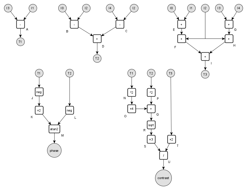

To make the transition, consider that each of these mathematical operations (+, -, /, square, atan, sqrt) actually applies on 2-dimensional images which we can think of as small pieces of independent actions with some dependencies. There is one action to compute I3-I0, another one to compute I0-I2, yet another to compute I4-I2 and so on.
We can represent the dependencies as the directed graph of Figure 1. I added letters to each of the actions to identify them later on more easily.
Figure 1 – Job dependencies structure as a directed graph
From this graph representation, we can already draw some important conclusions. Jobs A, B, C, E and G are independent and can therefore be run concurrently. Same for J and L, N and P etc. On the other hand, D cannot be performed before B and C are done. Similarly, F cannot be performed before E is done etc. To save time, we could therefore run in parallel all the jobs that are independent and wait for their completion before moving on to the next operations. That is specifically the concept of the library that has been developed here.
