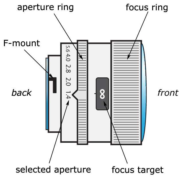

In the case of camera lenses, all the values are clearly labelled onto the lens. A schematic representation of camera lenses is given on Figure 1.
Figure 1 - Schematic of a camera lens.
Your camera lens may slightly differ from the one of Figure 1 but don’t worry, you can still use it. Basically, you will find a focus ring that will change the position of the lens inside the case (take a look at the back of your camera lens while you are turning the focus ring) and an aperture ring which controls an iris inside the lens. A large iris corresponds to a large aperture and a small iris corresponds to a small aperture. The value is coded as the f-number which is defined as the focal length divided by the aperture of the lens. All camera lenses allow reducing the aperture by a large amount but its highest opened value is fixed by the construction of the lens. This largest aperture is always given in the specification of the lens; for instance, a 50 mm f/1.4 such as used here has a focal length of 50 mm and a f-number of 1.4, leading to a maximum aperture of 50 mm / 1.4 = 36 mm. You may not have an aperture ring on your camera but don’t panic, just locate the small spring-loaded pin at the back of the lens as it controls the iris as well. If you have a lens with no aperture ring, you will have to fix the pin at the back of the lens with some rubber band.
Finally, the lens ends with a mount that is specific to the manufacturer. Here, I have represented a Nikkon F-mount with its bayonets on Figure 1.
Please note that the focal length of the camera lens should be taken from the back of the lens and not from its front. So in all your experiment, make sure that the back of the camera lens is pointing to the sample. This is a very common mistake when using camera lenses with short focal lengths.

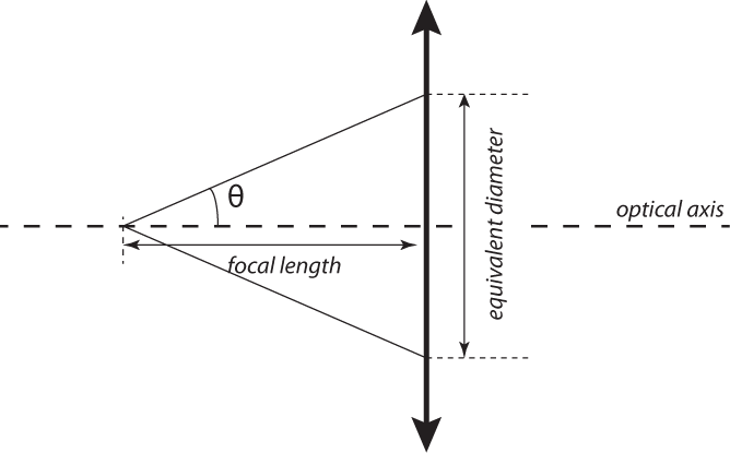

Figure 2 gives a schematic representation of the equivalent lens which is then written as a line with arrows at each ends. The optical axis is perpendicular to the lens and passes by the lens centre. Furthermore, the lens has an equivalent diameter and focal length as discussed previously.
Figure 2 - Equivalent lens of the microscopy objective when used in an infinity corrected microscope configuration.
The quantity controlling the resolution of the system is the numerical aperture (NA) which is related to the maximum cone of light caught by the lens from an emitter that would be located at the position of the object:
following the notations of Figure 2.
The transversal resolution of the objective is then given by the Rayleigh criterion:
where ∆x is the smallest distance that can be resolved on the object plane and λ is the wavelength of the light used.
When buying a microscopy objective, the manufacturer will tell you the numerical aperture directly. For instance, the 4x Olympus Plan discussed previously has a numerical aperture of 0.1 which lead to ~3 µm of lateral resolution when using blue (475 nm) light. In the case of camera objectives, we have to use the f-number to compute the numerical aperture. Analysis of Figure 2 allows us to write a formula to transform the f-number, f/#, into a numerical aperture:

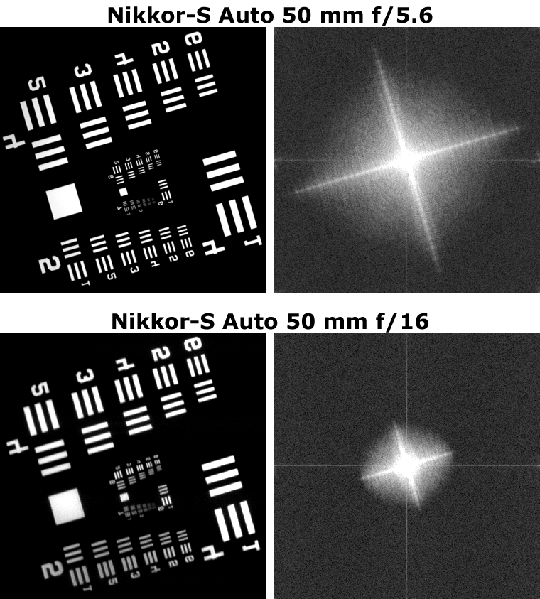

So, using blue light, a f/1.4 lens has a maximum transversal resolution of about 0.86 µm, a f/1.8 lens 1.08 µm, a f/2.8 lens 1.65 µm and so on. This was verified experimentally by manually closing the aperture of the Nikkor-S 50 mm to various f-stops using the aperture ring and repeating the experiment with a blue LED source (475 nm), a green one (525 nm) and a red one (625 nm). The effective resolution (at the camera sensor) was estimated for each case using the 2D Fourier spectrum of the image. The sample used is a resolution test target US Air Force 1951 which is a known standard for resolution measurements. Example images along with their Fourier spectrums are given for f/5.6 and f/16 as an illustration on Figure 3 (under blue light).
Figure 3 - Resolution at two different apertures.
Although it is relatively difficult to estimate the resolution on the image directly, a look-up on the Fourier spectrum gives an accurate measurement of the highest spatial frequencies found in the image and therefore gives the transversal resolution of the system once the magnification ratio is known (4x here).

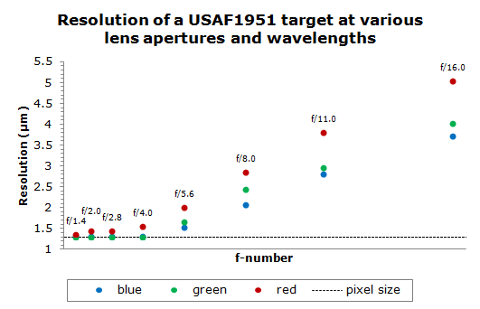

The complete results were summarized in Figure 4. As expected, smaller wavelengths gave sharper images than the longer ones and lower f-numbers gave better resolution too. However, I was not able to check the values below f/4 because the transversal resolution became smaller than the size of a pixel (the figure is given relative to the sample and so the size of a pixel was divided by the magnification ratio, i.e.: 5.2 µm/4).
Still, the Rayleigh criterion was verified for the other points except that the const factor was found to be 0.26 instead of 0.61. This can be explained by how the 0.61 factor was derived from the maths when compared to how we analyze resolution and it has little consequences here.
Figure 4 - Testing the resolution at various apertures and wavelengths
