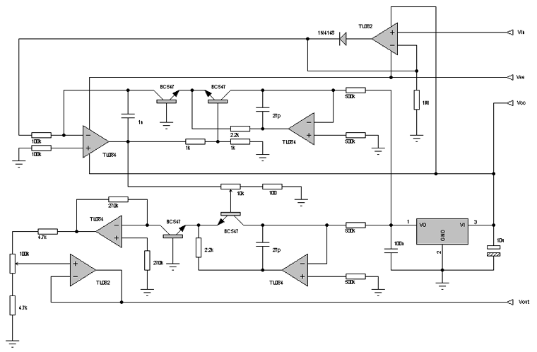

To test the solution I have assembled a derivation of the circuit of AN30 using TL084 op-amps which have small dc offsets and very low leakage current. I was not able to get LM394 matched transistors as suggested by the AN30 paper so I ordered a few samples of MAT12 super-matched transistors from Analog Devices (the retail price of these transistors is prohibitive but they were kind enough to send a couple of them for free). Unfortunately, I could not get the circuit working with these MAT12 transistors so I had to turn back to unmatched BC547 transistors, presumed to belong to the same production batch. This is a clearly inferior solution that has consequences I will describe later but I didn't have much choice.
The circuit schematic is given on Figure 2 and have 0.02<β<2 and 0.11<α<2.57. I have used a MC1702 sample from Microchip to create the reference voltage within 0.4%.

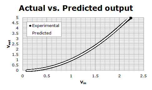

To test the circuit, I have used a ramp generator and stored both the input and output voltages. From these, I have then compared the actual output with the predicted output of a power function. The result is given on Figure 3.
There is an extremely good match between the actual and predicted outputs with an r2 above 0.999. There is only a slight deviation at the ramp voltages, probably due to saturation effects with either the DAC or ADC circuits.

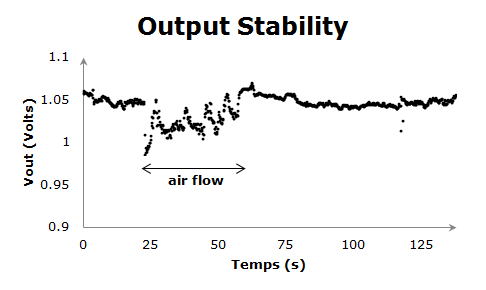

Finally, the stability of the output for a constant input was tested. The results are given on Figure 4.
Figure 4
The stability is of about 1% even over extended periods of time but, during the test I opened a window to have an air flow in the lab because of the summer heat. This had a strong influence on the stability of the signal which dropped periodically. This is the consequence of using transistors in separate cases.
All the working principle of our log amplifier is based on Eber-Molls law which is temperature dependent. When the transistors are at the same temperature, the effects cancel out but when we are using transistors in separate cases this is no longer true, especially when there is a stream of air around the circuit. This is the exact reason why we should use transistors integrated in the same case such as the LM394 or the MAT12.
Anyway, the circuit works fine and we may use it with satisfaction as long as we have some means to ensure that there are no temperature gradients over the transistors. Maybe a closed box with a fan would do the trick? If, on the other hand, you manage to get the MAT12 implementation working, send me an e-mail!
