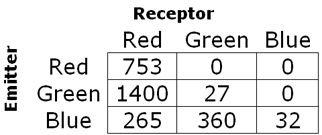

Few people know it but LEDs acts as photodiodes when hit by light. As a result, the LED creates a voltage potential and a small current (much less than 1 µA). But an even more interesting fact is that the phenomenon is wavelength-dependent.
In an experiment, two LEDs are placed face-to-face. The first one is connected to a battery with a resistor to limit the current (classical usage) and the second one is connected to a 10 MΩ shunt resistor and a voltmeter to read the eventual activity of the LED. A set of three different LED (red, green, blue) was tested in every possible combination and the results obtained are given on Figure 1.
Figure 1 - Experiment results in mV.
Some pairs have an activity and some doesn't. A deeper analysis will lead to the conclusion that a LED used as photodiode can be triggered only by light of equal or higher photon energy (that is, equal or lower wavelength). Green light can then trigger a red LED but not a blue one. The trick works with any LED, not just red, green and blue ones of course.

The tracer thing is best illustrated with fluorescein which strongly absorbs blue light and re-emits green-yellowish radiations. Using a blue emitting diode and a cyan receptor yields excellent results. In former tests, I have used two blue LEDs but the read-out voltage was kind of low because equal LED do not generate much output compared to LED that clearly differs (see Figure 1 on its diagonal). The cyan LED was a perfect choice because it just lies between the blue light region and the green-yellow region.
