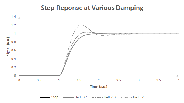

By the way, working with or without damping can make a big difference in your filter response. This is especially obvious when looking at the time response of a step pulse such as represented on Figure 4 for various damping parameters. So if you are tempted to use the simplified circuit of Figure 3, you should first question if this is okay for your application to work with Q=0.5.
Figure 4 - Step response with various damping parameter
More or less damping can then have a large impact on the filter performance. With little damping (high Q), the signal rise up quickly but also produce strong overshoot. Bigger damping (low Q) takes more time to reach the step value but does not produce overshoot.

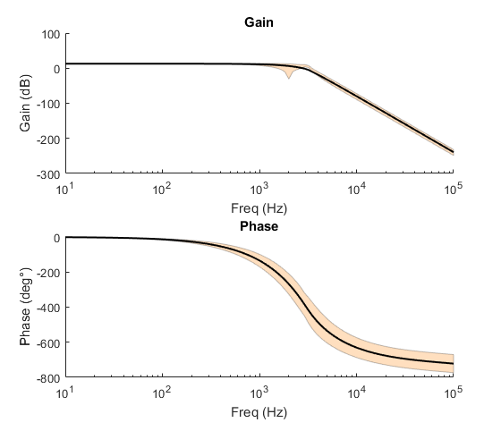

function [FreqHz, Gain_mean, Gain_std, Phase_mean, Phase_std] = computeBodePlotWithTolerances(filter, type, FreqMinHz, FreqMaxHz, FreqNumSteps, TolRes, TolCap, NumSimulations) % init Gain_mean = zeros(1, FreqNumSteps); Gain_var = zeros(1, FreqNumSteps); Phase_mean = zeros(1, FreqNumSteps); Phase_var = zeros(1, FreqNumSteps); for i=1:NumSimulations % init filter with tolerance filter_with_tol = filter; for j=1:length(filter_with_tol) filter_with_tol(j) = applyTolerances(filter_with_tol(j), TolRes, TolCap); end % compute transmitance [FreqHz, Gain, Phase] = computeBodePlot(filter_with_tol, type, FreqMinHz, FreqMaxHz, FreqNumSteps); % add to mean and variance Gain_mean = Gain_mean + Gain; Gain_var = Gain_var + Gain .^ 2; Phase_mean = Phase_mean + Phase; Phase_var = Phase_var + Phase .^ 2; end Gain_mean = Gain_mean / NumSimulations; Gain_std = sqrt(Gain_var / NumSimulations - Gain_mean .^ 2); Phase_mean = Phase_mean / NumSimulations; Phase_std = sqrt(Phase_var / NumSimulations - Phase_mean .^ 2); end % randomize components using given tolerances function filter_with_tol = applyTolerances(filter_without_tol, TolRes, TolCap) % init filter_with_tol = filter_without_tol; % randomize resistors filter_with_tol.R1 = filter_without_tol.R1 * (1 + (rand() - 1) * 2 * TolRes); filter_with_tol.R2 = filter_without_tol.R2 * (1 + (rand() - 1) * 2 * TolRes); filter_with_tol.R3 = filter_without_tol.R3 * (1 + (rand() - 1) * 2 * TolRes); filter_with_tol.R4 = filter_without_tol.R4 * (1 + (rand() - 1) * 2 * TolRes); % randomize capacitors filter_with_tol.C1 = filter_without_tol.C1 * (1 + (rand() - 1) * 2 * TolCap); filter_with_tol.C2 = filter_without_tol.C2 * (1 + (rand() - 1) * 2 * TolCap); end function plotBodeWithTolerances(FreqHz, Gain_mean, Gain_std, Phase_mean, Phase_std) % Display Gain figure(1) subplot(2,1,1) hold all h = fill([FreqHz, fliplr(FreqHz)], [20 * log10(abs(Gain_mean + 1.96 * Gain_std)), fliplr(20 * log10(abs(Gain_mean - 1.96 * Gain_std)))], 'red'); set(h, 'FaceColor', [1 0.5 0]); set(h, 'FaceAlpha', 0.25); set(h, 'EdgeColor', 'black'); set(h, 'EdgeAlpha', 0.25); plot(FreqHz, 20 * log10(abs(Gain_mean)), 'black', 'LineWidth', 1.5); set(gca,'xscale','log') title('Gain'); xlabel('Freq (Hz)'); ylabel('Gain (dB)'); % Display Phase figure(1) subplot(2,1,2) hold all h = fill([FreqHz, fliplr(FreqHz)], [Phase_mean + 1.96 * Phase_std, fliplr(Phase_mean - 1.96 * Phase_std)], 'black'); set(h, 'FaceColor', [1 0.5 0]); set(h, 'FaceAlpha', 0.25); set(h, 'EdgeColor', 'black'); set(h, 'EdgeAlpha', 0.25); plot(FreqHz, Phase_mean, 'black', 'LineWidth', 1.5); set(gca,'xscale','log') title('Phase'); xlabel('Freq (Hz)'); ylabel('Phase (deg°)'); end
The function takes the filter as input and the tolerances on the capacitors and resistors. It then generates a given number of simulations (typically 10,000) and compute the gain and phase of each of these systems. The function then returns an average gain and phase with their standard deviation so that you can build your confidence intervals.
Figure 5 shows a Bode Plot for a 1 kHz, 8th order, low pass Bessel filter built from 5% E12 resistors and 20% E6 capacitors. The orange area represents the 95% confidence interval for the filter through the Monte Carlo simulations.
Figure 5 – Bode Plot for a 1 kHz 8th order Bessel low pass filter with its 95% confidence interval

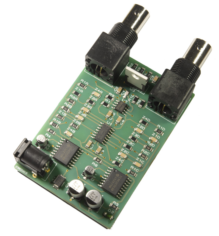

Generic 8th Order Sallen-Key PCB

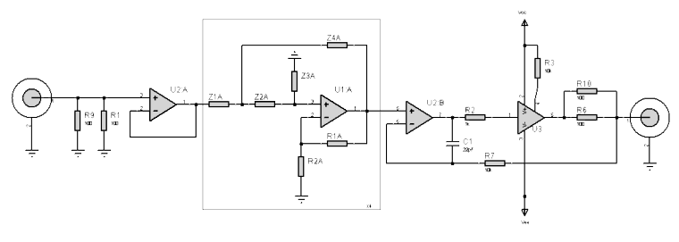

The circuit proposed here is given in Figure 6. It comprises an input stage with a BNC connector and a 50Ω impedance load with a TL072 (U2) as a unity follower. We then have four Sallen-Key stages labelled A,B,C and D (only stage A is shown in the figure) with a low noise generic operational amplifier TL074 for U1. We then have a current booster LT1010 (U3) connected to the output BNC connector. Because the LT1010 has a relatively large output offset voltage, it is zeroed by U2:B which has much better performances in terms of output offset voltage but which cannot drive a 50Ω load at large output voltage swings. Capacitor C1 is added to prevent oscillations at high frequencies. You can find this output buffer circuit in the LT1010 datasheet.
Figure 6 - Circuit Diagram
The circuit is powered by two TC962 as shown in Figure 7. A LED is added to both monitor the power status (on/off) and to have a minimal load on the system to prevent malfunctions of the power supply (12 Volts DA12-120EU-M unit).
Figure 7 - Power Supply

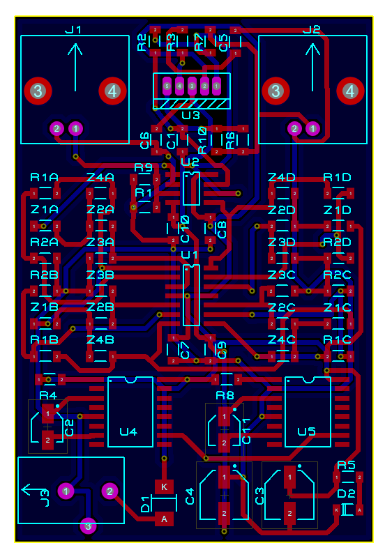

The circuit PCB Gerber files of Figure 8 can be downloaded here for non-commercial reproduction. All the components are SMT 1206 size or SOIC/SOIC-W, only U3 is in TO220-5 format and the aluminium capacitors are in 6.60x7.90 and 4.30x6.00 formats. 100 nF decoupling capacitors C5-C10 were also added to help reducing the noise levels. It is strongly suggested to select components for the Sallen-Key stage that are very stable in temperature. This is especially true for the ceramic capacitors that can be very sensitive in their cheapest versions.
Figure 8 – PCB of the final circuit
Concerning the BNC connectors J1 and J2 I used the “1-1634612-0” connectors from TE Connectivity. For the power supply connector, J3, I used the “PJ-102BH” from CUI Inc. Both the BNC and power supply connectors are available at Digi-Key.

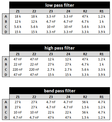

Due to a mistake when ordering the component (I bought 0805 capacitors instead of 1206 ones…), I was not able to implement the Bessel filters I planned to. Fortunately, I had some 1.5 nF 1206 capacitors on hand and I decided to use them to build my filter (yeah, because I could not wait… you know how it is). Obviously, this is not ideal and the filter will not be as good as it could have been.
The filter used for the test performed here is given in the table below:

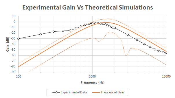

Still, the tests were successful with a nice sharp bandpass at just 1.1 kHz. The results are reported in Figure 9 and compared to the expected performances. Concerning the output voltage swing, it is slightly below ±5V with a 50Ω load when running at 12 Volts power input.
Figure 9 – Experimental results compared to theoretical simulations
We can see that the filter behaves almost as expected from the simulations. The actual data are however slightly shifted towards the lower frequencies tough it is still within the margin of the Monte-Carlo simulations (dotted lines). At frequencies higher than 2.5 kHz the cut-off is nice up to the MHz range (not shown) even if it stalls to about -60 dB probably due to the remaining noise in the output. However, there is a clear departure from the theoretical curve below 500 Hz. I noticed some odd ringing effect between from about 30 Hz up to 500 Hz that are illustrated in Figure 10. I have no explanation of this phenomenon yet but it clearly affects the performance of the filter.

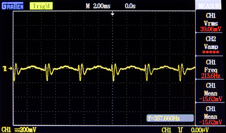

Figure 10 – Some ringing effect between 30 Hz and 250 Hz
Finally, I also checked the noise level of the circuit. With the DA12-120EU-M power supply unit the noise level reach 2.5 mVrms (100 MHz bandwidth probe) with a clear contribution of the power supply that could be seen at about 10 kHz. I therefore decided to solder a second circuit, with the same Sallen-Key stages but running from two 9 Volts batteries. The overall noise then dropped to 850 µVolts which relates well to the 18 nVolts/√Hz of the operational amplifiers used (475 µVolts expected) when considering that the oscilloscope already shows about 350 µVolts of noise when the circuit is not powered on.
If the 2.5 mVrms noise levels are too high for your application, you may consider running the circuit from batteries. And if the 850 µVolts are also too much, you may consider changing the operational amplifiers by a AD8674 for U1 and a AD8672 for U2 which should be pin-to-pin compatible in their SOIC version. With these, I would expect the noise to drop to about 200 µVolts (untested). At this point, the noise will be mostly limited by the LT1010. One possibility (untested), would be to replace the LT1010 by a BUF634 but this would require changing the PCB since the two IC are not pin-to-pin compatibles.
I am currently working on noise reduction and I will post updates as soon as I manage to get something nice.
