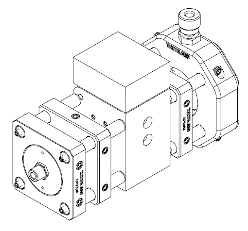

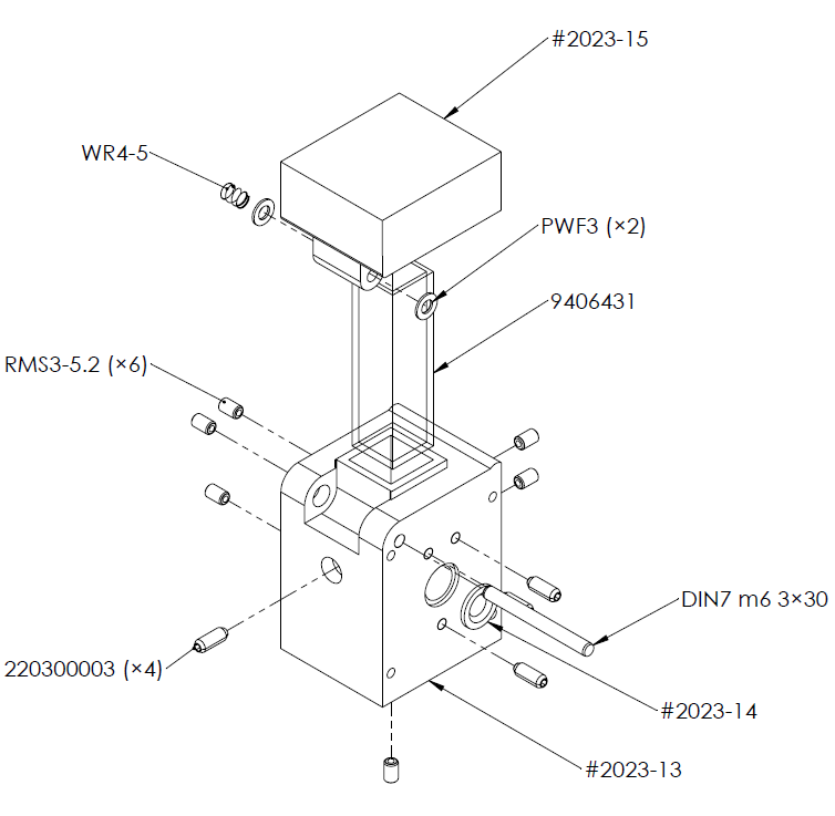

The liquid to be analyzed is placed in a standard square spectroscopy cuvette (a purchase reference given in the BOM file). For most work, you can use disposable polystyrene plastic cuvettes provided they match the dimension of the one given in the BOM. Note that polystyrene cuvettes are not compatible with some solvents like acetone.
A close-up of the cuvette holder is given in Figure 2. It can be printed out of PLA without any issue. At the moment, you can ignore the screws as they are necessary only for quantitative analysis. If you wish to already include the screws, you will need to use threaded inserts as well. Avoid excessive pressure with the screws, they just need to contact the cuvette to enforce repeatable positioning.

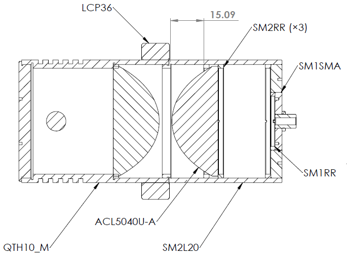

The idea is to shine broadband white light through the cuvette and collect the transmitted light to forward it to our 350-700 nm spectrometer. This means we also need a source of white light. Here, I’m using the Quartz-Tungsten-Halogen (QTH) lamp system shown in Figure 3. It’s just a relay system that picks up the light from the QTH bulb to re-image it on a SMA fiber connector. Image quality is not mandatory here as we’re merely looking for light collection to make the system more efficient than just putting the fiber in front of the light bulb itself. All the necessary information is included in the file package here-above and are under the same open-hardware license.
Figure 3 – Quartz-Tungsten-Halogen light source system

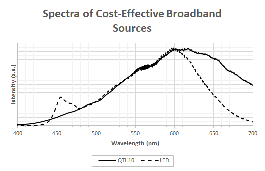

A typical emission spectrum of a QTH10 lamp measured by our 350-700 nm spectrometer is shown in Figure 4 along with a white LED spectrum from a desk lamp. The QTH lamp offers slightly more energy in the 400-450 nm region and reveals itself especially useful in the NIR range above 650 nm. Since none of the sources I have can cover the 375-400 nm range, all the spectra reported in this post starts at 400 nm.

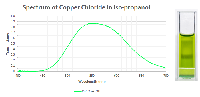

Now that we have a working setup, we can start measuring liquids with it. Since our spectrometer covers the visible range, we can pick any liquid that has a color we can see. Preferably, the liquid shouldn’t be turbid (i.e. it should be transparent). Here, I’m using Cu2+ copper chloride solutions but you can use anything you’d like. I’ve shown a typical transmission spectrum along with a picture of the liquid in the cuvette itself in Figure 5.
Figure 5 – Spectrum of a copper chloride in isopropanol solution
In Figure 5, we see that the copper chloride solution transmits light in the green region but that the blue and red regions has lower or almost no transmission. When we shine white light through this solution, the red and blue wavelengths are absorbed and the green/yellow part of the spectrum passes through. This explains the green/yellow tint of the liquid.

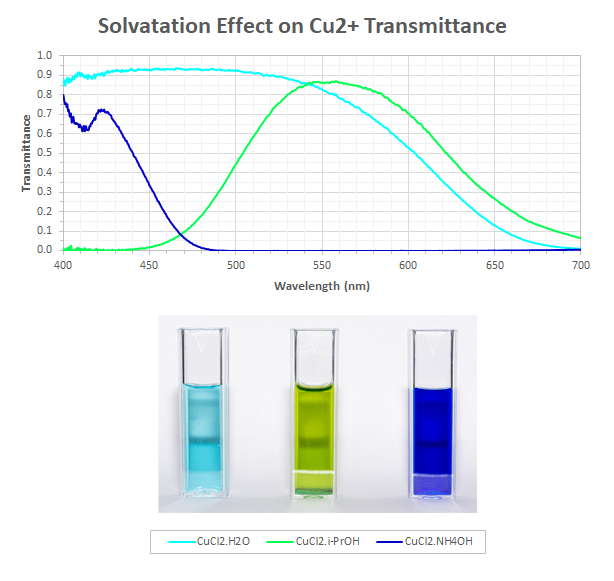

An interesting experiment is to dissolve the same copper chloride salt in different solvents: isopropanol (i-PrOH), water (H2O) and ammonia (NH4OH) and observe the color change. The results are shown in Figure 6.
Figure 6 – Copper chloride in various solvents
In Figure 6, we see that isopropanol, ammonia and water give different colors but also that ammonia, at the same concentration of Cu2+ ions, has a much deeper absorbance. The complete combination of a molecule or ion with its surroundings must therefore be considered to fully explain the absorbance in liquids and not just the molecule or ion that you wish to study. If the colors were due to the copper chloride alone, we wouldn’t have observed any change in Figure 6.
Absorbance spectroscopy is therefore extremely helpful in understanding properties of molecules and their interaction with solvents, even in today’s modern chemistry. We’re going out of my comfort zone here, but I would like to explain what I understood after (weeks of) research on the topics. I’m also using a fairly simplified description to give you a general feeling of what is going on, which implies some shortcuts. Take my words with caution.

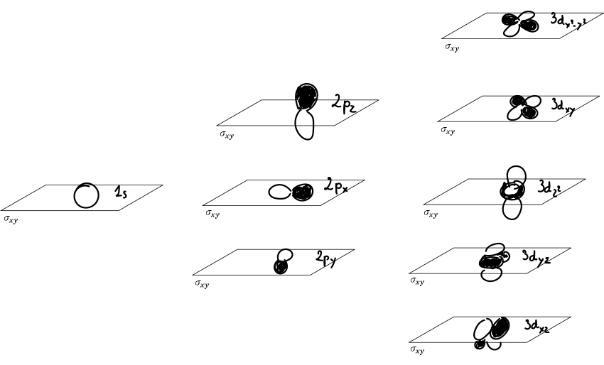

Quantum physics predicts that electrons do not move freely around atoms but are restricted to specific regions in space around the nucleus. Different electrons of different energies will occupy different regions known as atomic orbitals which you may have heard at either University or advanced chemistry classes in high school. Wikipedia has a very detailed article about atomic orbitals that I can recommend for extended readings. Figure 7 shows some of these common atomic orbitals. The different orbitals are given with their name and the σxy reference plane to orient them in space. Black/White is a convention to indicate the sign of the wave function of the orbital but plays no role in the probability distribution of the electron.

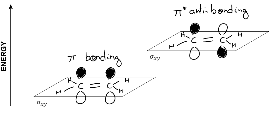

Figure 8 shows a molecule of ethylene with its “π” bonding orbital and it’s “π” anti-bonding orbital. The naming of these orbitals (π, π) is specific to molecules that have a plane of symmetry. You will also encounter σ, σ and n molecular orbitals in these molecules. Note that not all molecules have a plane of symmetry but many organic molecules who are accessible in UV-VIS spectroscopy do and the π, π and n molecular orbitals are frequently involved in this range of spectroscopy technique. The naming convention is not relevant for a general understanding of the spectroscopy process but I’m putting it here because you will often see these names pop up in spectroscopy and chemistry textbooks. If you wish to know more about this, you can consult the Wikipedia page on molecular symmetry, a branch of group theory which is very useful in chemistry and spectroscopy. Figure 8 also orders the molecular orbitals according to their relative energy levels with the bonding orbital being more stable than the anti-bonding one. In ethylene, electrons reside in the π bonding orbital and the π* orbital is initially empty.

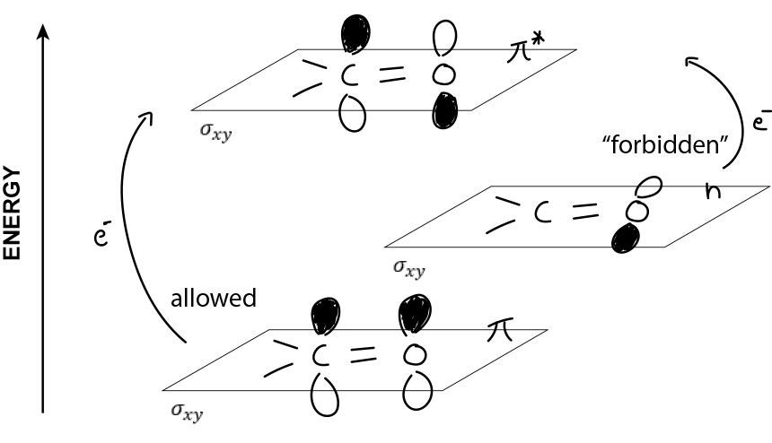

The transition probability can be anything from highly probable to highly improbable, leading to some absorption peaks stronger than others. Fortunately, we don’t have to solve the here-above integral and the study of the symmetry properties of the molecule can already help us identify which transitions are authorized by symmetry and which are not. Experimentally, it is observed that transitions authorized by symmetry have very high absorbance peaks while those who aren’t have much lower ones, but do not necessarily mark a complete absence of absorbance. While these rules go a touch beyond the scope of this post, you can already remember than a transition is authorized by symmetry if the symmetry properties of the overlap between the initial and excited molecular orbitals are the same as the symmetry properties of any of the XYZ axis over the complete symmetry operations that leaves the molecule geometry unchanged. I will go further into this topic in a future post when I have time.
As an illustration, the n→π transition of the carbonyl group (C=O) in formaldehyde is not authorized by symmetry and yields a weak absorbance peak while the π→π transition of the same carbonyl group is now authorized by symmetry, yielding a much stronger absorbance peak even if the required energy for the π→π transition is higher than for the n→π transition. In ethylene (Figure 8) and, more generally speaking in conjugated polyenes such as carotene, the π→π* is authorized by symmetry as well. A diagram of the different molecular orbitals and associated energy levels of the carbonyl group is given in Figure 9. The same phenomenon occurs with our copper chloride solutions. With water and isopropanol, the copper ions form an octahedral complex and the d orbitals of the solvated ion do not have a compatible overlap symmetry with any of the XYZ axis, leading to a weak absorbance. On the other hand, with ammonia, the copper ions form a tetrahedral complex whose d orbitals now have a compatible overlap symmetry with one the XYZ axis, leading to a very strong absorbance. The mathematical analysis of the symmetry properties of the solvated copper ion is a bit more complicated to perform but the underlying theory is the same. We’ll stick to this introductory conclusion here.
