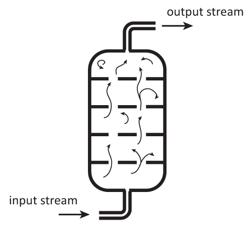

One nice way to estimate the efficiency of a given reactor design is to derive its residence time distribution (RTD) pattern. To understand the usefulness of the RTD concept, just imagine that when chemicals are introduced into the reactor they will be divided in a series of individual microscopic lumps that will carry on their conversion process from reactants to products independently of the other lumps. Conversion of reactants to products is described by a set of differential equations translating the kinetics of the reaction, just like in regular chemistry. Because the lumps are considered independents of each others, the conversion efficiency to desired products will only be a function of the input concentrations and the reaction time. However, not all lumps will take the same path through the reactor vessels: some will be caught in back-mixing eddies, other will take shortcuts… The situation is represented on Figure 1.
Figure 1 - Example of fluid pattern in a real reactor

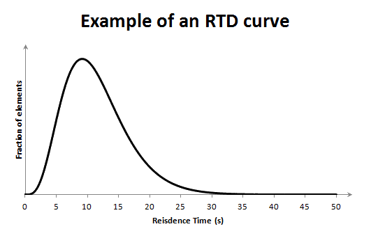

The RTD gives, as its name suggests, the mathematical distribution of residence time of all these lumps inside the reactor vessel. It tells how many percent of the fluid will stay for how long. An example of RTD curve is given on Figure 2.
Figure 2 - Example of an RTD curve
Once you know the RTD distribution and the kinetic equations describing the reaction inside the vessel, you can simply integrate the RTD curve product with the conversion efficiency equation to know the overall efficiency of the reactor design.

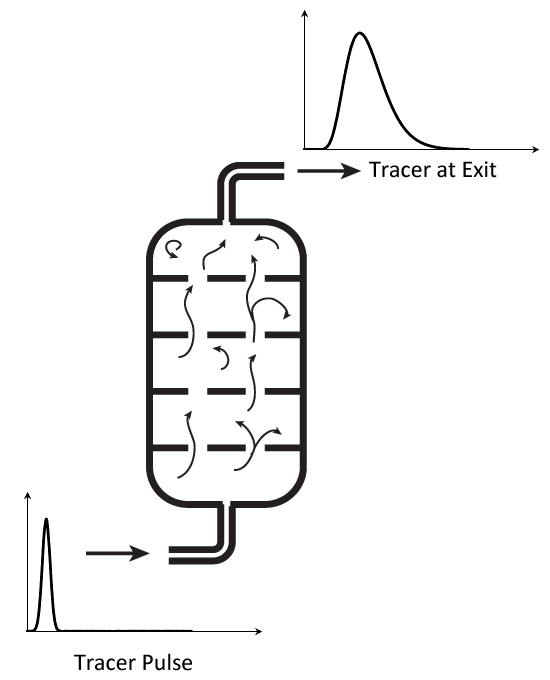

But how does one compute the RTD curve for a given reactor vessel? Solving the fluidic equations, even using computer software, would be too tedious due to the high complexity of the flow patterns. One of the best way used by chemical engineers is to simply try on a physical model of the vessel! If we insert a pulse of non-reactive tracer at the entrance of the reactor and measure the tracer concentration at the output, we will get a broadened curve which is exactly the RTD of the reactor. This is represented on Figure 3.
Figure 3 – Pulse experiment to find the RTD curve
The tracer pulse can be seen as a large number of microscopic lumps of tracer which will take different path through the reactor vessels. By measuring the concentration of tracer at the exit, we directly have a signal that is proportional to the percentage of lumps that stayed for that much time inside the reactor. Normalizing the curve such that its area will give a 100% distribution is then simply the residence time distribution curve.

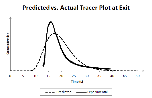

Once you have an estimated RTD curve, you can convolute it with your tracer signal at input to compare the output predicted by the model and the actual output observed. I have plotted my results on Figure 4 so that you can see how well the Tanks-in-Series model performs.
Figure 4 - Predicted vs. Actual tracer plot at exit

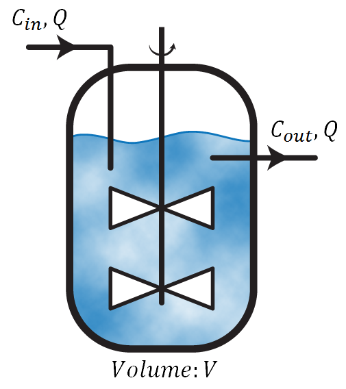

To understand how the Tanks-in-Series model does its job, let us first look at what is exactly a perfectly stirred tank reactor. Figure 5 gives the traditional schematic of a stirred tank reactor of volume V, flow rate Q and input/output concentration of Cin and Cout respectively.
Figure 5 - Schematics of a perfectly stirred tank reactor
In a perfectly stirred tank reactor, fluid of tracer concentration Cin is continuously pumped to the reactor with a flowrate Q. What makes it “perfect” is that we consider that the mixing is ideal and the inlet stream is immediately distributed in the whole reactor volume. Because the reactor operates at constant volume, the exit stream has the same flowrate Q and the output concentration of tracer is the concentration inside the reactor volume (due to the ideal mixing hypothesis).
Put into equations, we have
Defining T the time constant of the reactor as V/Q, we have,
which can be solved using a Laplace Transform,
and so the transfer function is
As a first conclusion, we can say that a perfectly stirred tank reactor can then be seen as a low pass filter of time constant T. Any tracer input of distribution Cin will be transformed into an output distribution Cout through the transfer function E which is nothing but the RTD of this reactor. Indeed,
which is the exact definition of the RTD that I gave earlier.

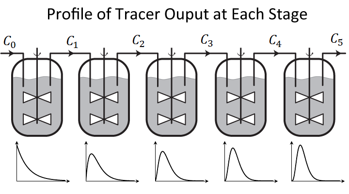

Working in the Laplace space has many advantages because putting N perfectly stirred tanks reactors in series consists of simply multiplying their transfer function E(p). N tanks in series will then have a transfer function EN(p) of
This is represented on Figure 6 with five tanks in series and the RTD profile at each exit.
Figure 6 – Profile of the RTD curve at each exit of a series of five perfectly stirred tank models

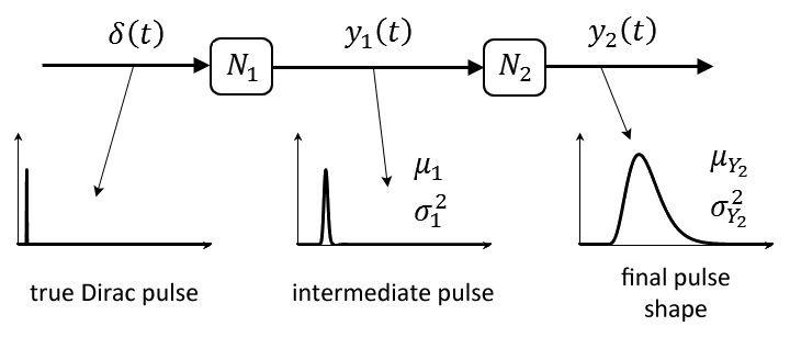

But this is only valid for a Dirac pulse input and not for an any-shape, real, tracer inlet. Let us now prove that the tanks in series model is additive. To understand this, consider a Dirac pulse entering a first reactor of N1 tanks and then a second reactor of N2 tanks. The situation is represented on Figure 8.
Figure 8 - Additivity of two Tanks-in-Series model of N1 and N2 tanks
We know that
or, using the Laplace Transform,
for which
and so
where µ2 is the geometrical mean that would have been obtained from a Dirac pulse applied to the reactor with N2 tanks.
The same can be done for the variance,
Due to the symmetric aspect, let us focus on the first term
and so
where σ2 is the geometrical standard deviation that would have been measured by applying the Dirac pulse directly to the reactor of N2 tanks.
In our experience, N1 is due to the injection pattern and what we are interested in is N2 and so µ2 and σ2. We can use the additivity on the mean and variance obtained previously to give
and so
which justifies the approaches of subtracting the mean and variance of tracer response at the inlet and outlet of the reactor.
