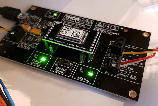

The MTD415TE on the MTDEVAL1 board is shown in Figure 1.
Figure 1 – MTD415TE chip on the MTDEVAL1 board
One interesting thing to note if you look carefully at Figure 1 is that I had to wire the TEC element with reverse polarity! I have no idea why the indications are messed up but it is like that. Failing to do so will heat your TEC instead of cooling and vice-versa, which may eventually damage your LD so be careful.

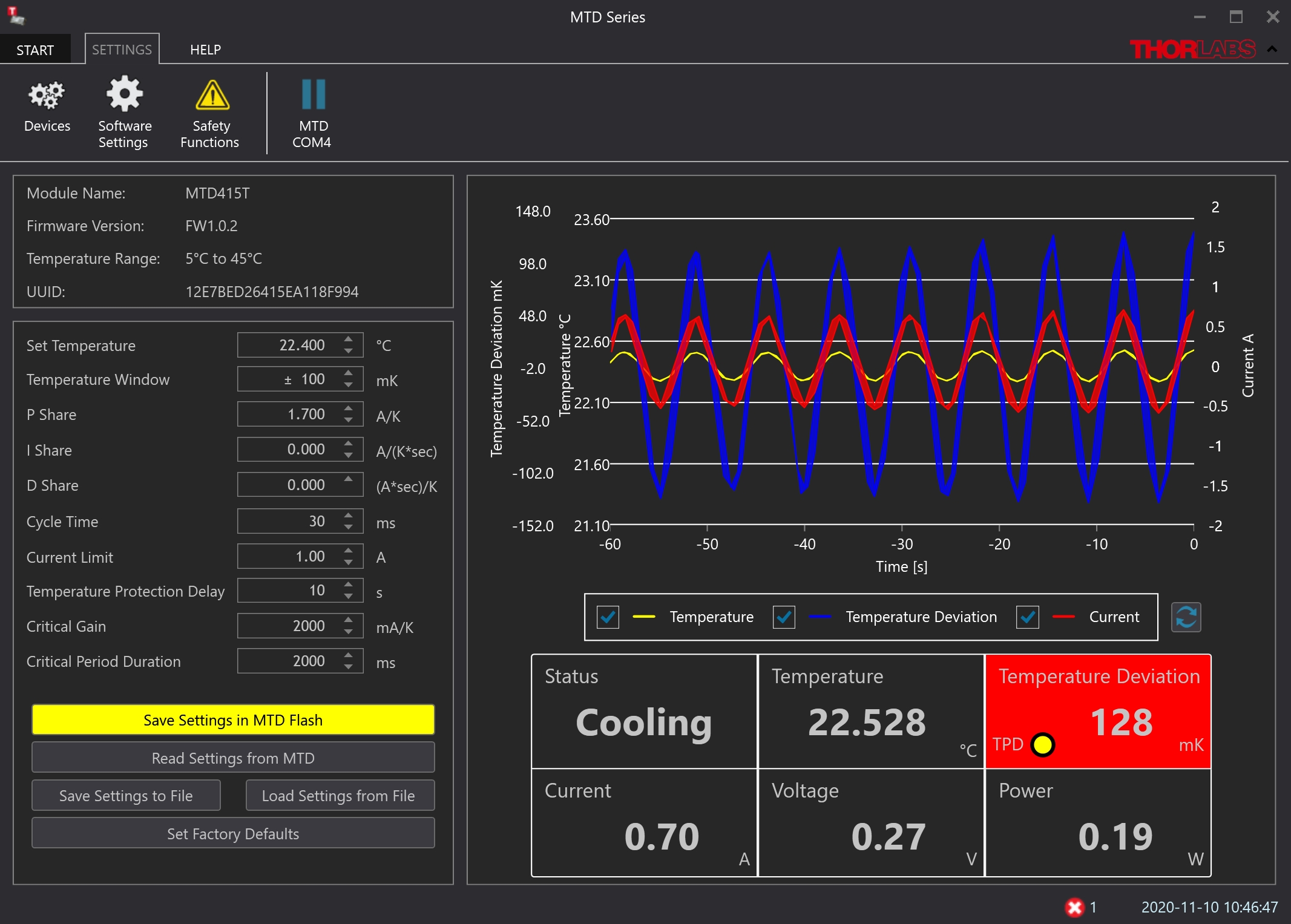

The user manual will guide you through a Ziegler-Nichols procedure to tune your PID by first identifying the gain at which the system start oscillating. A screenshot of the program during that tuning phase is given in Figure 2.
Figure 2 – Ziegler-Nichols tuning of the PID

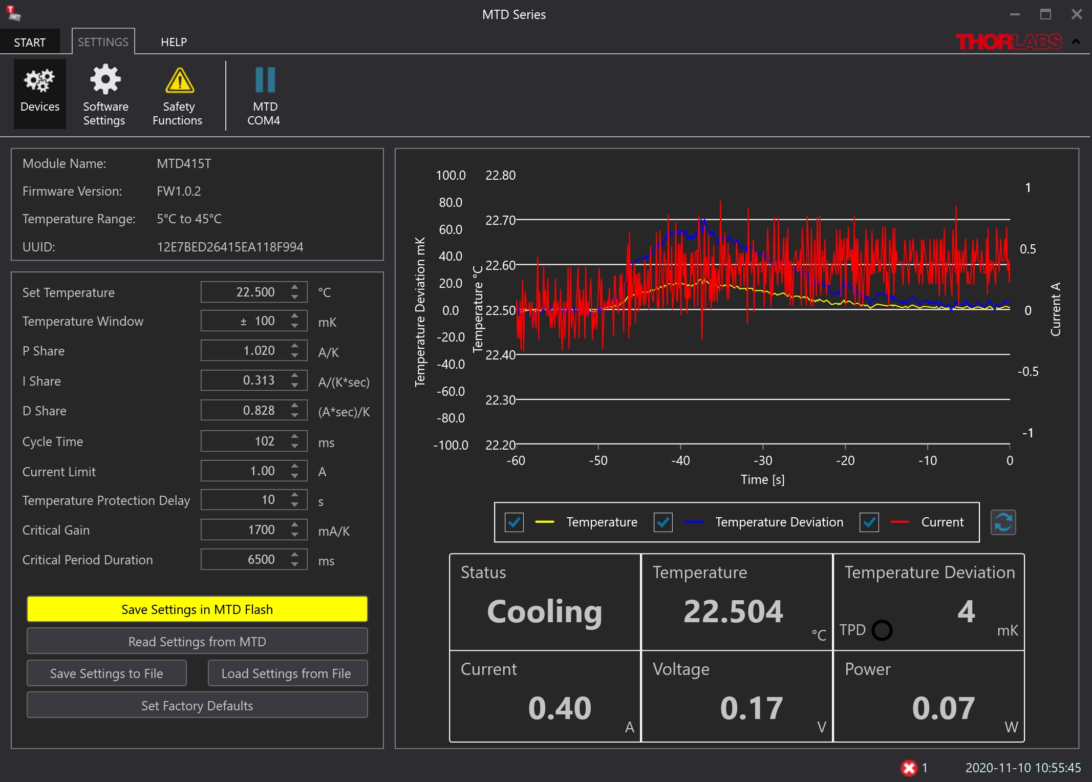

The GUI assists you in getting the PID values from the Critical Gain and Critical Period which makes the process relatively easy when you are not used to PID tuning. The standard Ziegler-Nichols rules tend to produce slight overshoots however as can be seen in Figure 3. I tried to use modified Ziegler-Nichols rules to produce damped response with no overshoot but I was not able to make sense to the “Cycle Time” parameter of the configuration.
Figure 3 – PID response at not load (laser off)

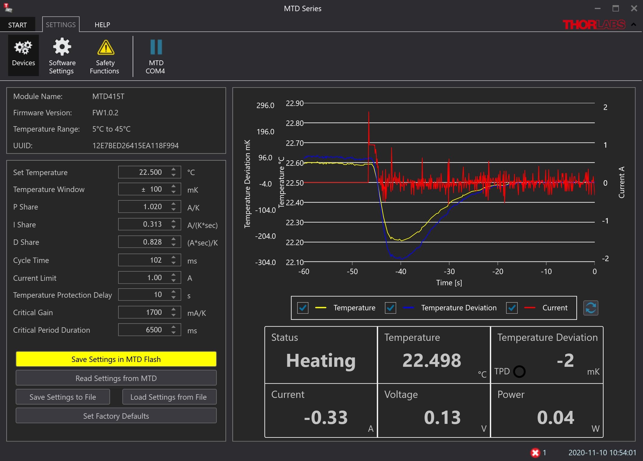

This was not a big deal however as the system produced very little overshoot when switching on the laser at a 300 mA load. Actually, the temperature did not exceed the set point by more than 60 mK which is already quite good. After less than one minute the temperature settled within ±5 mK variation. This is illustrated in Figure 4.
Figure 4 – Very slight overshoot when switching on the laser

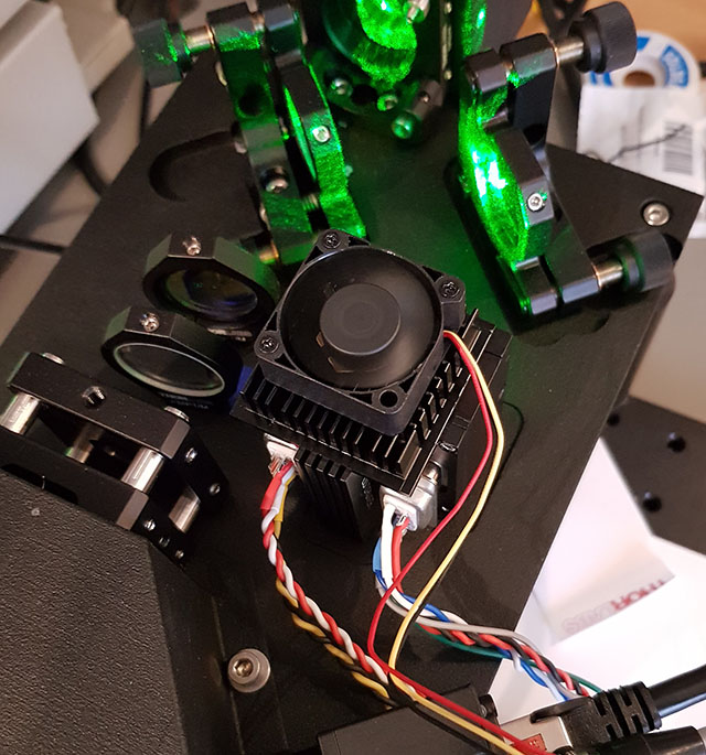

I then left the system running with the laser on to check how it performed over time. Everything was working fine until I ran into a catastrophic failure after 1h of operations. The driver stopped powering the TEC element while the laser was still on. The temperature quickly went up and could have potentially damaged my LD. When I noticed the problem, the temperature was already at 38°C.
A quick investigation revealed that the problem originated from the LDM21 passive cooling system. The LDM21 has a heatsink that does not allow sufficient cooling by natural convection. Just for the quick info, when I contacted Thorlabs about using the DJ532-40 with the LDM21, they told me the module was not compatible.
Because the passive cooling of the LDM21 did not handle the heat generated by the hot side of the TEC element, the TEC became hotter and hotter, requiring more current to keep the cold side at the 22.50°C set point. More current was then generating even more heat which was at the origin of an instability in the system since at some point the maximum driving current would be reached (1A in the default settings). When the maximum current is reached, the MTD415 safety features automatically switches off the device after a given delay. This is good to prevent the driver from over-heating but will lead to a catastrophic failure of the LD that is still powered up.
I was able to fix this problem by adding an extra heat sink with forced convection cooling on the LDM21 as shown in Figure 5. Fans are usually avoided in optical systems due to vibrations but here it works perfectly fine.
Figure 5 – Extra heat-sink mounted on the LDM21
With the fix installed, the system was perfectly steady and no increase in current could be noticed anymore over time. With the ambience at 22.3°C I was even able to operate the laser at 16°C by increasing the maximum TEC current to 1.5A which is the maximum allowed by the MTD415TE board.
