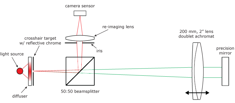

The principle of auto-collimation is to state that if an object is placed at the focal plane of the lens then the output beam will be collimated. Now, we also know that putting a collimated beam in a lens will produce an image focused in the focal plane of that lens. The solution is then to lit the object and place a mirror after the collimation lens to send the light rays back to the lens. When the object is placed at the exact focal position, both the object and its image reflected by the mirror will overlap perfectly.
There are several implementations possible for the auto-collimation principle, the one I have used for this post is shown in Figure 1.
Figure 1 - Autocollimator setup built in this post
In this setup we have a light source (red LED) illuminating a diffuser whit coarse grit placed behind a reflective crosshair target with thin lines (25 µm wide). The light then passes through a 50:50 cube beam splitter and a 200 mm 2” doublet achromat lens before reflecting on a flat precision mirror. It is important to use precision element to avoid blurring of the crosshair pattern due to eventual distortion or aberrations produced by the optical elements. The light rays re-entering the system are then focused back on the crosshair target if it lays perfectly in the focal plane of the lens. Finally, an imaging system comprising a 50 mm bi-convex lens with an iris and a camera sensor records both the original pattern of the crosshair target and its reflection. To allow capturing the reflection, it is important to use a negative reflective crosshair target such as those available at Thorlabs. Most of the target will then act as a mirror apart the thin lines that will produce the crosshair pattern.

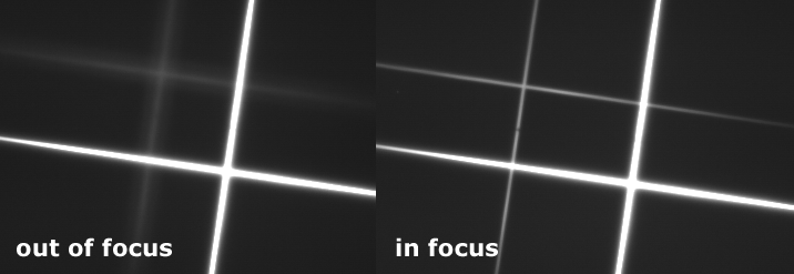

When aligning the setup, you first need to remove the mirror and adjust the re-imaging lens and camera sensor position until you have a perfectly sharp image of the crosshair pattern. You may have to close slightly the iris to avoid spherical aberrations that will blur your image slightly. Do not close the iris too much because you may increase the depth-of-field and reduce the accuracy of the focus identification. The idea is to find the optimum between the smallest depth-of-field possible and the least aberrations in the image such that you have the sharpest image.
Once you have a sharp image of the crosshair target, put the mirror such as to reflect the beam perpendicular to the lens. Then move the 200 mm achromat until the reflection of the crosshair is at its best focus. You may have to slightly tilt the reflection mirror in order to shift the crosshair reflection on the side to distinguish it from the original crosshair. Use only rigid fixture to hold everything because the system is very sensitive to small tilts such as shaking hands or badly fixed setups. Figure 2 shows an out of focus image (left) obtained when the system was unaligned and the focused image (right) when the system was properly aligned. Notice that the original crosshair image appears strongly saturated because the camera exposure time had to be increased to catch the reflection signal which was attenuated by the additional beamsplitter reflections.
Figure 2 - Alignment of the autocollimator setup
