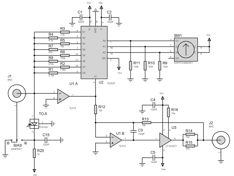

The active part of the circuit is shown in Figure 3. It consists of the transimpedance amplifier of Figure 1 (U1:A) with gain selectable by the 8:1 analog switch U2 (DG408) driven by the BCD switch SW1 (with its pull-down resistors R9-11). The source can be fed either through the BNC input J1 or via the TO-5 socket shown as a photodiode with grounded shield in the figure. In case of a TO-39 photodiode, the leg spacing is the same but there is no shield pin for the casing (which is without consequence for the compatibility). A RC low pass filter made by R20 and C15 filters the 5V bias voltage fed to the photodiode. The bias voltage can also be applied to the guard of the BNC connector J1 through the jumper although on Figure 2 I decided to replace it by a small switch because I did not order the proper jumpers. Finally, the output voltage of the transimpedance amplifier is sent to a 50Ω line drive made by U3 (LT1010) and U1:B. The role of U1:B is to cancel the high offset voltage of the LT1010. Also, the circuit is mounted as a unity gain inverser because the output of the transimpedance amplifier will always be a negative voltage and we would like to have an overall positive output. The bandwidth is ultimately controlled by R13 and C3 (160 kHz) although it can be lowered by the gain of the transimpedance amplifier and the photodiode used as well as its mode of operation (biased or unbiased).
Figure 3 – Transimpedance amplifier with selectable gain and 50Ω line driver buffer

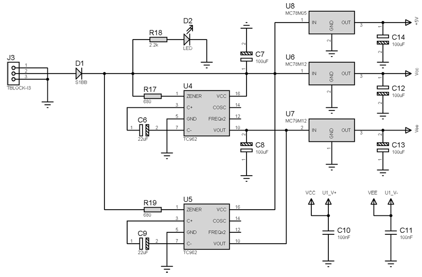

The power source part of the circuit is shown in Figure 4. A great part of the effort of the design of the photodiode amplifier presented here was to reduce the noise as much as possible because it is this noise that will ultimately fix the smallest signal measurable with the photodiode. It was therefore important to filter as much as possible the noise coming from the power supply. As usual, I used two TC962 (U4 and U5) to produce the split power supply with enough current capacity for the 50Ω load except that this time I used a +15 Volts input and two LDO regulators (U6 and U7) to clip any ripple in the supply rail and produce the clean ±12 Volts required by the circuit. Similarly, a 5V LDO regulator (U8) produces the 5V bias voltage. Please note that these LDO have some error in the output voltage and that they will not produce exactly ±12 Volts and +5 Volts. Be sure therefore to always check the actual bias voltage value before applying it to your photodiode, especially if the maximum bias voltage is of 5 Volts precisely. If you do not have a +15 Volts power supply, you can eventually work with a +12 Volts one and replace U6 and U7 by their ±9 Volts counter parts (MC78M09 and MC79M09). Please note that I did not test it yet so I cannot guarantee that it will work exactly the same, especially in terms of output voltage swing.
Figure 4 – Low noise dual power supply and 5V bias from a +15V input

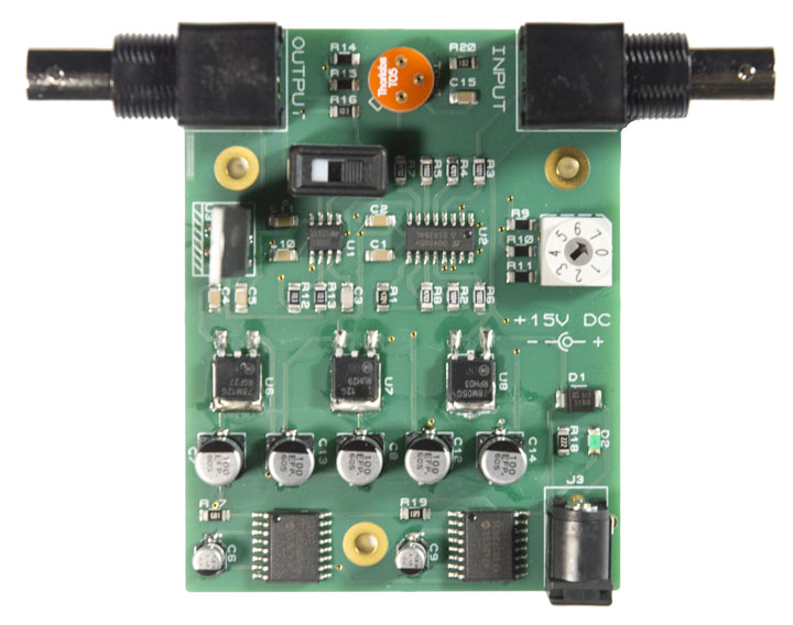

The circuit was assembled using standard 1206 components and tested using a Thorlabs FDS100 photodiode and a Thorlabs DET36A detector that is an already biased version of the FDS100 photodiode. I recommend to first check all the voltages of the circuit before testing a photodiode. Also, I recommend to use a cheap photodiode such as the Thorlabs FDS100 in a first place to prevent damaging a more expensive photodiode in case something was not assembled properly.

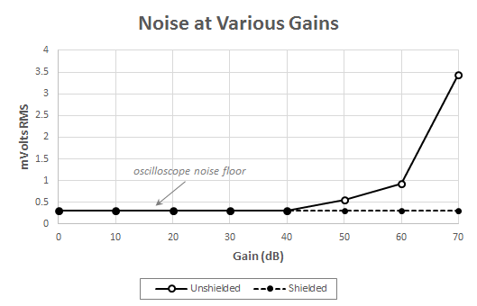

The noise of the circuit was measured with a 100 MHz oscilloscope with no photodiode plugged and a 50Ω terminator in at various gains. The results are shown in Figure 5. The overall oscilloscope noise floor is on the order of 300 µVolts RMS. At gains higher than 40 dB, some noise start to appear and reach 3.4 mVolts RMS at 70 dB. However, the noise structure clearly consists of an EM pickup and shielding the circuit with an aluminium foil reduced the noise to the oscilloscope noise floor back again. I would therefore recommend putting the circuit in a shielded box if possible. If you choose to do so however, do not connect the second BNC guard to the mass unless you do not plan to use the biasing at all.
Figure 5 – Noise measured at different gains

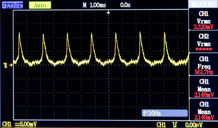

The same experiment was again run with a Thorlabs FDS100 photodiode in the TO-5 socket (still with the aluminium shield wrapped around). The results are presented on Figure 6 with some ringing of about 1 kHz appearing at 70 dB. Interrestingly, the Thorlabs PDA36A did not show the same pattern although it is made of the same silicon photodiode and the noise remained at the oscilloscope noise floor. I was not able to explain this phenomenon yet but a possible answer would be ripple current at the output of the LDO. I would therefore recommend using Thorlabs own biased or unbiased photodiode for small signals.
Figure 6 – Ringing with a Thorlabs FDS100 photodiode, possible leakage ripple current from the LDO

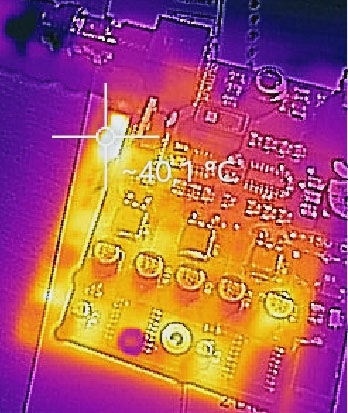

Finally, a thermography of the circuit was taken with a FLIR one camera. The results are shown in Figure 7. It shows a slight hot spot near the LT1010 element but of only 40°C. Some care must then probably be taken if the circuit is put in a small box but it should not be a major issue otherwise.
Figure "7 – Thermography of the circuit using a FLIR one camera

The Gerber files for the PCB can be downloaded here. It is a revised version of the circuit of Figure 2 where the BNC connectors were rotated by 90° to be inline with the board and to make it easier to fit into a box. Also, the bias/unbias switch now applies to the on-board photodiode as well. The bill of material can be downloaded here.
