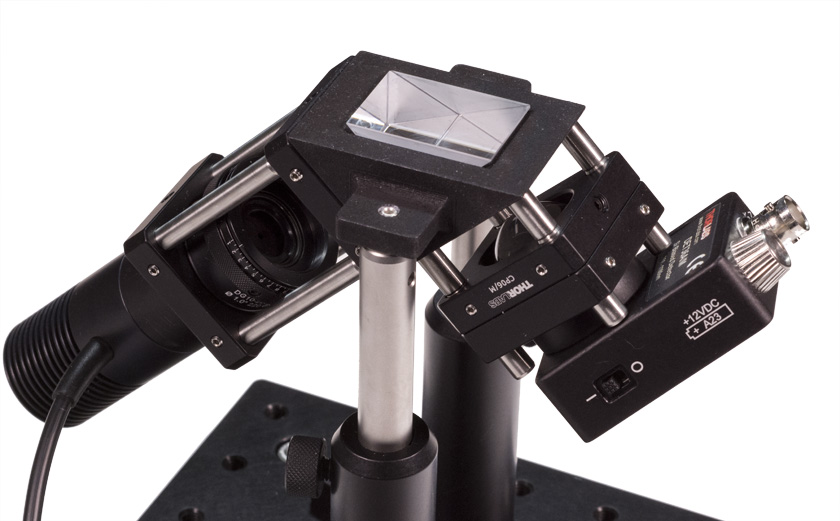

A photography of the experimental setup is shown in Figure 1. It was not optimized yet but the results are already very promising despites its relative simplicity.
Figure 1 – Photography of the experimental setup
The instrument is composed of a right angle prism, two lenses, a 626 nm red LED light source of 18 nm FWHM, a 220 grit diffuser, a ~2 mm iris, a photodiode and some driving electronics (see below). Everything is held together using Thorlabs cage system, two post holder and a custom prism holder part that you may download at the end of the post to reproduce by 3D printing. I paid less than 20€ for the model at Materialise.

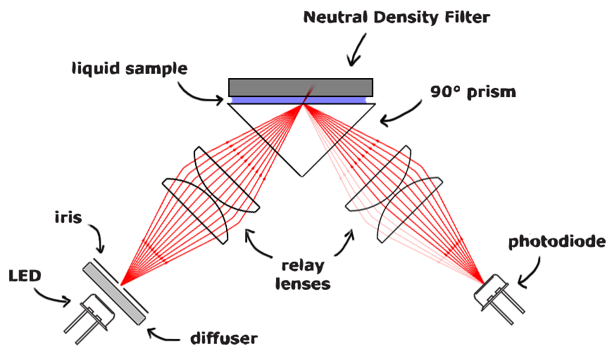

A schematic view of the setup is shown in Figure 2. The schematic also includes a neutral density filter whose role will be detailed later.

Although the setup uses a prism, it is not designed on the conventional Abbe refractometer but instead uses the critical angle of the prism to evaluate the refraction index of the liquid sample.
The idea is to generate a spot of a few millimetres diameter on the prism surface such that it comprises many different ray angles. This is done using the LED source with the coarse diffuser and the iris that is imaged by the relay lens group. The diffuser is used to artificially increases the LED light rays angle beyond the original LED emission cone. The lenses are simply two short focal lengths plano-convex lenses used as a relay imaging system.
At the interface prism/liquid, lights rays will experience refraction and enter the liquid. The output angle will be, according to Snell’s-Descartes law:
with θ1 the angle of the light ray before it refracts, θ2 the angle of the light ray after it refracted, n1 the refractive index of the prism and n2 the refractive index of the liquid.
Since most glasses usually have higher refractive indices than liquids, n1/n2 > 1 and there exists angles θ1 such that the refraction becomes non-physical because it would imply that sin(θ2) becomes greater than unity. When such condition is met, refraction does not occur and light is simply reflected on the surface. We then talk about total internal reflection. The angle at which this phenomenon starts to occur is called the critical angle and is equal to
For N-BK7 glass (n=1.50) and water (n=1.33), the critical angle is about 69.4°. It means that only light rays hitting the surface of the prism with angles lower than 69.4° will refract, all other rays being reflected at the interface.
This is precisely how the instrument identifies the refractive index of the liquid. This is because the LED/diffuser generates light rays in all directions before it hits the surface of the prism (tilted by 45°). Some light rays will refract into the liquid and some others will be reflected because they have too large angles. The instrument then gathers all the reflected light rays and re-image them on the photodetector. If we change the liquid, the refraction index will be slightly different and another amount of light rays will reach the detector. By measuring the received energy on the photodiode, we therefore have a direct relation with the refraction index of the liquid being measured.

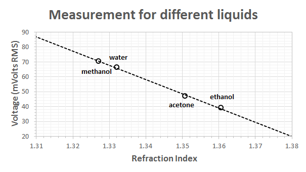

The results are presented on Figure 3 for four different solvents. I also added the best fit line between the point to evaluate the early performance of the system.
Figure 3 – Photodiode recording for different solvents
Even if there are only four measurement points, the trend is linear in the studied range as could have been expected. Each liquid is clearly identifiable and the resolution of the instrument was evaluated using 95% confidence intervals to 0.0014 units of refractive index. This is already very nice knowing that it is hard to do much better than that without thermal control because organic liquids typically have temperature sensitivity about 0.0001-0.001/°C.
Obviously, with only four data points it is a bit difficult to conclude yet on the performance but this is very promising considering the simplicity of the instrument. I will try to make an updated version in the following months to complete on that.
You can download the CAD of the prism holder here. It requires two 1.5D M4 helicoils and was designed to be used with Thorlabs P911 right angle prism. You can insert 6 mm rods of Thorlabs cage system on the side to do like on Figure 1 but it requires some gentle force so be careful.
