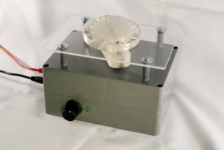

Magnetic stirrers can be bought from chemistry suppliers but they are expensive (at least a few hundred dollars!). It might also look suspicious to order that kind of things and you may want to keep a low profile depending on your local country freedom restrictions. I therefore propose to build your own powerful magnetic stirrer for less than $100US from electronic spare parts and neodymium magnets. A photograph of the magnetic stirrer built for this post is given on Figure 1.
The most difficult parts you will need are a geared DC motor and big neodymium magnets. I have used a 19:1 geared 12V 500 rpm DC motor ordered from RobotShop (reference RB-Pol-123) which features a Pololu encoder to get a feedback on the actual rotation speed and magnets ordered from SuperMagnet (two 20 mm Φ x 10 mm magnets and two 5 mm Φ x 25 mm magets). For the case, just get one that is large enough to contain everything and have a large surface to put your beaker on. For those who manage to get the stuff from RobotShop and SuperMagnet shops, I have included some construction help at the end of the post. To ease motor holes drilling in the case, just print the drill-help.pdf file on an adhesive sheet that you can stick on the case to have good holes alignment.

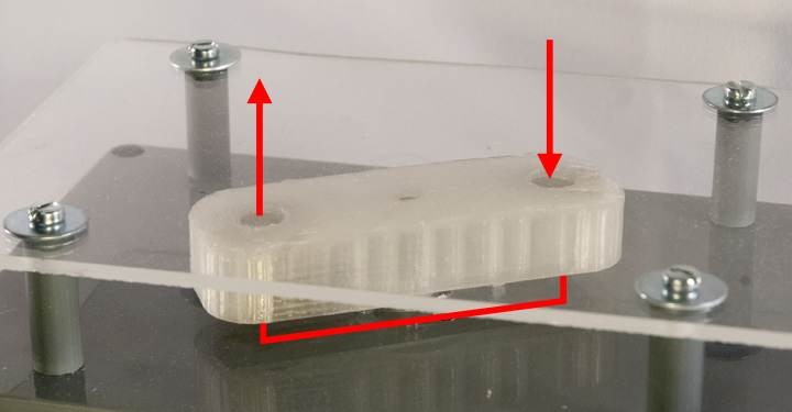

Concerning the motor magnet support, I have tried a few different versions but the one I have uploaded works good. Just put the two large 20 mm x 10 mm magnets in the holes with one having its North pole facing up and the other one having its South pole facing up. Also, it is a good idea to find some steel or iron piece to put on the back to help closing the magnetic field lines so they won’t extend into the DC motor too much (you will probably have to drill a hole in the centre of your metal piece to let the motor axis go through – be careful that there should be a gap large enough between the axis and the metal piece so that the magnetic field does not enter in the motor axis). Figure 2 shows the configuration. The major issues I had with this design was to find a good distance between the two magnets; 50-70 mm seems to do the job. Also, you do really want to take great care of these large magnets because they attract themselves so strongly that you may hurt yourself (as did my girlfriend…).

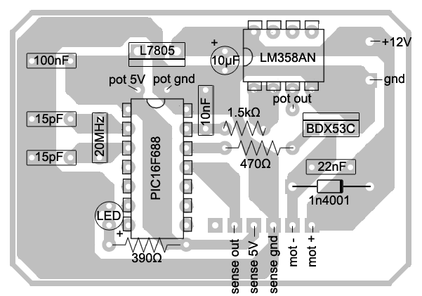

I have included the PCB at the end of the post and the components insertions are displayed on Figure 3. All the circuit does is read an analog voltage from the potentiometer, catch the encoder pulses (304 pulses/rev) using the “Interrupt 0” pin of the PIC16F688 microcontroller and drives a power transistor to turn the motor on/off for the PWM cycles. For the feedback command, I am using a simple integrator that update every 0.1 seconds.
The PICCLITE code is listed below. The microcontroller is set to generate a “Timer 1” interrupt every ~0.1 sec (using a 20 MHz crystal and a divider of 8) where it set a “process” bit to 1 to signal that an update is wanted. At each “Interrupt 0” event, a counter is increased to get the feedback (the count is reset every “Timer 1” event). In the main loop, the analog value of the command is read and the difference between the actual motor rpm and the command is taken to compute the updated PWM duty cycle. Finally, the “Timer 0” interrupts are used to generate a PWM signal with 1% accuracy in duty cycle (frequency about 1 kHz). Do not be surprised by the magic number 266 in the code, it is just the number of ticks in 0.1 sec intervals at 500 rpm (maximum motor speed at 12 Volts under no load).
