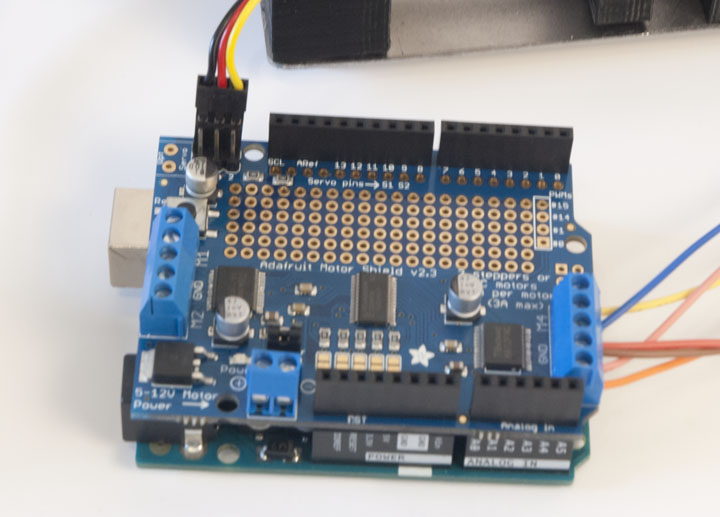

Then, stack the motor shield on your Arduino Uno and connect your stepper wires on the second stepper slot (M3/M4), just like on Figure 1. You want to connect the wires from the ST35 motor in the following order: yellow, bue, red + brown, pink, orange. Yellow/blue is the motor phase 1 while pink/orange is the phase 2. The red and brown wires are the ground of each phase.
In a later post I will show you how to connect a motorized flow selection valve, but it’s not for today so don’t pay attention to the three wires at the top of Figure 1.

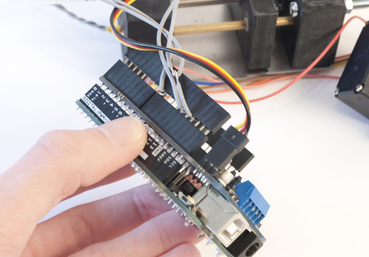

Next, you will have to put some stacking headers directly onto the motor shield. Here is the tricky part because you need to solder the push buttons from the syringe pump such that they will shunt pin 8 and pin 12 to ground. Check Figure 2 to see how it looks like. The button from the front part of the syringe pump should be connected to pin 8 and ground and the button from the back part of the syringe pump (the one close to the motor) should be tied to pin 12 and ground. If you are not comfortable soldering directly the wire on the stacking header you can use a Proto Shield for the Arduino Uno rev3.
The idea is that once the syringe pump triggers one of the button, the corresponding pin will be set to low voltage while in the absence of trigger, the pin is internally (in the Arduino chip) connected to +5V through a 20 kΩ resistor (weak pull-up). That way, we can detect a stop condition to prevent damaging the pump hardware.

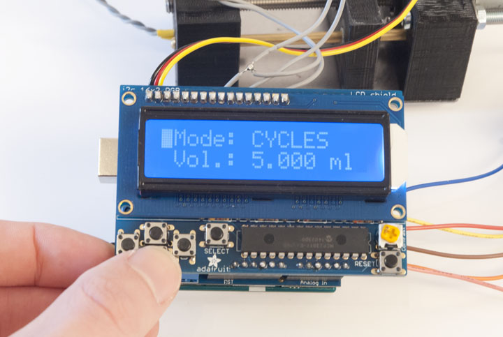

Finally, just plug the LCD shield on top and plug the 12V power supply into the Arduino. After uploading the program given below in the resources section, you should get the result of Figure 3. If nothing is displayed on the LCD screen, try turning the contrast potentiometer of the LCD shield as recommended by Adafruit.
You can travel the different options in the menu by pressing the up/down buttons. Then, press the left/right buttons to change the values. To start or stop the pump, press the select button.
If you are using a syringe with a diameter different than mine (12 mm) or a different thread pitch than M6 (1 mm), you can tune the value in the menu using the “Diameter” and “Pitch” vars. You can then select a flow rate, an injection volume and a working mode. There are three different working modes: push (inject), pull (withdrawn) and cycles which alternates push and pulls. In push/pull mode, the pump will automatically stop when the specified volume has been reached (e.g.: 5.000 ml on Figure 3) or when the stop buttons are triggered. In cycle mode, it’s a bit different because the stop conditions will not stop the pump but alternate the push/pull modes. So if you set cycles with 1.000 ml volume, the pump will first inject 1 ml then withdrawn 1 ml, inject another 1 ml and so on. By the way all the values you configure are stored in the Arduino EEPROM memory every time you press the select button.
