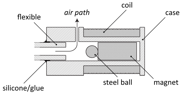

I propose here a method for the construction of an overpressure valve whose threshold is set electrically. The overall concept is to place a powerful neodymium magnet inside a variable magnetic field generated by a coil and to use the force acting on the magnet to close a hole from which air flows out of the pressurized tank. Technically speaking, the system can as well be used for negative pressure (vacuum) systems by pulling the magnet instead of pushing it. As I am mostly interested here in positive pressure system these days, I will focus on the push mode. Also, I will assume here that the air can be sent to the atmosphere and do not require any treatment.
A prototype assembly is given on Figure 1. A more advanced version for 3D Printer owners is given at the end of the document. A coil made from more than 1000 turns of 0.35 mm is wrapped around a plastic case and a 6x10mm neodymium magnet with a .177" shooting ammo steel ball is placed inside it. The flexible is conventional 4/6 mm silicone tubing. The steel ball should be slightly larger than the internal diameter of the tubing to have a good closure.
Figure 1 - Prototype Assembly.
When no current flows into the coil, the magnetic field is null and the magnet make no obstruction to the air which freely leaves the case by a small hole drilled on the side. The pressure inside the tank is almost the atmospheric pressure as the pressure drop is extremely small unless the compressor has a very large flow rate. After some threshold current i0, the force acting on the magnet is sufficient to overcome friction and the magnet moves toward the flow path and make obstruction to it. The coil pushes the magnet with a force F(i) but, on the other side, the air pushes on the magnet by the effect of the positive pressure inside the tank. As long as the pressure force will be bigger than the magnetic force, air will escape by the hole on the side of the case but, when the pressure force gets below the magnetic force, the valve closes and pressure can start accumulating again until a steady state is reached.

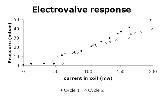

Finally, I have made some tests using a 200 mbar aquarium pump, the electrovalve and a manometer to monitor the pressure inside the tank. The current was increased by small steps and the pressures recorded. The recording was performed by first increasing and then decreasing the current to check for hysteresis patterns. The procedure was repeated twice and the results are given on Figure 2.
Figure 2 - Experimental results.
There is clearly a threshold current of about 50 mA required to put the magnet into motion. Beyond that threshold, the pattern is relatively linear which is good news because linear actuators make feedback easier. The only issue was that the steepness of the relationship seems to have changed from one cycle to the other. Also, it was difficult to have large pressure inside the tank without using high currents which made the coil heat up a little bit.
