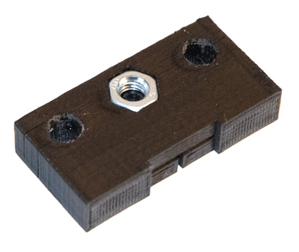

Tolerance fit
Fitting is, in my experience, the most frequent cause of having to discard correctly printed models.
When designing your part, you specify some width and height for the features of your model that are relatively precise. For example, you may want to add a hole for a φ3 mm pin. To do this, you usually specify on your drawing some tolerance for the hole such as “3H7” meaning that the hole should be between 3.00 mm and 3.01 mm. When working in a mechanical shop, this is usually machined using a reamer which will ensure, when properly used, that the hole will satisfy the tolerance. So, when inserting, say, a 3h7 pin whose diameter is toleranced between 2.99 and 3.00 mm, you know that the two parts will fit without problem. This will always be the case, even if your part is produced in the USA, China or in Japan by different operators.
But things do not work like that when printing 3D parts. When printing, you first produce a 3D model (usually a stereolithography .stl file) which is then transformed by a program inside the 3D printer logic into movement instructions for the extruder head. With Makerbot, this transformation occurs in the Makerbot Desktop program.
The problem is that Makerbot Desktop does not, at the moment of this writing, take into account any analysis of the shape of the elements to ensure fitting and tolerances. So if you produce a model with a φ3 mm hole, the printer will actually describe a φ3 mm circle and extrude filament at that place. And because the filament has some thickness, your hole will actually be smaller than φ3 mm. The question is by how much?
And there is no simple answer to that. Depending on the resolution of the printer (60 µm, 100 µm, 200 µm, 400 µm…), your hole will not be of the same size. Depending on the software which transformed your design file into machine instructions, your hole will not be of the same size. And even worse, I have experienced that different version of the Makerbot Desktop software will not print models the same way!
The consequence is that you have to include some knowledge of how your printer actually does its job when designing your parts. To do this, I have created a calibration file which is a disk with three rows of holes of φ3.00, φ3.05, φ3.10, φ3.15, φ3.20, φ3.25 and φ3.30 mm. At occasions, such as when updating the Makerbot Desktop software, I print the calibration file and try to fit some 3h7 pins into the holes. That way, I know by how much I have to increase the size of the features in my design. Currently, it is of 200 µm with the printer resolution set to 200 µm (nb: the Makerbot Replicator Mini is restricted by software to 200 µm at best – probably not to concurrence the more expensive models that goes down to 100 µm with the same extruder).
The final consequence is that you cannot exchange 3D models that easily with other people. Depending on the printer, your features may show too much clearance or too much interference. This is why I always recommend printing the models on this website with a 200 µm resolution; hoping that this will reduce the risk of bad fitting when printed with other hardware and software.
Obviously, what is true for holes is also true for any kind of feature. I had to print my cuvette holder 5 times before getting it right! And it gets really frustrating when you try to print older models which used to work and now do not fit the same way anymore.

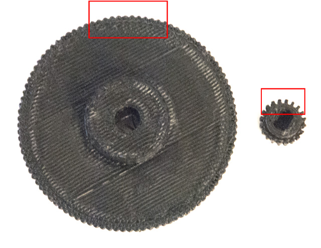

The thinest details that you can print
3D printers have limited resolution which is always mentioned as the thinnest layer they can achieve. This can be 60 µm for really good 3D prints, 100 µm for standard high resolution prints or 200 µm if you have the Makerbot Replicator Mini. By the way, and since the Replicator Mini uses the same extruders and the same technology than the more expensive versions of Makerbot’s 3D printer, I am pretty sure that this is only a software restriction and not an hardware limitation.
200 µm is not an extremely thin resolution as with the proper tools you can machine features down to 10 µm in a mechanical shop. Also, I have noticed some odd things with the quality of larger models. For example, check these two gears below. They have the same tooth size (2 mm) but different diameter. Notice the details in the tooth for the larger model.
My advice is then to avoid very large models and to keep the details on the order of the millimetre. DO NOT try to make very small details like small threading for fasteners and such. If you need thinner details, use a mix of 3D printing and hardware parts (bolts, nuts…) glued on the model.

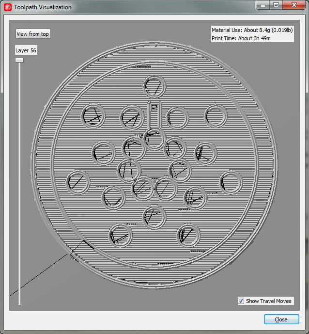

Control on the g-code
When you print a file, the design you sent to the software is first transformed into extruder movements operations, the g-code. With Makerbot, this occurs in the Makerbot Desktop software. The problem is that we have very little control on constraints applied to the algorithm.
This may look like a small issue but is actually quite boring when it happens in high precision models. Let us take, for instance, the holes calibration model:
The black lines represent the movement of the extruder head. You can see on the picture that the extruder head passes several times inside the holes. As a consequence, you will have some filament in your calibrated holes which is quite difficult to remove without damaging the actual (and precise) dimensions of our features. In the case of the calibration model, this results in slightly obtruded holes that will not accept the pin.
And this is the price you have to pay with all-in-one commercial solutions like the Makerbot Replicator: they act as blackboxes and you cannot prevent, at least for the moment, the software from putting filament inside delicate features such as our calibration holes.

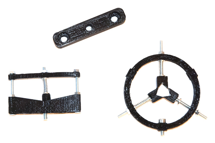

Stiffness of printed models when used in engineering
Because the models are made of plastic and may have an hollow structure due to the infill ratio, they do not have the stiffness or strength of metal parts. Also, by the very inherent process of deposition modelling, the parts are very brittle in their axial dimension and you can break them very easily. I broke a few parts that were designed to be screwed into each other using large threads.
About half of the models that I printed where designed to replace Thorlabs opto-mechanical components but due to the very low rigidity of the plastic, they never performed well at all and caught a lot of vibration. Even a small support designed to replace Thorlabs PJ301/M part made my interferometer completely blind due to the ambient vibrations which were amplified by the plastic piece. The same was also true for microscopy application.
This is a large issue for 3D printing because, in my experience, it is totally useless for optics; even when used as a base support for stiffer elements made in aluminium. On the picture below, a lot of wasted trials as reproducing opto-mechanical parts…

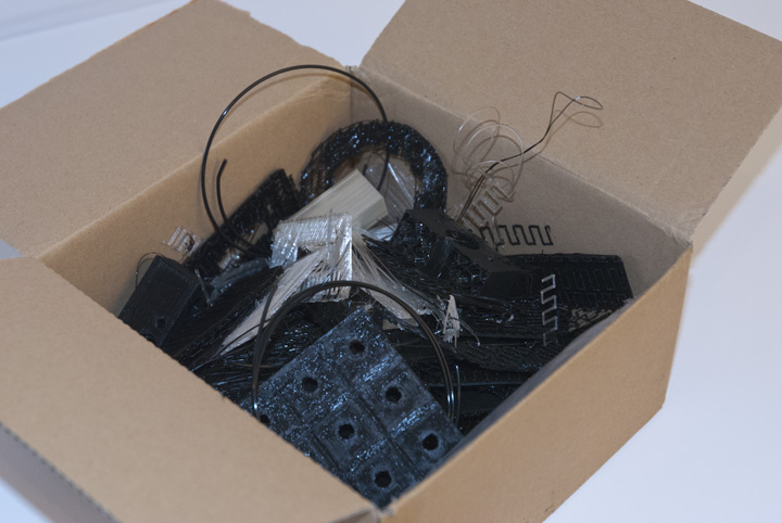

Failures
So far I have only talked about inherent issues with the technology but always assumed that the model would be printed correctly. In practice, you will dump a lot of parts because they will not print correctly. Not only this makes you waste money and increase the actual cost per model (as discussed in the previous section), but it will also make you lose a lot of valuable time. When your printing fails, you have no other choice than restarting the print. I have kept most of my failed attempts, in the case I might re-use the PLA one day. Here is how it looks:
Among the common source of failures are retraction of the model (see below), wrong fits due to the tolerance of the elements, extruder nozzle catching your model and scrapping your whole model, extruder clogging… In my experience, I had to discard between 25% and 50% of my prints. It is difficult to tell because I did not start collecting wasted prints since the beginning and the picture above only represents waste from about two small spools of filaments.

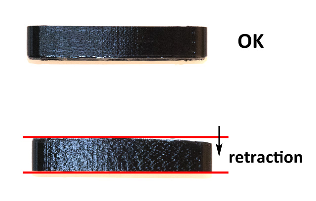

The most common and irritating failure source in my experience is the retraction of the model which happens often with larger parts (> 5 cm). When your plastic cools down, it slightly retracts and if the base of the model does not adhere firmly on the printing plate you will get something like this:
Sometimes you can live with it, sometimes you just have to dump the part.
Solution to this problem are heating the base plate, applying a layer of ABS through a ABS/acetone mix on the base plate when printing with ABS etc. None of these methods are available with the Makerbot Replicator Mini so you will have to live with it and replace the adhesive paper on the base plate often to keep a good adherence of the support. The price is not that big, but you have to remember to do it often to prevent model losses.
