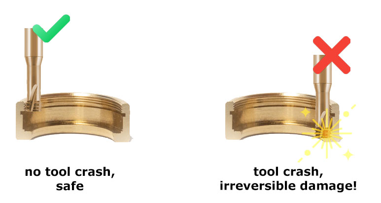

Tool crash detection is an important topic in CNC machining because a small mistake can often lead to the irremediable destruction of an expensive piece of equipment, not even to mention scrapping up your part completely. A typical mistake is to drive a threading mill – a very delicate type of mill used to machine threads – into a hole that wasn’t drilled yet! The consequence of such mistakes is usually the loss of a 200€ tool in addition to lots of wasted time. Similar observations can be made with t-slot cutters, round endmill, chamfer mills etc.
The fundamentals of tool crash detection is relatively straightforward: detect if a tool plunges or moves laterally into unmachined stock when it shouldn’t. The main issue, however, is that we do not want to test for tool contact at the tip, or center, of the tool but on the complete tool diameter (or shaft diameter). The question is therefore whether the machining coordinates approaches stock by some distance Dmin.
Tool crash of a thread mill is illustrated in Figure 1 for my lens mount part. Various crashes can occur here: plunging too deep, moving too much laterally, swapping the operations order (e.g. machining the thread before pocketing the part) etc. Our tool crash detection must handle all of these.
Figure 1 – dramatization of the tool crash detection problem
This problem can efficiently be solved by turning to signed distance functions (SDFs) which makes the body of this post.

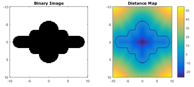

The most straightforward approach is to construct a binary map from the CNC primitives (pocket disk, pocket rect, path slot etc.) and to apply a bushfire algorithm to the resulting image or any distance map generation algorithm. In the bushfire algorithm, we assign all values that are ‘1’ in the binary mask to the distance 0 and add all other points to a waiting list. We then propagate the distance from all the pixels that have distance 0 to the pixels within the waiting list by assigning neighboring pixels the distance value 1. We continue this process until there is no pixel left in the waiting list. The resulting SDF is shown in Figure 2.
Figure 2 – SDF from the bushfire algorithm
Although this may work fine in controlled environments, this method pose a risk in terms of memory usage when opened to external users. Since we would like to probe for a distance Rmin, we need to have a resolution of at least Rmin/2 on the distance map. Most tools are usually larger than 1 mm but we don’t control the size of the input binary map which is a function of how large the stock being machined is! Unless you restrict the maximum stock dimension, you run the risk of using a lot of memory. For instance, a stock of 400×300 mm with a resolution of 0.5 mm represents already at least 1 Mb of data. Larger stock, and, more importantly, finer resolutions, will quickly saturate your memory – especially if you allow multiple users to run tasks in parallel.

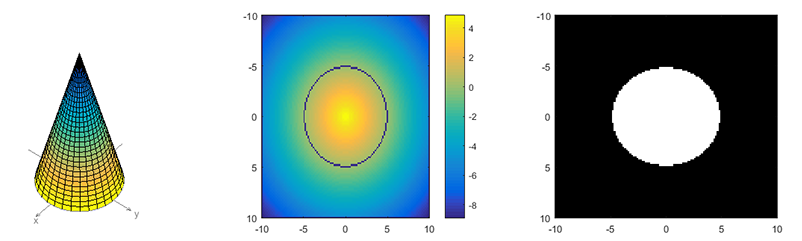

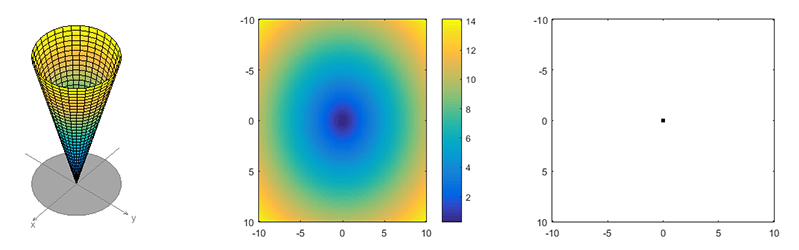

The most basic distance function I can think of is the distance to a point located at (0, 0) which is shown in Figure 3 and has expression f(x,y)=√(x²+y²). You can see a 3D plot of this distance function on the left, a top view at the center and a binarized version on the right showing only values that are inside the shape (f(x,y) ≤ 0). Note that a point don’t really have an interior, but I deliberately represented it as a single dot in the binary image here.
Figure 3 – SDF of a point

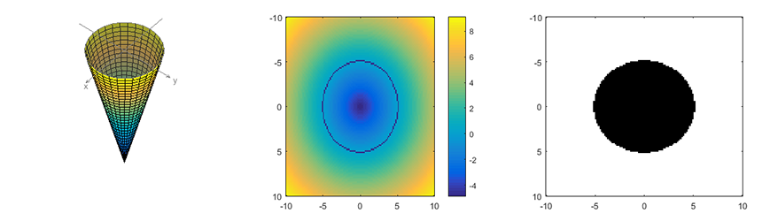

The function of Figure 3 has radial symmetry and can be used to generate many more SDFs. For instance, subtracting an offset from this function yields a disk as shown in Figure 4. This change comes from the fact that we defined the object as being all the points where the function is lower than or equal to zero. The effect of the offset is better seen on the 3D plot where you can compare the intersection with the zero plane.

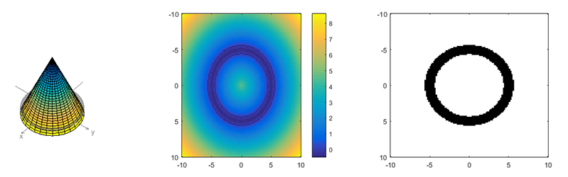

Fortunately, we can turn our disk SDF into a circle SDF using the absolute value of the disk function:
This function has no more “inside” but only an outside as all values are positive. We still have an edge however represented by f’=0, leading to a circle shape instead of a disk shape.

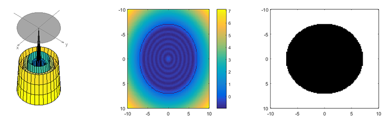

But we can now grow this new object by the diameter of the tool using the grow/shrink function:
This new function is shown in Figure 6 and can be generalized to any SDF functions (square, lines, polygons etc.). I’m calling it the toolpath SDF transform operator.

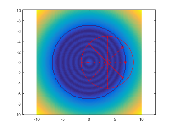

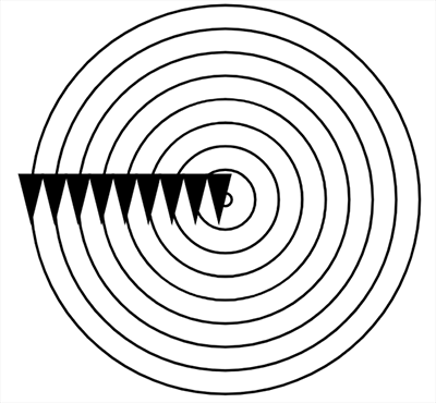

Imagine you have a series of concentric rings machined with a tool of diameter D1, making a pocket of diameter D > D1 as shown in Figure 8 We now want to know if we can insert a tool of diameter D2 into the center of that pocket. If D2<D that should succeed but, since we are testing for the minimum of D2 against all toolpaths of width D1, the test will systematically fail when D1<D2 and will sometimes fail/pass when D1>D2.
Figure 8 – Concentric circles problem
We therefore need to patch our test function such that it can handle spurious failures like this one. Note that if the test succeeds (i.e. if F>-D2/2) we are sure that all toolpath edges are farther than D2 and that the tool can be inserted safely. We only need to patch the case where the test fails when it shouldn’t have.
To figure out how to patch the test function, recall that our goal is to answer the question “is this a safe place to move our tool to” which can be rephrased as “is the stock edge farther away than distance D2/2 from this position?”. If our initial test fails, we then need to check if that was a spurious failure by checking if we can actually find a stock edge within a radius of D2/2.
To check for edges within a radius of D2/2 (plus some safety margin), we can throw rays in all directions from the test point (x,y) and test if we find the condition F=0 within some radius D2/2. We can use the ray-marching algorithm here to trace the rays to edges. The algorithm is relatively straightforward: we sample the worst-case, approximated, distance to an edge at the current point location and moves forward by that amount. If the function was correct, we should land closer to an edge, and we can continue the process until we reach |F|<ε. If the function was not correct, we get another worst-case distance to try and so on. The algorithm should quickly converge and we can safely skip testing once we have already travelled by more than D2/2.
This leaves the question of how many rays to trace; more rays leading to more accurate results but being also more CPU intensive. Here I opted to check every D2/2 arc segments on a circle of diameter D2. Since this circle has perimeter πD2, having segments of maximum D2/2 requires N>2π rays. I chose N=8 as it aligns with the principal axis of my systems and its diagonal. Note that this approach is by no means compulsory and you can choose the number of rays cast you want.
This process is illustrated in Figure 9. Each dot represent an intermediate position in the raytracing and intersection with the shape edge are shown as small red circles. In Figure 9, the tool would contact the edge of the object – indicating a true collision.

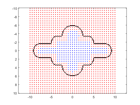

This algorithm used to generate the inner points inside an SDF is illustrated in Figure 7 where the inner points are marked in blue and the outer points in red. Note how the inner points are offset from the shape edge to account for tool diameter during the pocketing operation.
Figure 10 – Inner pocketing of a polygon using SDF

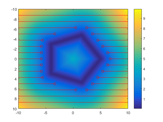

For simple convex shapes, I also implemented a different approach for outer pocket (contour) operations. Here, I move the tool horizontally until I intersect the SDF expanded by radius D/2 (plus some margin), before backing up and moving to the next horizontal movement. As the tool reaches the bottom of the bounding box, I then perform the same operation but on the right face of the shape. Again, the outer edge path is traced for a clean finish of the shape.
This second algorithm is illustrated in Figure 8. Note on the figure how the tool stops on slanted lines – something that would have been very difficult to implement using standard line intersections algorithms!
