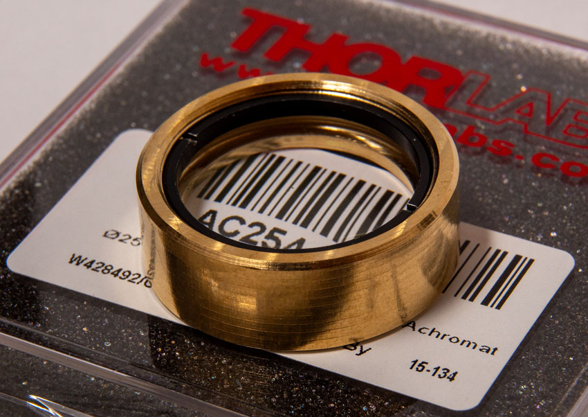

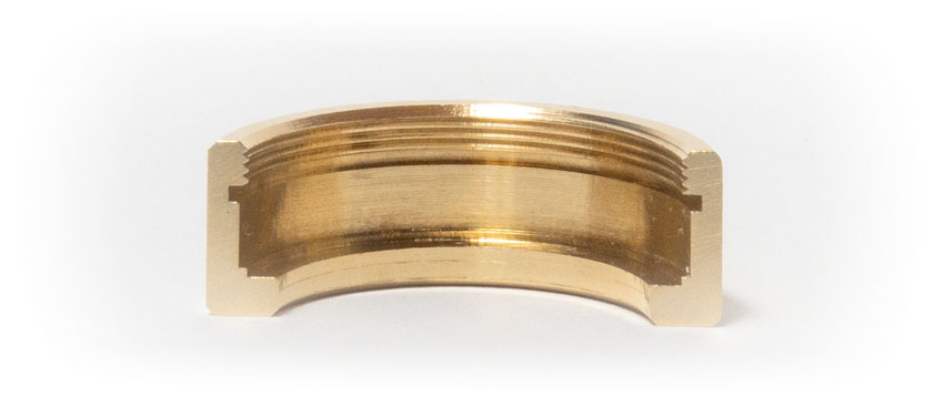

In this post, I show how you can manufacture lens mounts yourself using rapid manufacturing techniques. An example is given in Figure 1 with a mount designed for a Thorlabs AC254-100-A doublet achromat lenses and an outer bore of 30.50 mm compatible with Thorlabs tube mounts. The part was made in only 3 hours and required 6€ of stock material.
Figure 1 – 100 mm lens mount
A cut-out of the lens mount of Figure 1 is given in Figure 2. You can spot the different features composing the parts including chamfers, thread (1.035”-40), thread-relief and internal bore.
Figure 2 – Cut-out of Figure 1

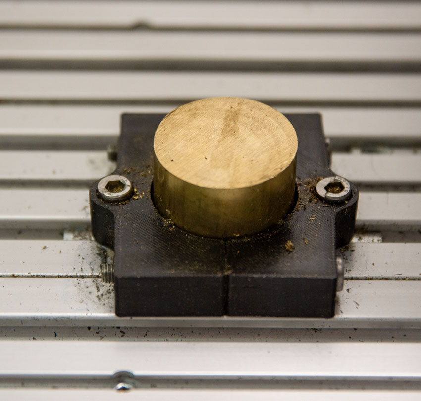

The first step was to cut a rough stock from the brass cylinder, 31 mm long in my case. This is pretty long considered that the final part will be 10.5 mm thick only but is due to me lacking a proper vise to hold the stock. To avoid spending more money on this experiment, I choose to 3D-print a clamp in PETG to secure the part. Since PETG is not metal, I made it super thick to be sure that it would hold the stock firmly during the machining process. PLA is excluded because it would soften during the machining process.
Figure 3 – 3D-printed clamp used to secure the part

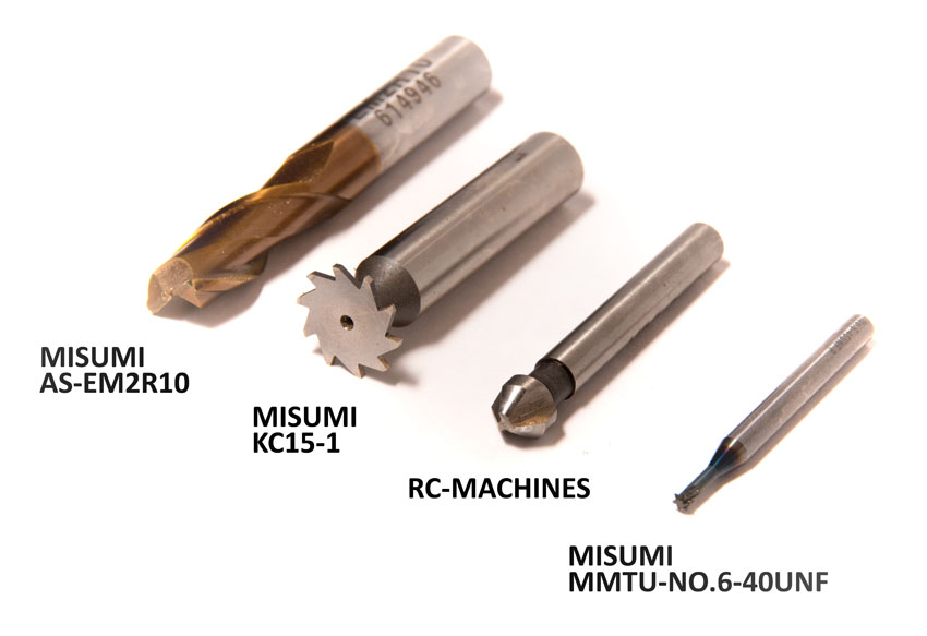

Most of the job will now be done using a standard square-cut end-mill. Here, I’m using MISUMI AS-EM2R10 10 mm end-mill. All the tools required by our CNC program are shown in Figure 4.
Figure 4 – All tools required by our CNC program

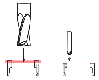

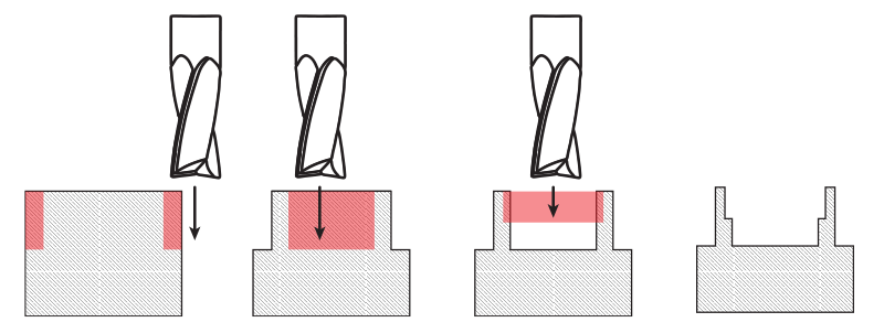

Using the 10 mm end-mill, the program will first face the top of the part to get a clean cut perpendicular to the machine axis. It will do 0.5 mm passes with a 0.1 mm finish pass at slow speed. Once the part has been faced, the outside of the stock is machined down to a diameter of 30.5 mm on 14 mm (10.5 mm + some margin required for the stock cut). This is done using passes of 1 mm, with 0.2 mm finish passes. Similarly, the inside of the part is machined using the same CNC mill. First, a through-hole diameter of 22 mm is done for the aperture. Second, a 8.03 mm deep hole is done for the lens and thread. The different operations are shown in Figure 5.

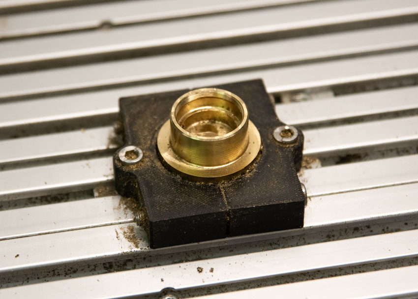

Figure 5 – Outlining the part using the 10 mm end-mill
Because we use the same tool without removing the part from the clamp, we should be able to access precise concentricity and perpendicularity of all the machined faced. By measuring the exact diameter of the end-mill it is possible to achieve accurate dimensions for the inner and outer faces without modifying the program – simply put the exact diameter in your tool properties tab in your CNC controller. If you aren’t sure on how to set this up, wait for my upcoming post.
Also, this program uses pulses of coolant/lubricant to achieve a cutting speed of 1000 mm/min. If you don’t use coolant, it would be wise to slow the speed down to 100 mm/min. Alternatively, you could use POM plastic instead of brass for your part but accuracy will suffer due to the clamping action on the part that will deform the plastic during machining.

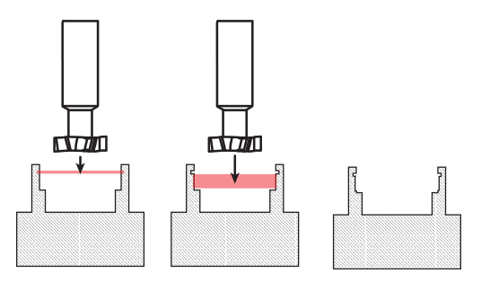

Now that we have our part outlined pretty much, we can machine the thread relief slot and the internal lens gap as shown in Figure 6. On a lathe, machining the lens gap would have been a walk-in-the-park action but on a mill things are a bit different. I’m using here a large T-slot cutter from Misumi for that job. Because of the shaft dimension, we can safely go up to 2 mm within the part using this tool, but as a downside it requires an initial hole diameter of 16 mm or larger which makes it impractical for lenses smaller than 1”. Other T-slot cutter might be necessary for smaller lens mounts.
Figure 6 – Slotting the part
Since T-slot cutter are delicate tools, I used a fairly slow 100 mm/min cutting speed here. Also, I stop the tool 0.2 mm before reaching the end of the part to avoid crashing the part into the aperture rest. It should be possible to use less than 0.2 mm but I wouldn’t try exceeding 0.1 mm even with precise measurements of the tool thickness as the tool change procedure itself has limited repeatability.
To clean sharp edges, the program then uses a chamfer mill in two passes of 0.25 mm each. Here, I’m using a 8 mm chamfer tool from RC Machines for which I didn’t find much reference unfortunately as I had the tool lying around for quite a while now. This operation is shown in Figure 7.
Figure 7 – Chamfering the part

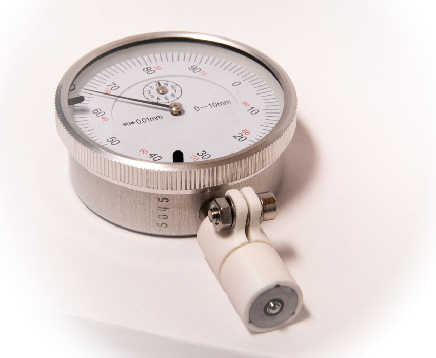

Chamfering is somewhat of a tricky operation because you want the edge of the tool to follow a given path with high accuracy. What I do here is that I use a 5 mm reference disk as the cutting portion of the tool and measure by how much I have to offset all Z coordinates to get to this 5 mm reference disk. To assist me in measuring this depth, I made the tool of Figure 8. The (important) take-away is that the program requires you to set a 5 mm diameter for the chamfer tool you use and that the Z coordinates in the program assumes the tool reaches that 5 mm reference diameter. More on that in my upcoming post on CNC machining.
Figure 8 – Chamfer measuring tool

To get a smooth finish, I put the part into a rotary tumbler for 1 hour – here a Lyman Cyclone with Lyman Turbo Sonic cleaning solutions. You can get these tools from various distributors, including shops like Amazon or Brownells (I got mine there). A final wash with isopropyl alcohol allows the part to dry very quickly and remove any eventual remaining dirt. Some caveat however is that the pins of the Lyman Cyclone got stuck in the thread relief groove and I had to remove them with a pair of tweezer. Making the groove slightly deeper could resolve the issue.
The total time to produce the mount of Figure 1 was 3 hours, including the 1 hour washing time. Using the CNC-STEP CNC mill with the KineticNC controller, it is possible to produce up to 6 of those parts in parallel to gain time – more than enough for a typical optical system. That means you can get a complete stack ready in less than 24 hours and for less than 50€ in stock material! Pretty awesome, isn’t it?

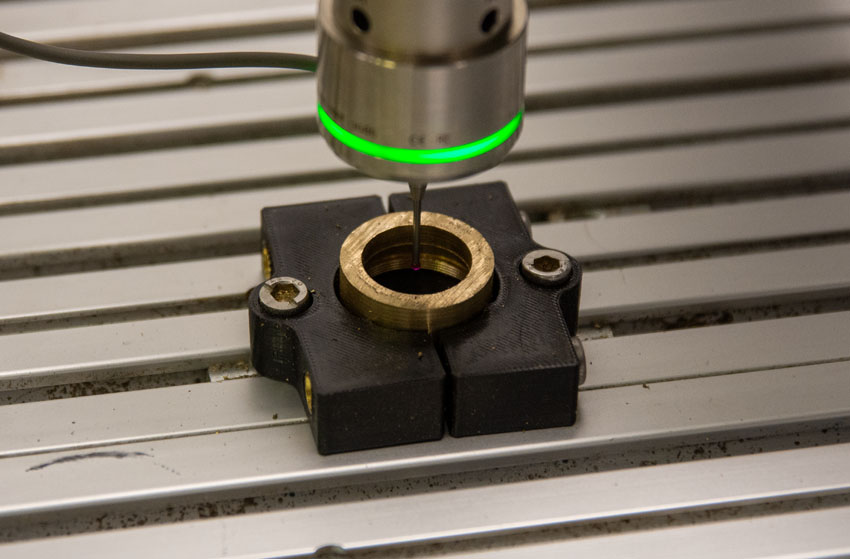

In terms of tolerances, I did not have much accurate metrology tooling but I measured a parallelism of 0.005” (0.13 mm) using a RCBS Case Master. I cannot measure perpendicularity, but I assume it should be relatively good knowing the manufacturing method. The parallelism error is probably due to the machine squareness and the part positioning. It is worth noting that I made multiple parts for this post and obtained down to 0.03 mm parallelism which makes me believe the issue comes from the clamping action.
The overall thickness of the part is directly affected by the parallelism of the front and back faces but the mean thickness was 10.51±0.06 mm which is very close to the target of 10.50 mm that was programmed in the machine. I measured the distance between the front face and the lip using my Mitutoyo D15FX caliper and obtained 8.03±0.01 mm, exactly as specified in the machining program. This excellent parallelism leads me to think that the perpendicularity of these faces are around the same order of magnitude even though I cannot measure it directly.
I measured the outer and aperture diameters using the same caliper and obtained 30.51±0.05 mm and 21.88±0.05 mm respectively. Measuring the inner diameter using a caliper is not easy and I am a bit surprised by the result compared to the much more accurate outer diameter. More investigations have to be carried out on this but they would require a bore gauge which I don’t have (see end of post!).
Measuring the concentricity of the aperture was much more challenging but the thickness difference between the OD and the aperture diameter seemed to be around 0.002” (0.05 mm) using a Redding Wall Thickness Gauge. Since this thickness takes into account both the circularity of the outer and inner diameters as well as the concentricity, we can assume that the concentricity is probably much better than 0.05 mm. Considering the mean outer diameter, I would expect that the concentricity is on the order of 0.01 mm but I don’t have measurements to backup this claim.
Among the defects, the back face had a 0.002” (0.05 mm) step due to the facing operation where either the part or the tool moved during operations. Better clamping or smaller depth passes in the facing operation should alleviate the issue. Also, a ~0.1 mm thick bump has been found on the outer diameter which most probably results from the toolpath approximation in constant speed mode. More investigations have to be performed on that as well and will be addressed in my later post on CNC machining.
