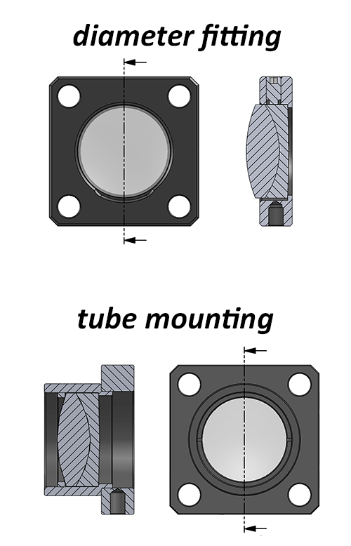

But before we delve into the intricate details of cell mounting, it might be important to understand why “standard” mounting is not desirable – or, more specifically, when it is not desirable.
When assembling breadboards using off-the-shelf components, you will encounter two main mounting strategies: diameter fitting, and tube mounting. In the former solution, the lens is inserted into a mount and secure by its outer diameter using a set screw. In the latter, the lens is inserted in a threaded tube and secured using retainer ring. Example of diameter fitting at Thorlabs are the CP35-type mounts and example of the tube mounting are the CP33-type mounts which are both represented in Figure 1.
Figure 1 - Diameter fitting and tube mounting at Thorlabs
If you have read my former post on the effect of tilts and decentering in lens systems, you already know that holding a lens by its diameter is a recipe for catastrophic optical performances. Due to the manufacturing process of lenses, there is no guarantee that the axis defined by the outer diameter of the lens perfectly matches the natural optical axis of the lens formed by the line joining its two centers of curvature. When you slant or decenter a lens optical axis in regards to the light rays, you generate asymmetrical aberrations such as coma and astigmatism which degrades image quality.
But holding the lens by its outer diameter also has consequences in the thermal stability of your system. When increasing the temperature, either during operations or during storage, the lens mount will typically grow faster than the lens because the thermal coefficients of expansion of metals are usually larger than those of glasses (to be checked on a per-case basis!). At some point, there will not be enough tension to hold the lens in place and the lens will become free to move, leading to potential misalignment or even fracture with small shocks. Even worse, when the temperature decreases, the lens mount will shrink faster than the lens. At first, the tension of the set-screw will increase but as the temperature keep decreasing, the gap between the mount and the lens might disappear and the metal will then start pushing extremely hard on the glass, generating massive Hoog forces. This will result first in a decrease of optical quality due to birefringence, and will end with a catastrophic failure of the lens itself (i.e. the lens will break!).
Finally, by clamping the lens using a set-screw, you generate a relatively uniform vertical stress throughout the lens. By deforming the glass lattice, even minutely, the material becomes anisotropic leading to different refractive indices in the direction of the stress and perpendicular to the stress. This effect, known as birefringence, is generally considered as being problematic for polarization-sensitive setup only, but the truth is that it affects all optical systems by creating astigmatism (different foci along the stress direction and its perpendicular).
These are the main reasons why you should never hold a lens by its diameter outside the scope of a laboratory breadboard that will not encounter temperature variation during its storage or operations.
Tube mounting of lenses solves many of these issues: pressure is applied axially through the retainer rings, leading to less problematic birefringence, a sufficient gap between the lens outer diameter and the mount is usually present and, when being mounted, the lens will spontaneously align to its natural optical axis.

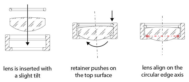

Figure 2 illustrates the process by which the lens aligns with its natural optical axis during mounting (I call here “natural optical axis” the axis formed by joining the two center of curvature of the lens, independently of the lens mechanical shape after manufacturing). As pressure is uniformly applied by the retainer ring, the lens will rotate in the mount until the center of curvature of both of its faces aligns with the axis of pressure generated by the mount and the retainer ring.
Figure 2 – Spontaneous alignment of a lens with its natural optical axis
The tube mounting strategy looks more promising, but some caveats need to be identified. While it is true the lens will align with the pressure axis generated by the mount and the retainer ring, there is currently no control on where the axes are in regard to each other’s but also in regard to the mount itself. The cell-mounting of lenses method answers this question by introducing tolerances on the different elements.

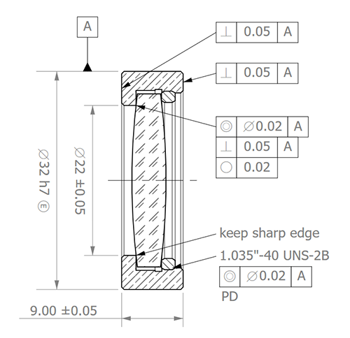

Figure 3 shows a typical cell-mounted lens. While it is very similar to the tube-mounted version, we see that each surface is tightly controlled through a series of tolerances. Multiple cells can then be inserted into a toleranced barrel (typically G6 inner diameter) and have all their natural optical axis matches each other, as well as getting precise control on the inter-distances of lenses.
Figure 3 – Typical cell mount of a 1” lens
The being said, not all lenses will center using this process. According to Paul Yoder in “Fundamental of Optomechanics”, a lens will center only if the following condition is met
where the yc and R are the contact heights and radii of curvatures of the lens, and µG is the glass-metal friction coefficient.
Still following Yoder, uncoated lenses have friction coefficients around µG≈0.15 but coated lens can have higher friction coefficients (MgF2 coating on black anodized aluminum is reported to have µG≈0.38). Concave surfaces have negative radii of curvature in this formula, making meniscus lenses difficult to self-center. It is therefore important to always have a look at this formula before deciding to mount the lens using this technique.
I did not find the mathematical derivation for this formula but y/R being the angle of the lens at height of contact, I assume this has something to do with a condition where normal pressure on the lens transforms to torque through the friction coefficient. If you have more information on this, please share them on the community board.

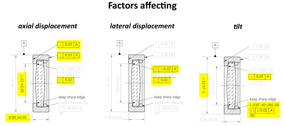

If we consider that the reference coordinates system is the axis defined by the outer diameter of the cell, we can state that:
(1) The tilt of the lens is driven by the perpendicularity of the lens-cell interface with that axis relative to the diameter of the circular interface;
(2) The lateral displacement of the lens is driven by the concentricity of the lens-cell interface with the reference axis;
(3) The axial displacement of the lens is driven by distance between the lens-cell interface and the front surface of the cell.
Furthermore, when mounting multiple cells in a barrel, we also need to account for the tilt of the cell itself and the overall thicknesses of each cell as they are stacked together.
The typical tolerances annotations required are summarized in Figure 4 for axial displacement, lateral displacement and tilt.
Figure 4 – Tolerance annotations for axial displacement, lateral displacement and tilt
Identifying the tolerances to use for a given system is a back and forth process between optical design tolerance simulations and machinability of the cell. The value given in Figure 4 are a good start for common lenses and lenses systems but should be refined depending on the optical design sensitivity. As this goes beyond the scope of this post, I will leave it for later.

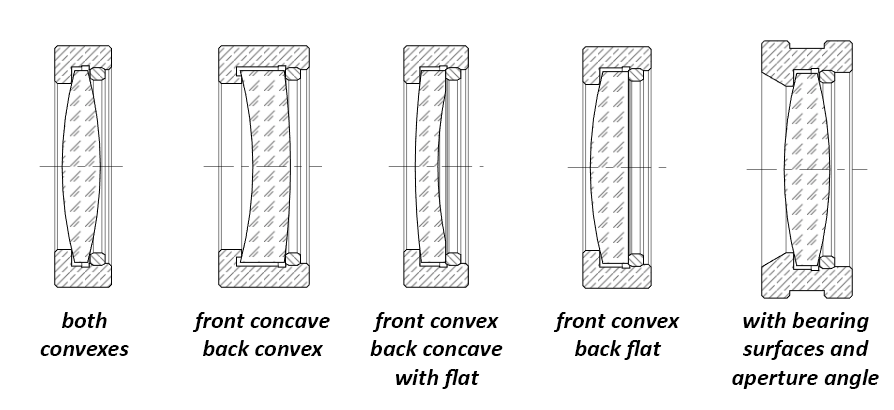

Figure 5 illustrates different mounting scenarios that you will face during a typical design. I would recommend putting the most curved surface on the cell side although I do not have evidence to show that it gives higher precision. Using concave surfaces is possible, but you need to introduce a lip in either the mount or the retainer, as can be seen in Figure 5. When mounting a very thick lens, such that the cell becomes relatively long, it is customary to introduce bearing surfaces to facilitate cell insertion in the barrel and avoid over-constrainment (see Figure 5). Finally, when pushing against a flat surface, remember that the lens will align relative to the perpendicular of that face – so check with your lens manufacturer what tolerances they can offer on the flat surface in regards to the optical axis.
Figure 5 – Different lens mounting scenarios

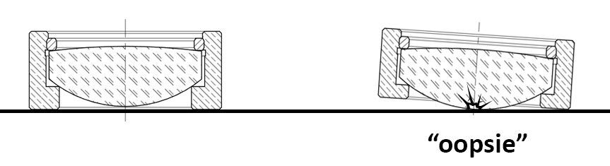

One last tip that I can give when designing cell mounts is on lens protrusion from the cell. If possible, you should avoid having convex surfaces leaving the cell because it is very tempting to put the cell flat on a table – in which case you are very likely to damage your lens as shown in Figure 6. A gap of at least 0.5 mm between the lens vertex and the cell front or back face is a good starting point for your design. It is however not always possible to prevent the lens from protruding, typically when you need to stack two cells, one with a convex surface and the other one with a concave surface. If you let the lens protrude from the cell, always lay the cell on the safe side. The danger arises when the lens protrudes by a very small amount only because it will not be apparent at first sight, and you will therefore pay less attention when handling the mounted lens. My recommendation here is either not to let the lens protrude, or to have it protrude by such amount that it can easily be spotted during handling.
Figure 6 – Example of lens protrusion from a cell

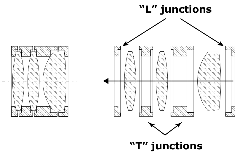

Up to now we essentially focused on mounting single lenses (e.g. for a simple telescope), but we did not discuss how to deal with lenses assemblies. While it is perfectly valid to stack multiple cells on top of each other, you may have trouble with lenses that are very close to each other. An alternative is to divide the cell into multiple parts such as shown in Figure 7. Th stack is now composed of what I call L-junctions and T-junctions, from the shape or their respective revolution profiles. The stack does not hold tight by itself, so it requires being mounted in a barrel with a lip at the front and a threaded section at the end to mount a thick retainer ring.
Figure 7 – Assembling multiple lenses
L/T/L stacks are very common in optics but lack some advanced features that single cell offers. We saw that, because of the machining tolerances, the alignment between the lens natural optical axis and the cell outer mechanical axis will never be exactly the same. I also said that optical simulations were required to determine what tolerances were acceptable for a given optical design. It happens that, for some very sensitive systems, the tolerances are still too tight to be obtained through conventional machining and mounting procedures. To address this problem, it is possible to mount the cell with its lens on a high-precision lathe that can adjust its spindle axis to the natural optical axis of the lens and to rectify the cell such that the mechanical axis and thicknesses correspond to the required ones down to a fraction of arcmin. The process is expensive and needs a very specific lathe that can locate the two centers of curvatures of the mounted lens with high-precision. When such methods are used, it is common to bond the lens in the cell using special adhesive to avoid the lens from getting loose (or be unmounted) which would screw up the complete rectification job in an irreversible way. Bonding lenses goes beyond the scope of this post as it requires a precise gap between the lens and the cell to accommodate thermal changes.
