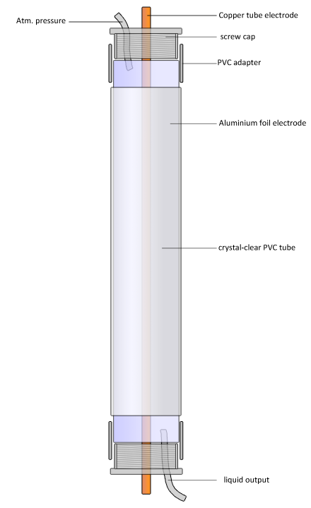

I have used a crystal-clear 50 mm diameter, 60 cm long PVC tube covered with aluminium foil on its outside. An internal 8 mm copper electrode tube was fixed in the centre of the PVC tube and isolated from the fluid using flexible 10 mm PVC tubing. I first tried without the flexible tubing but the results were catastrophic as the whole water started acting like a conductor itself and the results were just unusable for liquid level measurements. The assembly is given on Figure 1. The setup presented here has the big advantage of having a coaxial form which is less sensitive to surrounding perturbations (i.e.: moving next to the tank should not affect the reading).
Figure 1 - Tank assembly.

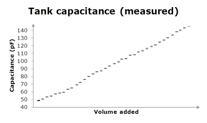

Once everything is in place and well glued with a lot of silicone (really, a lot), the tank capacitance is filled with water by known amounts. The capacitance was recorded after each water addition and a graph was then plotted on Figure 2.
Figure 2 - Tank capacitance.
Results Analysis
Let's now try to make some sense with the data.
Clearly, the capacitance-volume relationship is relatively linear with a globally satisfying linear fitting (r2=0.9977) and an average 1.5% deviation to the model which is expected given the resolution of the sensor in a noisy environment. On that side, we can say that the device is working fine. But what about the boundary values for Ca and Cb? Do they match our expectations?

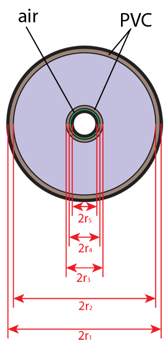

To explain that, we have to refine our capacitor assumptions with some more advanced maths. Figure 3 represents a transversal section cut of our capacitor with the outer aluminium shell followed by the PVC tube, the empty space designed to be filled, a second PVC tube, some air gap and the copper electrode.
Figure 3 - Transversal section cut of the capacitor.
Considering a perfectly radial electrical field (that is, we neglect border effects at the top and bottom of the capacitor), we may write Gauss law as
The electrical field magnitude at a distance r from the centre for the whole length l of the capacitor is then
Knowing that
We have
And so,
Finally, by definition,
The integral can then be split over the various materials:
Which gives a formula for the capacitor:
Using our assembly values we now find a capacitance range going from 15 pF to 86 pF (air/water). The span is then about 71 pF compared to the 100 pF obtain experimentally. This is much closer to what we observed and the small difference can probably be explained by the relatively high impact of r4/r5 air gap on the calculation. Also, there is a slight difference between the Ca value between theory and experiment (15 pF vs. 50 pF) which I believe is due to the capacitance of the wires going from the probe to the sensor.
