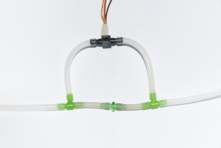

The idea is to use the viscosity of the fluid to create a small pressure drop across a small orifice such as shown on Figure 1.

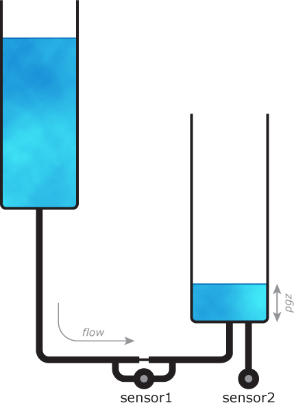

The idea is to connect two tanks together by some tubing and to place one above the other to force the first tank to empty its content in the second. With a good placement of the tanks, we are able to browse the whole range of flow rate from a maximum value to almost zero. By monitoring the volume of liquid in the tanks and the sensor output in the connecting tube, we may obtain a lot of data in a single experiment. The concept is shown on Figure 2.
To monitor the volume in the tanks, I have simply used a second pressure sensor (the circuit is built the same) to monitor the hydrostatic pressure of the fluid in the second tank. By using a tank with constant shape (such as a cylinder), we may derive the volume directly from the sensor output. However, this is not as accurate as it may seem because we should select a tank large enough to prevent the flow rate inside the tank to be too large. Bernoulli law states that the pressure is equal to hydrostatic pressure plus a term dependent on the speed of the fluid: P=ρgz+½ρv2 so if we want to read z (the height) from P, we should try to have ½ρv2<<ρgz.

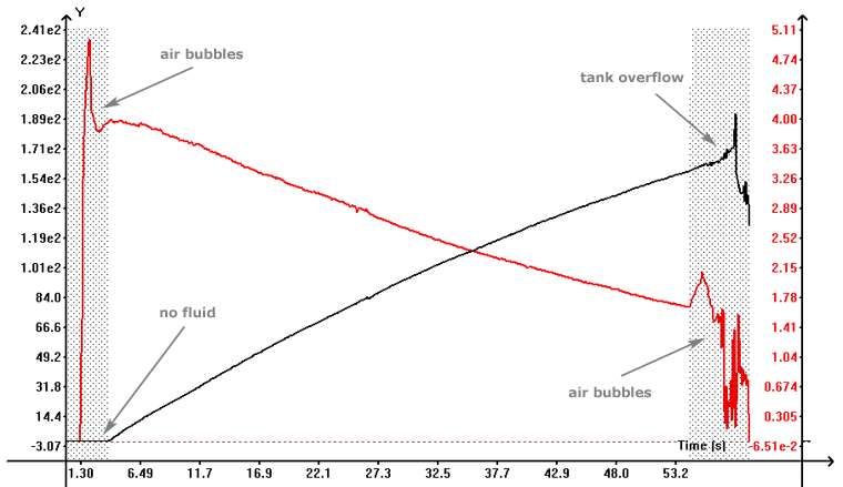

The result of an experiment is shown on Figure 3. The beginning and end of the data should be discarded because of experimental issues.
Figure 3 - Black = hydrostatic pressure; Red = flow sensor.

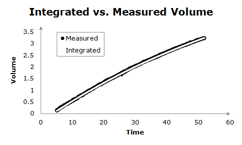

We may then check the validity of the model by plotting the expected volume (integrated from the data and our model) and compare it to the second sensor output. The result is given on Figure 5.
Figure 5
The integrated curve perfectly fits the data so we know that our model does correctly represent the flow behaviour over the range tested.

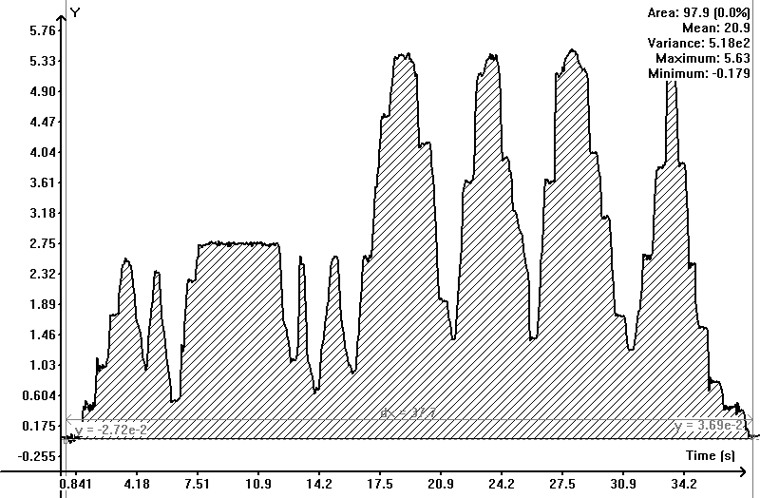

Finally, I tested the sensor accuracy by modulating the flow rate with a valve and weighting the total amount of fluid. The flow rate is shown on Figure 6.
Figure 6
A total volume of 100.5 ml was measured experimentally and the integrated flow rate gave an expected 97.9 ml resulting in a 2.5% error. This can be considered as an extremely good result and the error can be explained by the Bernoulli phenomenon discussed previously.
