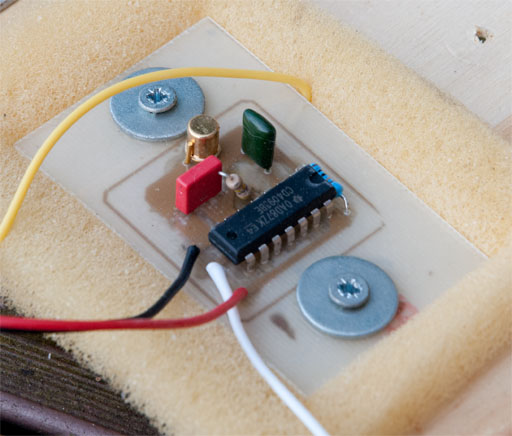

I have tested several technologies for the targets themselves. At first, the idea was to have no moving parts so I tried to build something around a “tilt sensor”. A tilt sensor is a circuit that detects impacts. In its most basic version it is made of a gold casing with a small metallic ball inside that connects two wire. As the sensor is shaken, the ball will move into the casing and open/close the electric circuit. Most of the anti-theft systems used to be built on this concept. Because there is no guarantee that the tilt sensor will be closed or open at rest, you cannot use it as a simple push button to detect an impact. Instead, you should be looking for changes in the signal. By placing a capacitor in series with the sensor, you will get spikes everytime the ball bounce into the casing. The more powerful the impact, the more spikes per second. Using an RC circuit as an integrator, you will get an output voltage that is proportional to the actual impulse received. Comparing this voltage to a fixed constant you can get an ON/OFF I/O state for a target hit. A photography of the tilt sensor used for the test is shown on Figure 1.
This does work but is, in my experience, way too sensitive for shooting, even with airsoft guns. The impulse transferred to the tilt sensor is much too large and the ball takes too much time to lose its energy resulting in a target that stays on for too long. Also, with time, I have noticed that these sensors tend to switch for almost no reasons! Seems like they do not like strong impulses… Nevertheless, they have shown to be working even with high power air guns at close distance.

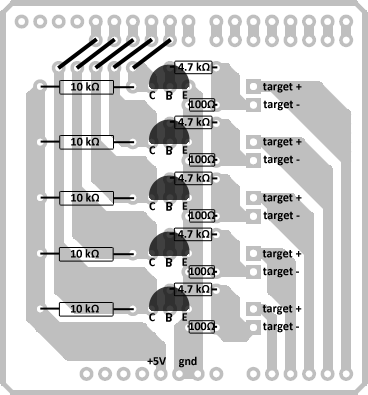

In our electronic shooting target systems, the controller will pick up a target to shoot at and wait for a hit or miss condition. To clearly identify which target should be aimed at, each of them has a bright LED that turns on when the target is active. It is possible to combine these two behaviours (LED plus hit sensor) using a single circuitry as displayed on Figure 2.
The LED and the pushbutton are connected in series and inserted in a transistor-based logic. Two cases should be distinguished: when current flows through the target and when no current flows. A no current condition will happen when either the target is disabled (no current is then sent from the controller) or when the target was hit because the pushbutton is in the “open” state. At the contrary, the presence of current can only happen when the target is enabled and in the “closed” state.
When no current flows through the circuit, the base-emitter junction will not be biased because the base is put to ground through the Rs resistor. Because no current flows from the base to the emitter, no current will then be drawn by the collector and the output voltage will be +5 Volts. On the other hand, when current flows through the circuit, the base-emitter junction will be biased by the voltage drop across Rs which is the product of the resistance value and the current flowing through it. With Rs on the order of 100Ω and a diode voltage drop of about 3 Volts (typical value for a bright LED), the current in the LED will be about 20 mA and the bias voltage 2 Volts. Because the bias voltage is larger than the minimum bias junction (typically about 0.7 Volts), the NPN transistor will drive current through its collector-emitter junction and the collector will be virtually connected to ground, making the output voltage nearly 0. As a result, the output state will switch from “high” (+5 Volts) to “low” (0 Volts) when current flows or not through the target. The 4.7 kΩ resistor is placed to protect the transistor from excessive current flowing through the base-emitter junction; don’t forget it!
In software, the controller will check frequently if the I/O level input is high or low. To be able to detect the impact, the I/O pin should be looked at about every millisecond because target impacts can be as short as a few tens of milliseconds.

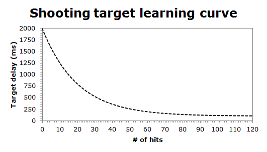

Implementing this pattern is not very difficult on itself but the question is more on how to select the ideal score-vs-delay progression. In game design, this is usually referred to as the learning curve. If the learning curve is too steep, the player will find the game too hard to play and will quit. But if the learning curve is to shallow, the player will get bored. Choosing the right learning curve is a difficult task because every player is different and what is boring to one can be hard for another. This is why many games proposes several difficulty levels such as “easy”, “normal” and “hard” with different degree of learning curve steepness. Here, I have decided to include only one learning curve but there is not real difficulty in evolving the device later.
To translate the score into the delay, one will need a mathematical expression for the learning curve. There are different classical shapes such as the linear one (delay directly proportional to the score), power functions, exponentials, sigmoids… From trial and error I have decided to go for an exponential one:
with tmax the slowest target delay (when you begin the game) and tmin the fastest target delay. k is a constant that codes for how fast the delay will drop down as your score increase.
After some tests, I ended up with the learning curve shown on Figure 3. tmax was set to a reasonable 2 seconds which is okay for most entry level shooters and tmin was set to the fastest reaction time of human being plus the travel time of the bullet to the target (100 ms total). There is no need to have a system that can switch faster than you can blink your eyes! The time constant, k, was selected such that it is possible to go down to the fastest delay with a magazine of 80 BB’s which makes the theoretical maximum score of about 400 (assuming that nobody can shoot faster than tmin).
I have done some tests and it works but I am not completely happy with the result. I am not sure that a sigmoid would have performed better but it is possible to build composite models with a linear part at first and an exponential part at the end. The only important thing is that our model should be a pure decreasing function. That is, the delay at score #1 should always be larger than the delay at score #2 if score #1 < score #2. Failing to implement this will result in a game that is not a true description of the player shooting reactions.

To create the target read-out logic you will need to download this layout to make a custom shield for your Arduino Uno. Use stacking headers and solder the components according to Figure 4.
Figure 4
You will also need two Arduino Uno Rev3 as well as a digit shield from Nootropic Design, two proto wireless shield (without the SD functionality) and two Digi XBee series 1 (see the Introduction for a discussion on this). They are all available at Robotshop.
For the target controller, assemble an Arduino Uno Rev3, a wireless shield and the target read-out logic shield of Figure 4. For the remote score display, assemble an Arduino Uno Rev3, a wireless shield and the digit shield. You will need to program the Arduino microcontroller before you assemble the shields. Also, you will want to read the instructions for the various shields (especially the wireless shield and its usb/micro switch) before you start using them.
