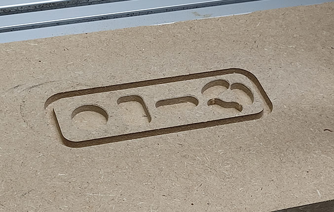

Figure 1 – Some cheap MDF stock to experiment with CNC programming

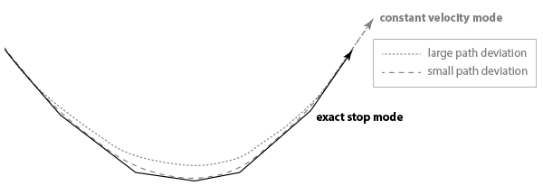

Path Approximation
We saw that G-code only supports linear and arc motions. This falls a bit short when you need to trace smooth curves like letter arts! The only solution is to approximate them with series of tiny linear movements.
Path approximation becomes very handy in such circumstances because it allows overriding the default behavior of the CNC controller which is to stop at each vertex of the trace by decelerating the machine to avoid overshoots. This repeated deceleration and acceleration results in a noticeable slowdown of the machining process. While geometrically accurate, this exact stop behavior (G61) introduces inefficiency and may lead to inconsistent surface finish due to changes in feedrate. Also, it generates a series of broken lines and not the smooth curve we were initially looking for. In exact stop mode, the only way to achieve smoothness is to use a lot of linear subdivisions, making the program extremely slow and verbose.
To address this, most CNC controllers support constant velocity modes, which permit the tool to slightly deviate from the exact path in order to maintain a smoother trajectory. In the G-code standard, this is controlled by the G64 command, which activates path blending, also called look-ahead motion or corner rounding, allowing the controller to avoid complete stops at corners. Instead, it dynamically calculates an adjusted path that merges adjacent segments with a continuous, flowing motion.
The extent of this deviation is controlled by a system-defined parameter, often referred to as path tolerance or maximum deviation. On the KineticNC controller, this tolerance can be adjusted in the Machine Settings pane. It defines the maximum distance the tool is allowed to deviate from the programmed polyline path. A smaller value will result in tighter adherence to the intended geometry but may still slow down the tool at sharp corners. A larger value results in smoother motion but introduces greater geometric deviation.
Figure 2 illustrates the difference between these modes. The original path is shown as a sequence of sharp line segments forming a polyline. In exact stop mode (G61), the tool path follows each vertex precisely, requiring deceleration at every corner. The figure also shows two approximated paths using G64 with different tolerance values: one with a tight deviation radius that rounds the corners slightly, and one with a more aggressive smoothing that departs more visibly from the polyline. The trade-off between speed and accuracy becomes evident from the comparison.
Figure 2 – Path approximation

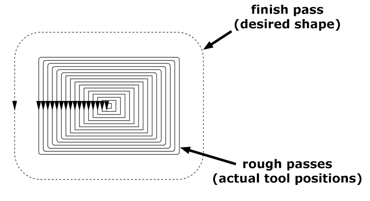

  • Pocketing: Removing material from an enclosed area inside the part, typically using a zig-zag or spiral toolpath;

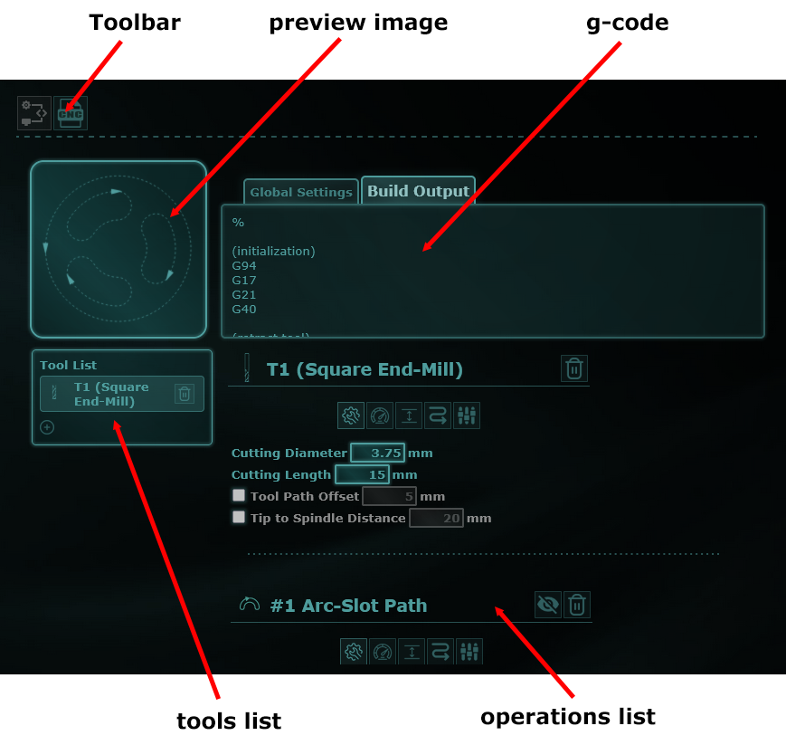

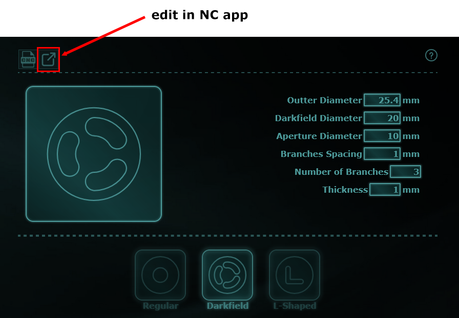

#DevOptical NC Web-Application
In the context of the #DevOptical website, I implemented a simple semi CAM tool to assist in G-code programming. The application is available in one click and does not require any installation process. The tool was designed to act as a medium-layer bridge between higher-level CAM applications and low-level G-code programming.
Just like other CAM softwares, the application will offer multiple operation types (facing, pocketing, path, hole drilling, thread milling, chamfering etc.) and will generate all the G-code machining passes based on your inputs such as pass size, tool speed and others. The application also integrates a “crash detection engine”, currently in BETA version, which is aimed as a safety layer to detect potential crashes of the tool. I will dedicate a complete article on how crash detection is implemented because it makes use of very sophisticated math tools :)
The main screen of the application is shown in Figure 3 with a toolbar on top (build program, export program), a global settings pane, a tool pane and an operations pane.
Figure 3 – NC Web Application
To add machining operations, first create a tool of the desired type (e.g. an endmill) in the tool pane, then create the desired operation (e.g. a disk pocket) in the operations pane. Once all the settings have been entered, you can click on the “build” button in the toolbar to generate your G-code.
The easiest way to test the application is to actually use it through one of my higher-level applications, such as the aperture creator. Once your aperture has been configured properly, just click on the “edit” button as shown in Figure 4. The NC application will open in another window with all the tool paths and settings already entered. You can then fine-tune the program from there and rebuild the program.
Figure 4 – Accessing NC from other applications
The application will generate a preview image of your tool passes. Actual tool position is shown using thick, continuous, lines with an arrow indicating the direction of the motion. Desired feature dimensions are shown as dashed-lines. Desired feature dimensions are the path traces that makes uses of the G41/G42 radius compensation commands of the G-code for which you can choose either “inner” or “outer” path trace behavior. Note that pocketing operations always apply a radius compensated path as finishing pass as illustrated in Figure 5.
Figure 5 – Tool path vs. features path in pocketing operation
Check on Figure 5 how the radii adapt between the rough passes and the finish pass to take into account the tool diameter. Also, despite the finish pass seems to be far away from the rough passes, the actual amount of material removed by the finishing operation is very small (0.2 mm here). Remember that the dashed curve represent the actual cut shape whereas the plain lines represent the tool center to which you need to add the tool diameter to get a correct representation of the amount of material cut!
