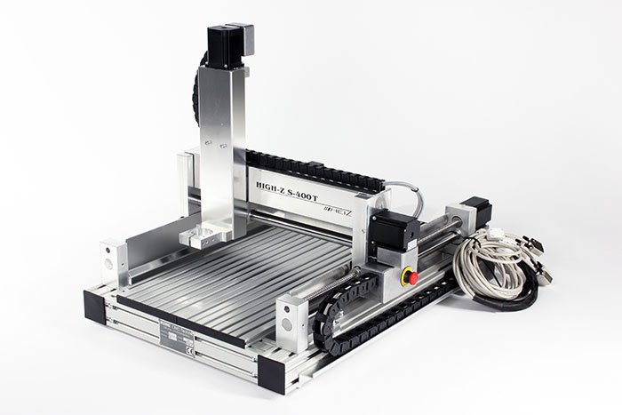

The CNC milling machine is shown in Figure 1 in its 400×300×110 mm configuration. They have 720×420, 1000×600, 1400×800, 1400×1100 and 2100×1050 mm versions as well. I chose the 400×300 mm version because I did not have a lot of space in my workshop to accommodate larger models. With the safety enclosure, lubrification system, PC and controller unit, I would say that the machine eats up about 2 m² - much larger than what the 400×300 mm might suggest!
Figure 1 – CNC STEP High-Z S400/T CNC milling machine. Photo from CNC STEP.com.

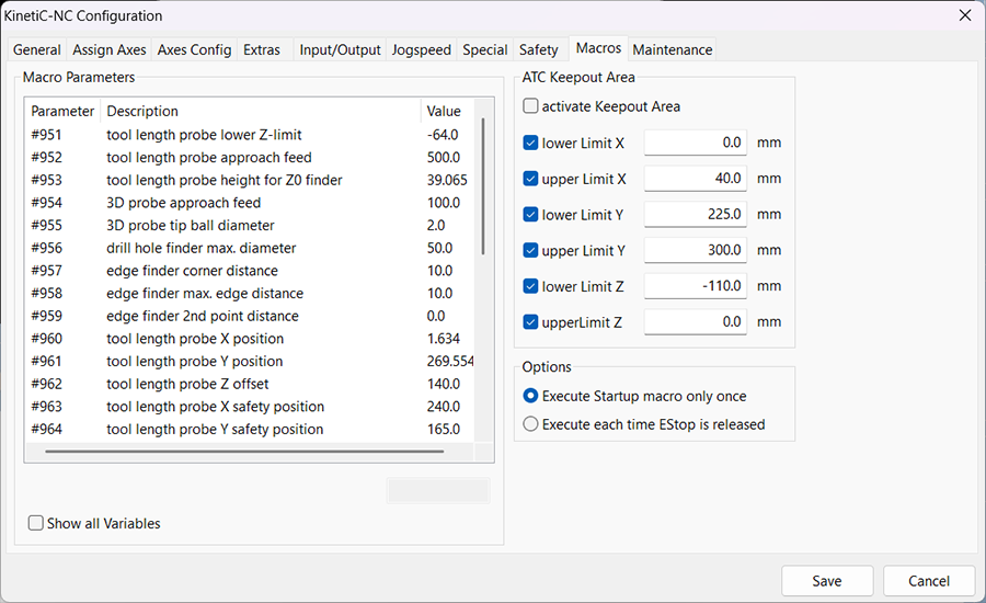

There is one exception to this rule, which is the “Macros” pane of the settings. Here, you can define values that can be accessed in the CNC programs but also in macros. A macro is a sub-programs that can be called from your main CNC program. In the following sections, I will require you to add/modify some of these macros parameters – so it’s important that we cover how to do that first!
Also, you can define an area that your CNC programs cannot access using the “ATC Keepout Area” settings. If you want to configure your machine like mine, copy the ATC settings in your own machine. More on that in the tool change section.
Going back to macros, it is interesting to know that, in KineticNC software, almost all CNC commands are in fact macros. For instance, the CNC command “M3” that starts the spindle is implemented as:
where #0, #1 and #2 are inputs parameters, #O3 and #O4 are IO pins (defined in machine settings > input/output).
When running the command M3, the machine will actually disable IO pin #O4 before enabling IO pin #O3. Similar behavior can be found in commands like M7/M8/M9 which drives coolant/lubrification. Some macros like M6 are more complex and will be discussed in the tool change section. You can modify any of the provided macros and even make your own!
The complete list of macros can be found in settings > macros, shown in Figure 6. As for the machine settings, backup the existing macros before making any changes. The macros are stored in the Folder C:\ProgramData\KinetiC-NC\macros.

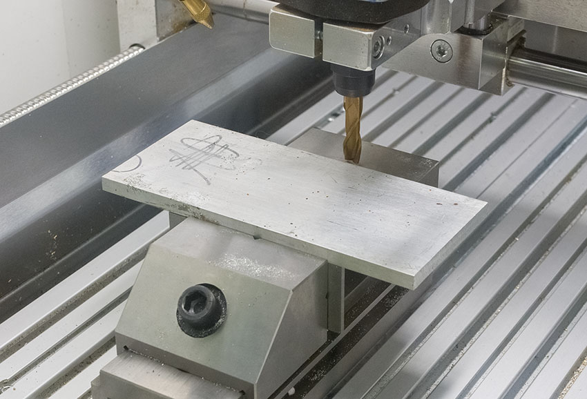

Clamping Your Workpiece
Clamping is by far, to my opinion, the most complex topic regarding this CNC milling machine. I haven’t found yet a standard clamping methodology that would work in all scenarios.
Standard vices, like the one in Figure 7, are not suited for the machine due to its limited Z-axis range. Despite I purchased the vice of Figure 7 from CNC STEP, it does not work with my machine! The vice is too large and conflicts with the YZ rail of the machine. And even if you place the vice at the very left of the machine, such that it does not conflict with the rail, the part is held so high that it is impossible to use long tools like my 10 mm endmill! And I’m not even talking of button the zeroing sensor on top of that… I don’t understand why CNC STEP sells those vices knowing their lack of compatibility with their machines.
Figure 7 – Pull-down vice from CNC STEP
An alternative might be their low-profile self-centering vice but I didn’t have the time yet to give it a try. I would not consider the smaller pull-down vices as they cannot hold large parts, and I consider that most of my applications lean towards those larger parts. The self-centering vice is therefore on the top of my purchase list currently.
Note that in traditional machining, it is common to have the vice mounted on a swivel base to orient the part properly when you need to machine existing parts (or simply when using multiple setups). This is clearly not possible here due to the limited vertical space – something that we need to take into account when producing our CNC programs. I will come back on this in a future post.

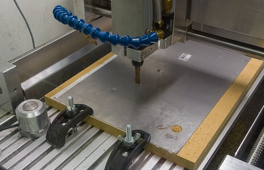

Clamping claws such as in Figure 9 are a relatively versatile solution but they have several drawbacks as they can’t hold small parts and, most importantly for my own job, they prevent you from facing the complete part at once without changing the setup. Again, the self-centering vice seems to be the best option to try out.
Figure 9 – Different types of clamping claws
An alternative to clamping claws, which I did not experiment with yet, are side clamps. I will test soon with 3D printed versions of side clamping actions that would be compatible with the size of the machine but only if I cannot get satisfactory results from the self-centering vice first. The reason I’m looking into 3D-printed versions is because I wasn’t able to find miniaturized versions of them; all the ones I found were bulky and expensive.
An advantage of side clamps is that you can machine a guide block that is perfectly aligned with the travel axis of the machine such that you can clamp your part in the proper orientation. In this procedure, you would first bolt a guide block on the machine bed before machining that block along either the X or Y axis, depending on the orientation you would like to achieve. As long as you don’t unbolt the block or the bed, it should stay aligned with the machine axis and serve as a reference.

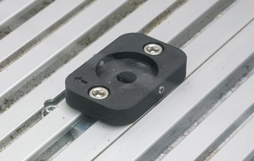

In my post on machining lenses mounts, I already experimented with 3D printed clamps reproduced here in Figure 10. They gave satisfactory results but the parts were very thick, resulting in a lot of stock material loss. I wouldn’t be too confident reducing their size on the other hand. Also, I would stick to heat-resistant materials such as PETG instead of PLA – knowing that, by definition, any FDM print is ultimately sensitive to heat. Finally, a big issue with plastics is that they will deform over time and I don’t know how much time they can hold the part in place firmly enough.
Figure 10 – 3D-printed clamps

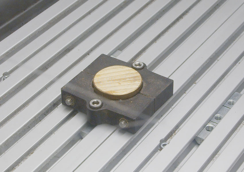

Finally, I also experimented with dedicated parts holders. Here, you machine the footprint (contour) of the part you need to hold into a scrap part made typically in plastic, and use set screws on the side to maintain the part in place. Such a dedicated holder is shown in Figure 11. This technique was recommended to me by former colleagues but I couldn’t get satisfactory results with it, and even damaged my part during machining (the part literally flew into the air!). As a consequence, I wouldn’t recommend it but mention the technique for the sake of completeness, and as a warning in case you would like to try it yourself.
Figure 11 – Dedicated clamp

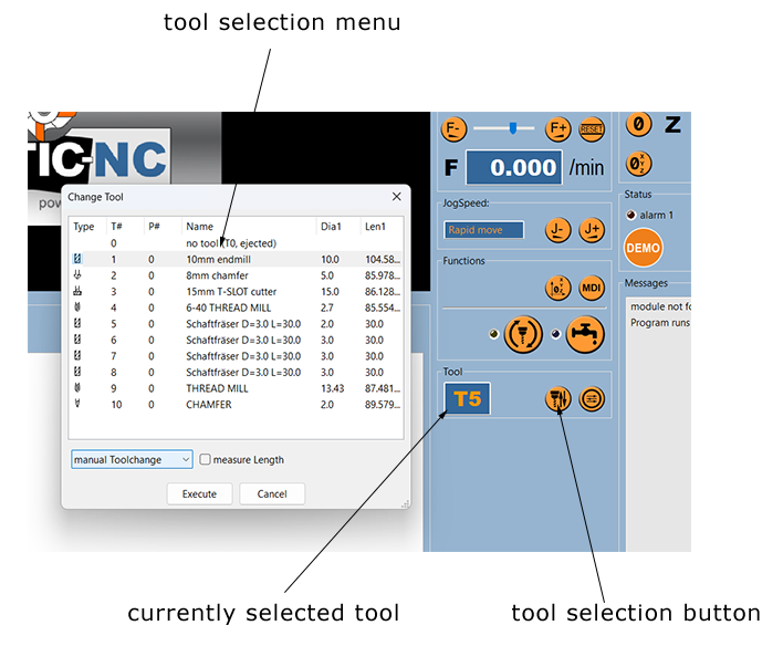

The currently selected tool appears on the main pane as shown in Figure 14. To change the tool, you can use either the provided menu button or use the “M6 Tn” CNC command where ‘n’ is the index of the tool you want to select. When selecting the tool from the tool selection menu, you can use either a manual tool-change where the operator changes the tool manually, an automated tool-change where the machine uses a pneumatic device to change the tool, or to force index change within the program. I do not recommend forcing the index of the tool, and, to my understanding, the automated tool-change is restricted to their higher-end machines. I therefore use exclusively the manual tool-change, when not directly using a raw CNC command instead.

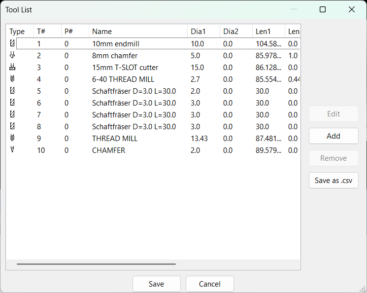

You can configure each tool using Configure > Tools which will display your current tool list as shown in Figure 15.
Figure 15 – Tool list
By default the list is populated with 10 tools, but you can add as many tools as you want. You can save your tool list as a .csv file, but I haven’t found a way to import a tool list into the software which is a feature that I truly miss. I recommend setting your tool list once and for all and match the tool indices in your CNC program.

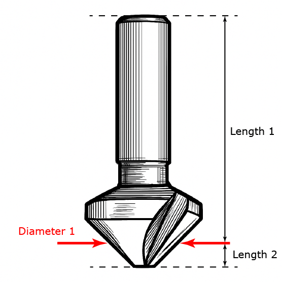

Length 1, which is the length of the tool. This might be tricky to understand but this value is relative from tool to tool. That is, what matters is not its absolute value but the value relative to other tools. If you use the tool-change method I describe below, this value is updated automatically by the software and you should not modify it. If you set this value yourself, put the distance between the cutting part of the tool and the spindle chuck. Note that your program must be in G43 mode to account for tool length compensation, otherwise this value is not used.
Length 2, which is initially not used by the program but that I introduced into my tool change macro as discussed below. It corresponds to the distance between the bottom of the tool and the cutting part of the tool.
I mentioned that these settings are relatively straightforward for tools like endmills, but let’s illustrate how to use them on a chamfer mill as shown in Figure 17. Diameter 1 corresponds to the cutting diameter of the tool. The controller software will automatically offset the paths in such a way that the chamfer will contact the part along that diameter. Length 1 is the distance between some reference position (here, the top of the tool) and where the tool should cut (the reference diameter). Length 1 is the value that is used by the controller to offset the tool depth (Z) when in tool length compensation mode (G43). When using the tool length procedure that I will describe next, this value is computed automatically every time you insert the tool in the chuck. Finaly, Length 2 is the distance between the tip of the tool and the cutting part of the tool. If you provide Length 1 manually, you do not need to provide any value for Length 2 as it is not used by the controller. Length 2 is actually used to compute the value of Length 1 in the tool change macro that I will describe next.
Figure 17 – Settings of a chamfer mill
To measure accurately the value of Length 2 for my chamfer mill, I made a 3D printed tool which is shown in Figure 18. The dial is zeroed using a reference flat. Then, you can insert the end of the chamfer mill to measure Length 2 directly for a given physical reference diameter (4.98 mm here). In the KineticNC software, I then paste the value of Length 2 and set Diameter 1 to 4.98 mm.
