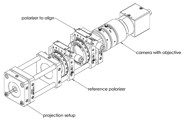

One of the first alignment procedures we must define is how to define a base polarization axis in a system. You can choose any axis you want but, since most optical systems are laid on an optical baseplate or breadboard, it is common to choose a polarization state that is either parallel or perpendicular to the reference plane formed by the baseplate or breadboard.
To achieve this, we can make use of the fact that reflection on an uncoated glass surface is polarization-dependent as demonstrated in this post. When reflecting light at Brewster’s angle (~56° for n=1.5 glass), only light perpendicular to the reference plane is reflected (the light parallel to the reference plane is fully transmitted). Therefore, by sending light that is exclusively parallel to the reference plane, we should observe no reflected light – provided we are exactly at Brewster’s angle, with purely monochromatic light and with a fully polarized collimated input beam. We can then use this principle to tune the orientation of the input polarization state until no light is reflected.
This principle is used in Figure 1 to align a Thorlabs LPVIS polarizer parallel to the reference plane of Thorlab’s cage system structure. The setup comprises a relatively monochromatic illumination made of a parallel beam, a polarizer mounted on a precision rotation stage, and a camera to re-image the input beam pinhole. Side note, most people would use a power meter for the alignment but I like using cameras because they are extremely sensitive with detection thresholds of only a few photons – and are also much cheaper than power meters!
Figure 1 – Reference axis setup

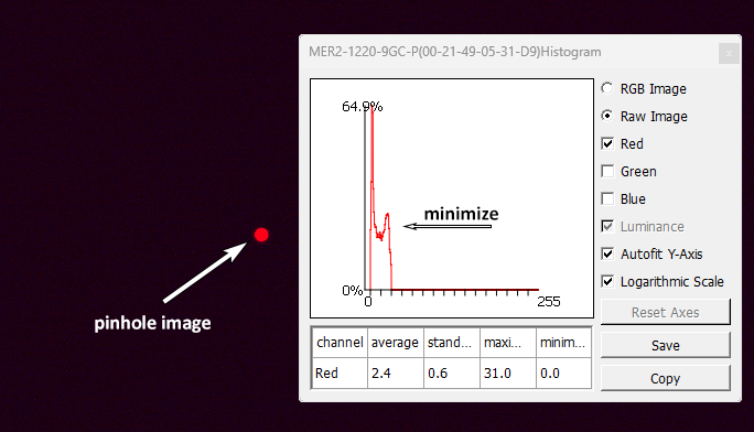

When performing the alignment of the system shown in Figure 1, set the camera exposure to ~100 ms (or any other required exposure time to achieve a mean gray value at 80% saturation of the camera) and tune the polarizer axis until the camera grayscale values histogram shows a minimum as shown in Figure 2. For those who replicate the setup using the provided CAD, you can use a current source of 25 mA for the LED.
Figure 2 – Using grayscale histogram to find the minimum

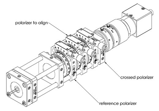

Now that we have a reference axis defined for our polarizer, we can ask ourselves how to align a second polarizer to a crossed configuration relative to this reference polarizer. Here, we can use the setup of Figure 3 using a similar procedure with the grayscale histogram on the camera.
Figure 3 – crossed configuration alignment
Note that if you would like to substitute this new polarizer as a reference polarization state, such as to have a reference polarization state perpendicular to the system reference plane, you would need to add the precision of the polarizer alignment to the precision at which we aligned the initial polarizer.

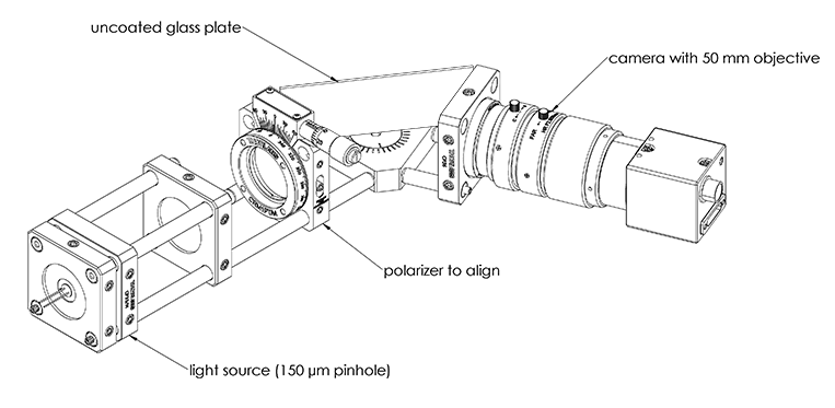

Finally, I would like to address the case of aligning a polarizer at 45° to the reference plane which is useful in some experimental setups that we will cover later. In this former post we have seen that putting a third polarizer at an angle θ between two crossed polarizers yielded an intensity proportional to cos²(θ)×sin²(θ) which is maximum at 45°. This concept is put in action in the setup of Figure 4. Note that this system suffers from the same shot noise problem as we previously discussed, except that here it is not possible to use the cage rotation trick.
Figure 4 – 45° alignment
Also, the formula cos²(θ)×sin²(θ) applies to a system with perfectly aligned crossed polarizer. When the crossed polarizer has a small angular error ε the equation becomes
which admit a maximum at
Such that we align the polarizer at 45° plus or minus half of the error made on the alignment of the crossed polarizer – to which you also need to add the error made when identifying the maximum of the curve. You therefore need to balance the cost vs. benefits of this alignment strategy compared to using a precision rotation mount to shift a crossed configuration by 45°. Nonetheless, I find the setup of Figure 4 very interesting in its concept.
