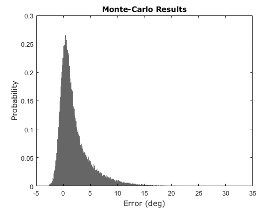

This phenomenon was studied using a Monte-Carlo analysis. I used the assumption developed in my last post that the alignment error is bound to the SNR and considered the alignment error of the crossed and parallel configuration, the alignment error of the waveplate due to (a) the search for the maximum, and, (b) the error introduced by an improper crossed setup, and, finally, the error introduced on the intensity measurement from the SNR of the camera.
Figure 2 shows the numerical analysis for a SNR of 100 and 105 Monte-Carlo samples on a quarter-wave plate. The probable (50%) error on the value of the retardance is 1.30° (λ/277) and the 95% error is 8.65° (λ/42). This is an important result because it is the one obtainable with a 1-pixel reading on the camera.

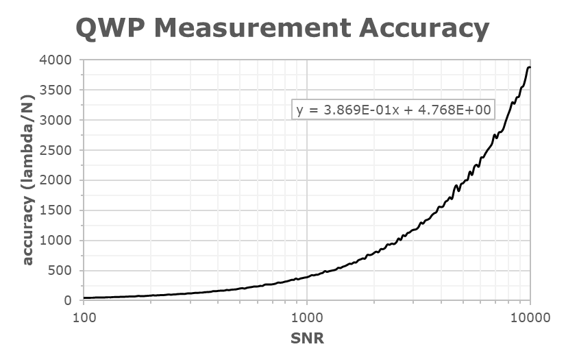

Second, the 95% error was evaluated for increasing SNR values. The results are shown in Figure 3. They show that a SNR of at least 2,572 is required to achieve a λ/1000 accuracy on the retardance measurement. Using a typical camera of SNR=100, this corresponds to averaging at least 662 pixels or frames. Interestingly, the accuracy seems to follow an exact linear pattern vs. SNR.
