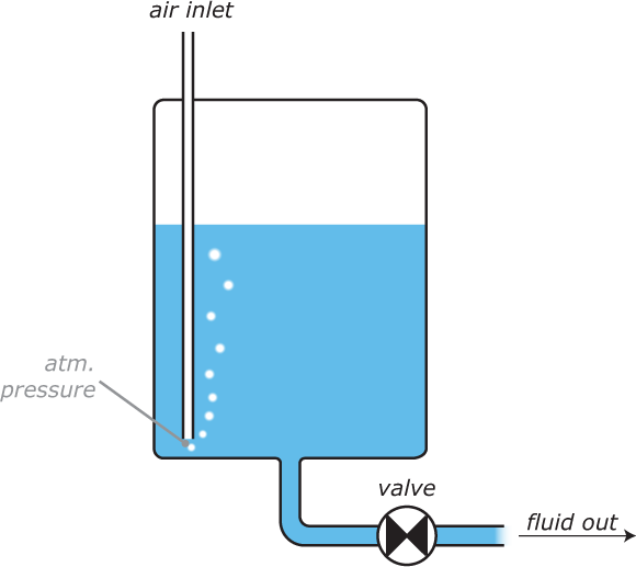

A clever solution is to seal the tank and use a second tubing to fix the pressure in the bottom of the tank:
Through that way, the hydrostatic pressure at the outlet is constant as long as the fluid level is above the pressure inlet. As a consequence, the output flow rate is now constant and independent of the liquid level in the tank.

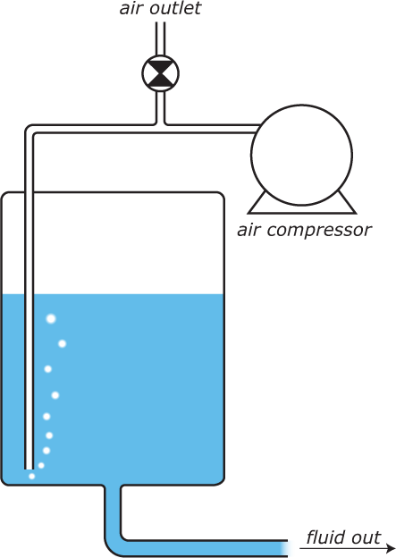

Hopefully, there exists a solution to this problem that has even more benefits than just saving your compressor lifetime. We will take the valve off and put it as a derivation from the tank air inlet to the atmosphere:
All we have discussed above about liquids also work with air (gases are fluids which just have larger compressibility than liquids). There is an accumulated air pressure inside the tubing that only wants one thing: get free to the atmosphere. But on its path there is our valve element which causes friction and so a pressure drop. At some point, we achieve a steady state such that any air molecule forced into the tubing by the compressor will result in a small accumulation of pressure that is immediately freed by the valve into the atmosphere. When the pressure get below that threshold, less air molecules go out and pressure accumulates again. On the contrary, when the pressure get above the threshold, the force that acts on air molecules is larger and more of them are able to escape by the valve. The good news is that we can change the friction of the valve by turning its adjustment screw. Tuning the friction will change the pressure inside the tubing and, as a consequence, the pressure at the bottom of the tank and the output flow rate.
Our compressor lifetime is now safe and, nonetheless, we have moved the valve to a part of the circuit that is not in contact with the liquid which might be corrosive for the valve material (think of acids, solvents etc.).
