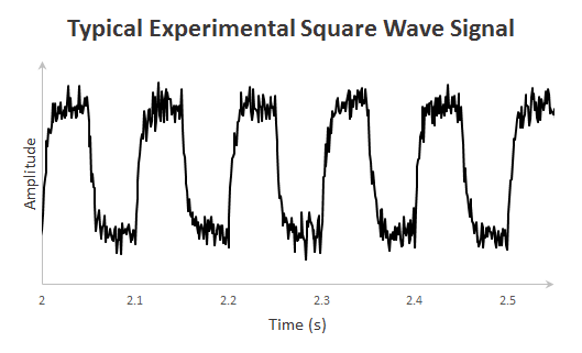

A typical signal recorded with such a device will look like the one on Figure 1. I obtained it from simulation using SimuLink by assuming a 10 Hz square wave carrier signal passing through a one-pole transfer function and containing large amount of white noise. Such a signal is a good case-study representing what one would obtain through a first order low pass filter in a noisy environment. Note that the carrier frequency is usually chosen such that it is much faster than the ambient condition change speed. In this example I have assumed a 10 Hz frequency but it might as well be 1 kHz or even 100 kHz.
Figure 1 – Typical experimental square wave signal measured
Extracting the peak-to-peak value from such a signal is not as straightforward as taking the maximum minus minimum because of both the contribution of noise and low-pass effects making a ramping of the signal. The usual state of the art way of processing such a signal is to take the root mean square (RMS) value defined as

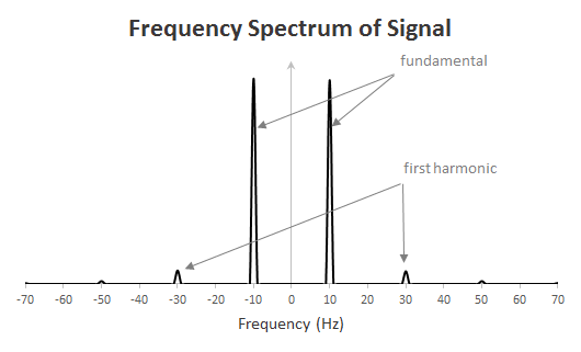

To understand how the SNR of a square wave is related to its RMS value, we need to have to look at the Fourier spectrum of the signal. I have already shown in details in a previous article how square waves can be built from sines waves at discrete values (and vice-versa). To summarize, a square wave of 10 Hz can be seen as an infinite sum of sine waves of frequency n10 Hz with n odd with amplitudes decreasing as n-1. This can be seen on Figure 2. The peak at 10 Hz will usually be called the fundamental and the other ones the harmonics*.
Figure 2 – Frequency spectrum of a square wave signal of 10 Hz
The consequence of this is that the information (or energy) of the square wave is located at discrete points in the frequency spectrum, all the other frequencies being filled up only with noise. This is important because we have seen that integrating more noise will yield larger amount of noise on the sum, increasing as the square root of the number of frequency bins that we integrate while the signal will only increase at the frequency bins ±10 Hz, ±30 Hz, ±50 Hz etc… Adding the frequency bins at other values will then only increase the noise power and not the signal power.

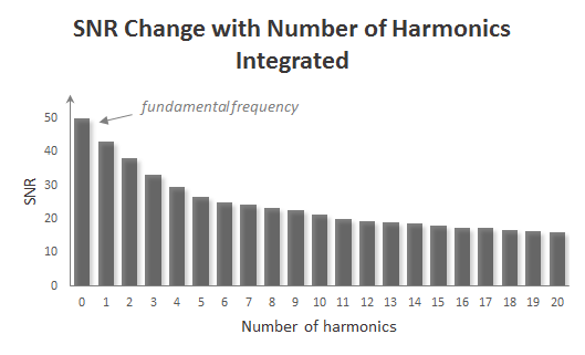

The same conclusion can also be drawn for the upper harmonics because the energy is strictly decreasing as we progress in the harmonics order. This was verified through simulation using the sample signal of Figure 1 and the masking process of Figure 3 with increasing number of harmonics. The results are presented on Figure 4.
Figure 4 – SNR change with increasing number of harmonics
The results of Figure 4 then confirms that the best SNR of a square wave signal for RMS measurement is obtained when using only the fundamental frequency. Including any other harmonics or frequency bins will only lower the SNR of the measurement.

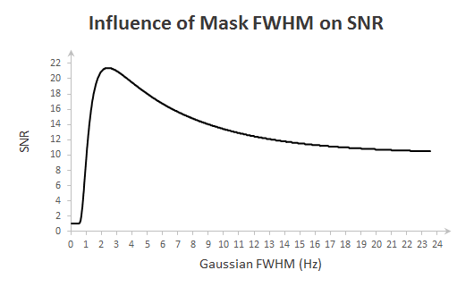

Finally, I would like to make some technical comments about the influence of FWHM of the Gaussian mask on the SNR. When integrating the masked spectrum, it is important to select an optimal value for the width of the Gaussian curve such as to maximize the SNR. By expanding a little bit using integrals we get
where ‘d’ is the noise density power, supposed constant over the whole frequency range, f0 the frequency of the fundamental peak and 2ln(2)σ the full-width at half-maximum (FWHM) which configures the spreading of the Gaussian mask as illustrated on Figure 3.
Experimentally, if we plot the SNR as a function of the FWHM we will get a result like Figure 5 which shows a strong increase in the SNR as the mask becomes integrating more information and then decrease in a square root way as we integrate more noise over signal. The curve shows then a maximum which is the optimal FWHM size to collect all the signal with the least noise possible.
Figure 5 – Influence of the Gaussian FWHM on the signal SNR
We see that the optimal FWHM size is about 2.5 Hz in this case. To understand a bit more about this we have to analyse the spectrum of the signal, S(f).

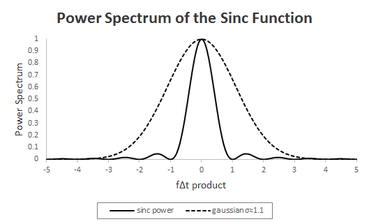

Ideally, the spectrum will only consist of pure peaks located a ‘n’ times the fundamental frequency, with n odd. However, in practice, we will measure not pure peak but convoluted sinc functions due to the fact that we are analysing a finite-time sample. Indeed, when sampling for a time ∆t we become unable to resolve frequency changes finer than about ∆t-1. It is possible to see the sample taken as the product of the square wave signal, s∞(t), and a rectangular window of size ∆t:
whose Fourier spectrum therefore consists of the convolution of the square wave signal and a sinc function for the rectangular window:
If we are only interested in the fundamental peak, we then get:
The power plot of the sinc function is given on Figure 6 as well as the Gaussian corresponding to the best FWHM measured on Figure 5.
Figure 6 – Plot of the sinc function and a Gaussian of σ≈1.1
It can be seen that the “best” Gaussian FHWM obtained on the experiment of Figure 5 is actually much larger than the sinc function. When using smaller values (in particular σ≈0.11 which gives a pretty good estimate of this sinc function) we do not get good SNR. Also, one would have expected that the smaller σ, the better the SNR using the integral formula because it would reduce the noise density to a minimum. Still, I am wondering if this could be due to the size of frequency bins because, without zero padding, the shape of the sinc curve is pretty rough in the Fourier domain. When I get more time, I will try to investigate this a little bit more because it is a tricky behaviour.
Nevertheless, I would then recommend using a value of σ for the mask close to one for the beginning and eventually tune it a little bit based on experimental data.
