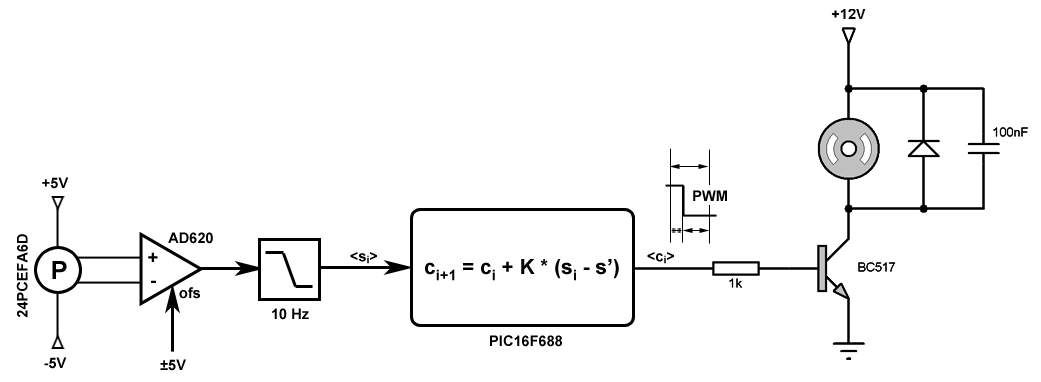

The circuit design I have used is given on Figure 1. It shows the differential pressure sensor with the instrumentation amplifier, a 10 Hz filter and the microcontroller which computes the next command to use knowing the previous command and the sensor state. Finally, the pump motor is driven by a PWM circuit. I had to add a 100 nF capacitor and a diode to prevent EM kickbacks that caused the PIC to reboot every few seconds.
Figure 1 - Design schematics.

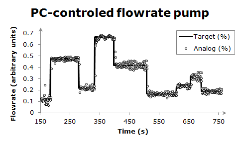

The results were remarkable and the pump is relatively fast to react to change in the desired flow rate with less than 5 sec reaction time. You can see them on Figure 2 with water. The overall signal seems to be stable within a 5-10% error with the desired output and a mean value equal to the target. This is good news because it means that the volume pumped after a sufficiently long time should be perfectly equal to the expected value.

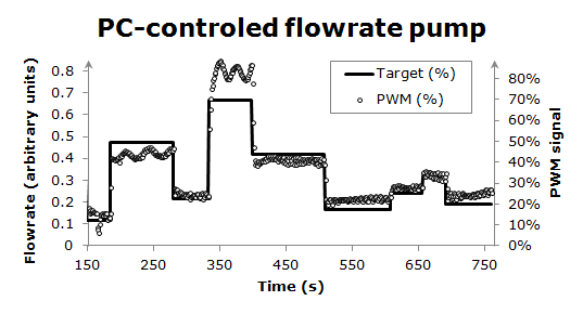

An interesting result can be seen on the PWM command of the system which is given on Figure 3. First, the PWM signal is not strictly proportional to the flow rate (or, at least, the pressure drop recorded by the sensor). Second, there are clear oscillations in the command which might be due to the discrete sampling of the system. I would then suggest increasing the reactivity of the command/sensor if you would like to experiment with this.
