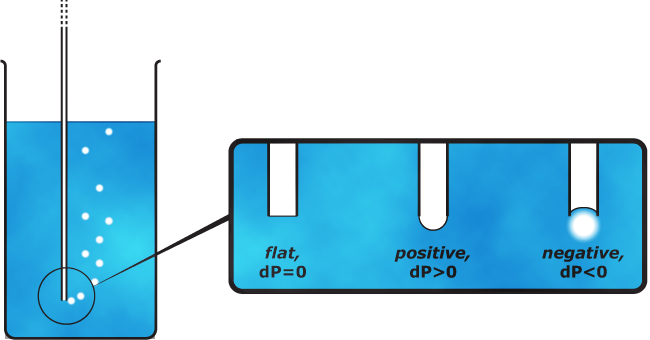

A classical way to measure the pressure is to grow a bubble on the mouth of a capillary tube by slowly injecting gas into the capillary as illustrated on Figure 1. When the bubble is flat, its curvature is extremely large (almost infinite) and the Laplace pressure inside the capillary is null. As the bubble grows the pressure keep increasing until it reach a maximum where the bubble has a curvature equal to the capillary mouth radius. Then, and this is not always mentioned in the theory but often observed experimentally, the bubble tends to tear off a fraction of air from the capillary, leaving a negative curvature and we therefore observe a small negative Laplace pressure.

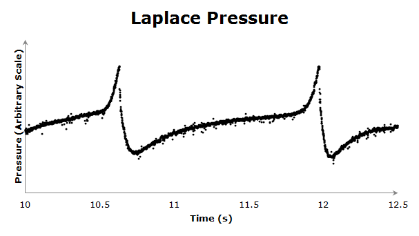

Repetitive bubbles lead to a record such as on Figure 2. The three successive pressure discussed above clearly appear on the graph.

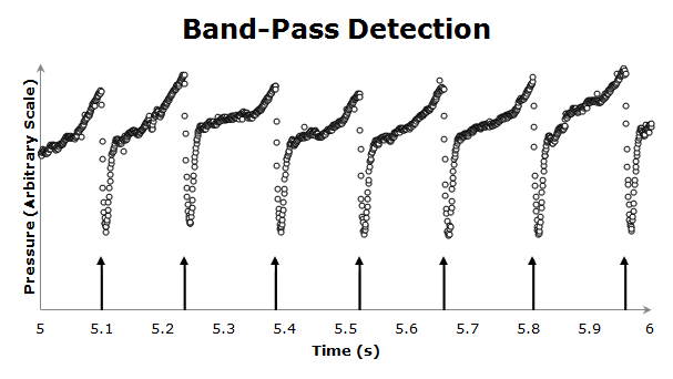

To count the number of bubbles we have to track every peak in the pressure graph. But because of the varying pressure due to friction, we cannot simply use a threshold. The idea is to first pass the pressure into a band-pass filter to select an approximated time-scale of a peak event. From Figure 2 we see that a peak can be roughly assimilated to a sine wave of period 0.25 sec so I have used a second order high-pass filter with a cut-off of about 4 Hz. Also, because we do not want noise from the sensor output, we should remove all frequencies above 1 kHz. The band-pass filtered signal can then be thresholded to detect the peaks and send the signal to a microprocessor (or you may also send the output to a low-pass filter to have an analog reading of the flow rate). A typical result is given on Figure 3.
