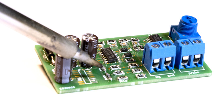

A picture of the circuit is given on Figure 1. You can download the Gerber files at the end of the post to print the PCB yourself.

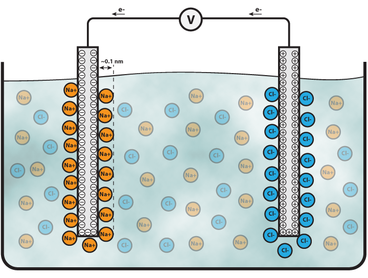

So an electrolytic solution is a big soup of charged species. Why can’t it conduct current like metals?
To understand this, remember that the way the electrons move into the copper wire. When we insert an electron from the battery, it takes the place of an electron from the sea of electrons and allows then one to leave the copper wire to enter the rest of the electrical circuit. In our electrolytic solution, there is no sea of electrons but only a bunch of charged molecules or atoms that holds their electrons too well to allow for a transfer mechanism like in the metal conductor.
When a small potential is applied to an electrode, the electrons do not flow into the system. Instead, a small amount of electrons (or positive holes) accumulates in the electrode by the action of the potential difference but no charge transfer occurs between the electrode and the solution. The best the solution can do is to “stick” its oppositely charged ions on the wall of the electrodes from electrostatic attraction. So on one electrode you will have a layer a positive ions and on the other one a layer of negative ions. This layer is actually very thin because it repels further positive (or negative) ions from approaching the electrodes. It is called the electrolytic double layer and is about 0.1 nm thick.
The process occurring in a solution of NaCl is represented in Figure 2.
Figure 2 – Two electrodes put in a sodium chloride solution
Now, if you remember well your lessons, you know that when a bunch of negative charges face positive charges and that no transfer can occur between the two layers, you get a capacitor which is like a reservoir of electrons. When you plug in a capacitor to a battery, it will start accumulating positive charges on one side and negative charges on the other, creating a current flow in the system. As the reservoir fills up, the potential increases between the two sides of the capacitor until the potential of the battery is not powerful enough to compensate this repulsion of adding more charges to the capacitor. And this is exactly what happens when you put the two electrodes of your ohm-meter into the solution because, at first, there will be a small current flowing into the system because the electrodes reservoirs are empty which will fool the ohm-meter into thinking that the current is actually flowing through a resistor while it is not. This will last only the time to completely fill up the reservoirs when no current will further flow leading the ohm-meter to display very high resistance. If by any chance you already tried using a larger potential (> 1 Volt) on an electrolytic solution, then you may have experienced a very different phenomenon taking place: bubbles start forming on the electrodes or the electrodes itself seems to dissolve into the solution. This is an electrolysis reaction and we want to avoid it at any cost.
We have seen that at small potentials the electrons cannot be transferred from/to the solution. But as the potential is increased the electrons becomes more “energetic” and, at some point, they will jump right into a positively charged ion. The opposite reaction occurs at the positive electrons where it becomes sufficiently energetic to allow an electron to be taken from the negatively charged ions. When this happens, a current indeed flows through the system but we also change the nature of the chemicals inside the solution. For instance, a solution of sodium chloride will be converted into hydrogen and highly toxic chlorine gaz. These reactions are well beyond the scope of this post but the important thing to remember is that the relation between current and voltage in such reactions do not follow the Ohm law and the resistance of the solution cannot be inferred from these two values. In fact, in building our conductometer, we will have to be very careful and use a low-enough potentials such that no reaction occurs between the electrodes and the electroactive species.
Let us now put these reactions apart and go back to our capacitor filling up. If we repeat the experiment with different salt concentrations, we will notice that the two electrodes system capacitance fills up faster with more concentrated solutions. This is because more dilute solutions have less ions travelling and it therefore takes more time for the electrode to reach its complete capacity. Hence the name “resistance” (and conductance) of the solution because it will take more or less time to fill up the capacitance of the electrode.

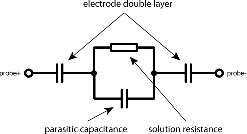

To understand how the conductometric probe will respond to an input signal, we have to study its impedance first. A good equivalent circuit is given in Figure 3. It includes the two electrodes double layer capacitance, Ce, the solution resistance, R, and the parasitic capacitance, Cp, which results from the capacitor formed by the two electrodes as the gap between them closes up.
Figure 3 – Simplified equivalent circuit of the electrode-solution system
The impedance of the system is then:
As an order of magnitude, Ce will be on the order of 10 to 100 µF and Cp will be on the order of 10 pF or more. Actual values will depend on the geometry of the electrodes and their processing. For instance, platinized “black” platinum electrodes have much larger capacitance because they offer a very large surface of contact when compared to a simple square copper surface. This is due to the extremely rough surface of the platinum when looked at the nanometer scale.
Also, and as the frequency increases, we may identify three regimes:
  • At low frequencies the term 1/ωCe becomes important when compared to R and ωCp is still low so the overall impedance will be fixed by the electrolytic double layer capacitance. In Figure 3, this corresponds to the current being blocked by the two series capacitances of the electrode.
  • At high frequencies the term ωCp becomes much larger than 1/R and all the current will leak through the parasitic capacitance.
  • At medium frequencies there will be a plateau where the impedance is proportional to the solution resistance over a range of frequencies with little impact of the capacitances elements. This is the operational range that we would like to use.

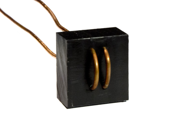

Figure 4 – Copper wire probe created for this experiment

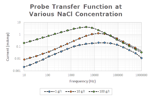

If you would like to experiment with a new type of probe, the best thing to do is to record its actual response over a large range of frequencies. This can be done with a frequency generator such as the Protek 9205 that I am using, a current to voltage converter such as the one of Figure 7 and an oscilloscope to monitor the output. You can also use the full circuit of Figure 7 provided you use a stronger low-pass filter so as to cut even the very low frequencies that you will be analysing.
I made the experiment with the copper wire probe and plotted the results on Figure 5. The first and third regimes can be seen as the (almost) straight lines at the beginning and at the end of the plot. The plateau regime is not obvious but occurs at about 8-40 kHz for the most diluted solution. The size of the plateau however decreases as the concentration increases. This is particularly obvious with the more concentrated solution where the signal drop very fast as the frequency increases. In fact, for frequencies above 20 kHz, concentrated solutions cannot be distinguished anymore from more dilute ones anymore as the green curve drops below the orange one.
Figure 5 – frequency analysis of the probe response at various NaCl concentrations
For the circuit presented here, I have chosen a frequency of 13 kHz because it is the one that maximize the sensitivity in the solutions of medium to low concentrations (<20 g/l NaCl). If you would like to study concentrated solutions as well, then operating around 4 kHz is probably a better idea.

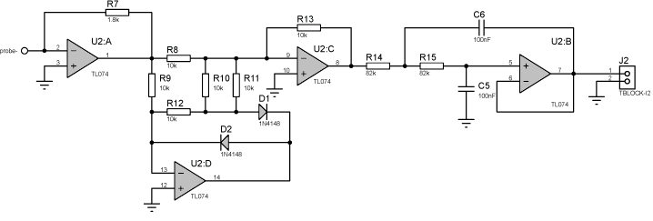

The second and third parts of the circuit comprise a current-to-voltage converter and a rms output stage. The resistor R7 will fix the conductance range accepted by the circuit. You can use a fixed resistor or a selector with different resistor values. I got good results for medium concentration (from 25 g/l to 0.25 g/l of NaCl) with a 1.8k resistor. If you would like to analyse more dilute solutions such as tap water or demineralized water, you will have to use a higher resistor value, probably up to 180k.
Figure 7 – current to voltage and RMS to dc converter
The output of this current-to-voltage converter then enter a full-wave rectifier which has already been discussed in this previous article. The rectified output then enters a second order Butterworth low-pass filter which will remove the carrier frequency (13 kHz). It has a -3 dB cut-off frequency of 20 Hz so you can keep track of dynamic phenomenon with this circuit.

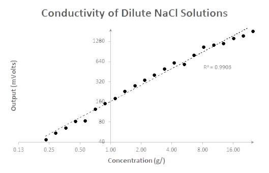

The circuit was then tested with a 25 g/l NaCl solution, successively diluted to 0.25 g/l using a 50 ml graduated flask. 10 ml samples were taken every time to get a conductivity reading and the resulting values are plotted on Figure 9.
Figure 9 – Conductivity of dilute NaCl solutions
Please note that the data of Figure 9 are presented on a logarithmic scale and so the trend shown as linear is actually a power law. Some fluctuations can be observed but they are probably due to the accuracy of the successive dilutions procedure used. The trend is however shown to be reproducible for a 1:100 concentration range with only one resistor. Larger range can certainly be obtained by using a selector with different resistor values. Still, a 1:100 dynamic range is already enough to analyse reaction kinetics, follow titrations and monitor drinking water conductivity.

If you would like to make this circuit, I have included the Gerber files that you can download. Just be careful that the circuit requires SMT components which may be difficult to solder if you do not have some prior experience. All resistors are 1% 1206 package and capacitors are 10% 0806 package.
