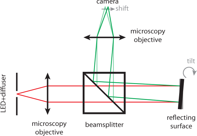

In this post, I will present a technique commonly used in optics to measure the wedge of optical transparent flats that can also be used to measure the deviation of a beam with a resolution of 0.007° and a range of up to 3° but that can easily be made even more sensitive by adapting the optics being used. The optical principle is shown on Figure 1.
Figure 1 - Optical Principle
The idea consists of projecting a collimated beam of a reticle target onto one or more reflecting surface. As the beam is reflected back to the source, it is focused on a camera sensor using a second objective. Any tilt in the collimated beam will then be translated into a shift at the camera sensor position. Because the beam is collimated at the output of the setup, the relative position of the mirror does not influence the reading as the reflective surface can be moved laterally without problem as long as it keep reflecting the beam back into the system. Also, the position of the target along the optical axis has no importance as the beam is collimated which allows reflecting any number of interfaces such as in multi-layer glass sheets.
If f2 is the focal length of the objective in front of the camera lens, then any small angle ∆α degrees will be shifted by f2∆απ/180°. The angular resolution of the system is then fixed by the smallest displacement that is observable. As a first approximation, one can use the size of a pixel (e.g.: 5.2 µm using our black&white Thorlabs camera) but the resolution can be either better or lower than that depending on the actual image of the reticle obtained at the sensor. If the image is well defined then it might be possible to have a sub-pixel resolution but if the reflective surface is not so flat (wavy or diffusive for instance) then the reticle image will be distorted or blurry and make the identification of displacement imprecise. This is one of the reasons for keeping the reticle thickness image low, such as a few pixels large. To achieve this, I have used a Thorlabs R1DS3N which features a 1” diameter 25 µm thick reticle and two Olympus Plan Achromat 4x microscopy objectives to prevent field distortion that could have happened with normal spherical lenses. This resulted in a 1:1 imaging ratio and a reticle thickness of about 5 pixels on the camera. The only down-side of the system implementation is the limited numerical aperture of the microscopy objective used which limited the field of view of the camera to about half of the sensor.

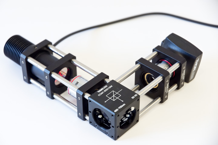

A photography of the setup is given on Figure 2. From left to right: a red power LED, a diffuser grit with the reticle target, the microscopy objective, a beam splitter cube, the second microscopy objective and the camera.
The setup was mounted as a 30 mm cage system for easiness of handling and has relatively limited hindrance although it is limited to a 0.007° resolution. Better resolution and field of view can be obtained by using teleobjective lenses such as 200 mm photography lenses but they would probably not fit the 30 mm cage system anymore and would then require either a 60 mm cage system or a fixed bench configuration on post holders. If you would like to replace the light source, a conventional low-power LED is already enough for highly reflective surfaces such as mirrors but if you would like to measure transparent flats it is then required to use more powerful LED (> 10 mW). The light source used here is the Thorlabs M625L3 run at 50 mA (typical performance is 600 mW optical power at 1 A).

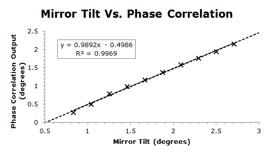

The system expected behaviour was confirmed by reflecting the signal onto a mirror fixed on a precision rotary stage (Thorlabs PR01/M) and recording several image at different positions of the Vernier scale. The results are presented on Figure 3 and confirm that the system has a linear behaviour over a 3° range of displacement.
Figure 3 - Experimental confirmation of the system
A close examination of the results of Figure 3 shows that the experimental points do not fall perfectly on the fitted line but this is due to the relatively low resolution of the Vernier scale of the rotation stage as each point in only distant by 5 ticks of the micrometer screw. This experiment then does not give actual information on the system performance because the system itself is much more sensitive than the rotation table used. Instead, this gives an indication on the resolution of Thorlabs PR01/M rotation stage. Thorlabs datasheet refers to a resolution of 2.4 arcmin per tick (0.04°/ticks) and the standard deviation of the error measured during the experiment was 0.035° which is consistent with the datasheet although we could have expected the actual resolution to be better than one tick (for example, half a tick).

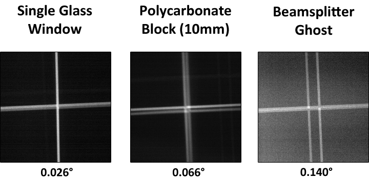

The setup was then tested on a few transparent surfaces including the window glass of my lab room, a 10 mm thick polycarbonate block and the beam splitter cube itself. The results are presented on Figure 4.
Figure 4 - Experimental Results
It can be observed on Figure 4 that the widow glass sheet is actually quite parallel with only a 0.026° wedge. The most surprising result was obtained with the polycarbonate block as I would not have expected the two faces from being parallel at up to about 0.05°. Please note that the reflection of the polycarbonate is not as nice as with glass interfaces. Concerning the beamsplitter, it is actually the light reflected on the inner surfaces of the beam splitter that goes back to the sensor as ghosts because their reflectivity is not null (although the reflectivity is quite low thanks to the anti-reflection coating). The parallelism of the two faces was measured to be 0.140° which falls well into the manufacturer datasheet (20 arcmin for the reflected beam, 5 arcmin for the transmitted beam).
