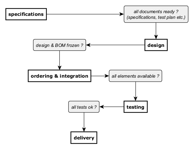

A typical process is summarized in Figure 1. We start by drawing out some specifications for the product, then hand on to design where all the CAD and engineering comes in (eventually split into a preliminary and definitive design phases separated by milestones), orders are placed for all the parts once all the drawing are ready, product is assembled and finally tested to confirm that it’s meeting the specifications. During production, only the purchase & integration phase is kept since the development is finished and it’s out of question to change what the product is doing (specifications) or how it’s doing it (design). Some simplified testing is also performed to check that the product behaves as intended (quality check / acceptance testing).
Figure 1 – Conventional product development & integration
While there is a lot to say about the process of Figure 1 and why it’s so, so, wrong, I’ll focus on the purchase & integration part for today. Despite the chart does not give any direction on how to place the orders, I’ve noticed that in the development stage, since the design has been frozen, parts with the longest lead time are often ordered first and the part with faster deliveries are ordered later. This is somehow logical (or at least looks like it is) in an environment where people are always late and busy on other projects as you are taught to do the most urging thing first. Typical lead times are on the order of up 3 months for custom lenses, 6 weeks for custom mechanical parts and 1 week or less for COTS with some notable exceptions (hand-built parts or parts experiencing shortage issues). It’s therefore common to rush on the orders for custom parts and place them as soon as the drawings are ready & validated and wait until the last minute or so to order the COTS. In a production environment, where you have everything set up in your ERP, all purchase orders are usually generated at once. The important thing to remember is that the usual process does not do any ordering in the purchases. And that’s a hell of a problem as I will show now.

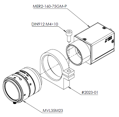

I will illustrate a common issue met with the process of Figure 1 with the camera sub-assembly of the OpenRAMAN spectrometer shown in Figure 2. It consists of a custom lens bracket, a COTS machine vision lens, some screws, and a camera.
Figure 2 – Camera sub-assembly of the OpenRAMAN spectrometer
The sub-assembly was made according to the traditional workflow that I presented here-above. At first, the system was designed such as to evaluate total cost. The budget was then discussed in the NPO for official approval, and, once approved, all parts were ordered. So far, so good.
The problem occurred when all the parts came in: the machine vision lens was not fitting in the bracket. After a few minutes of investigation, it came out that the lens housing diameter did not correspond to what was advertised in both the STEP file and the mechanical drawing. And it’s not that there was just a problem with the STEP and drawing because it was a time where the camera lens had these dimensions. However, the manufacturer updated the design at some point between 2019 and 2023 and did not reflect the change in the public documents. The part is then a different one although it is sold under the same part name/id. And we’re now stuck with a part that does not fit into the specially designed bracket.
The only solution at this stage is to rework the bracket or order a new part – and ordering a new part sets you back by about 6 weeks, not to mention the cost of the new part itself. And this can happen during the development phase and in the production phase as well. Imagine the development in Figure 2 went successfully and 6 months later I purchase 100 of these to discover that all the parts are now wrong!

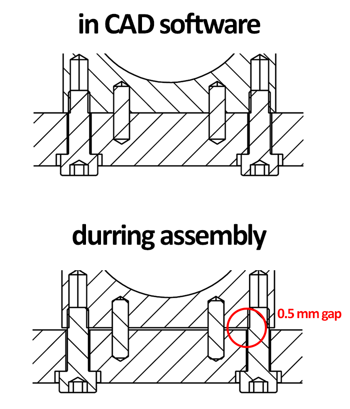

Also don’t limit yourself to big or expensive components, screws and pins can be wrong too! That’s something that I encountered a lot: DIN7 pins ordered with bevels are slightly longer than the unbeveled pins used in the CAD software library. If the pinhole doesn’t account for the extra bevel, you get two mechanical parts that will never get in contact with each other. This is represented in Figure 3.

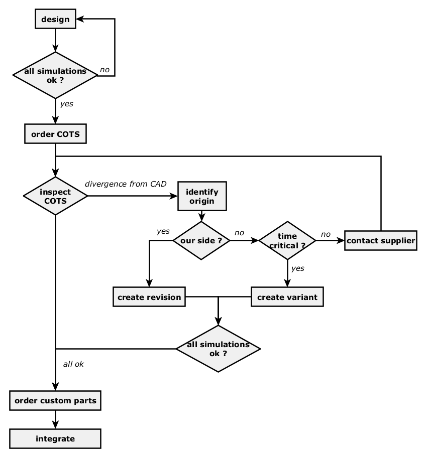

We can summarize this as the logical flowchart of Figure 4. Suppose you want to create the assembly of #2023-01/0 which has its own BOM of COTS and custom components. You would start first by purchasing all the COTS of the assembly and sub-assemblies. After reception, you would perform an inspection of all interfaces with custom parts. If for some of the components you see some discrepancy, evaluate if you need to return the part or perform a modification of the design. If you choose to perform a modification of the design, create a variant of the part that needs to be updated and of all the parent assemblies to accommodate for the change. Then place the order of the custom parts and log the complete assembly id, including variant, that was used to produce that batch.
